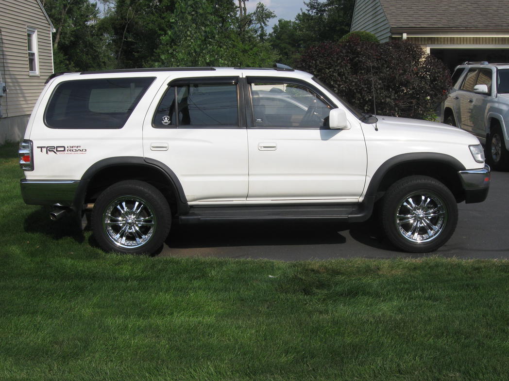

Go look at them and get under those trucks. You are going to see rust under these trucks. My 97 that I bought new has some surface rust on the rear axle, but still solid as a rock. This is with washing the truck every weekend and painting the bottom of the under side almost every year living her in CT.

This is what my 97 looks like today.
