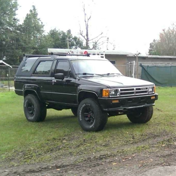

I was 17 when I bought my first vehicle, a 1988 Toyota 4Runner.
For $900, solid body, nearly perfect frame, 5 speed, no motor.

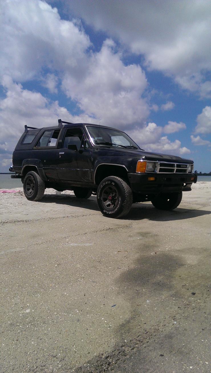

So, I decided to buy a second 1988 Toyota 4Runner; that ran.
I picked it up for $1700. The body was in okay shape, the interior was perfect, and the frame was pretty rotted.
I drove that one around for a few months. (Until I was ready to use it as my part's truck to get the other one on the road.)
Stock, automatic and a total piece of shit. I loved it.
(I will add an album for those two 88 4runners)

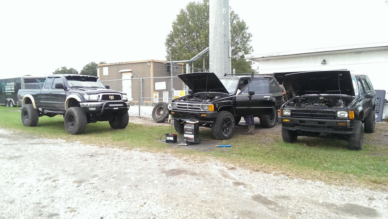

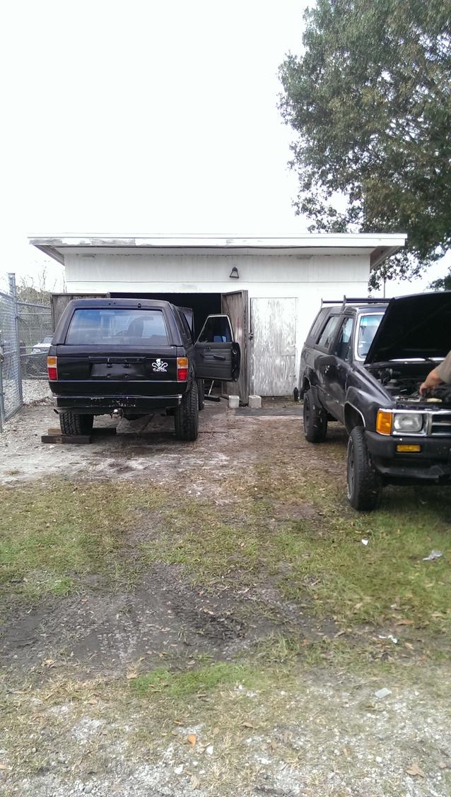

The motor in my parts truck finally started giving me major problems. So I knew it was time to get the other 4runner on the road.
Myself, my father, my father's bestfriend, my bestfriend, and my brother all spent a full week; 7 days, from dawn to dust swapping all the parts we could from my parts truck to my daily driver.
It was one hell of a week.
I replaced everything I could think of; axle bearings, wheel bearings, cv axles, a few ifs parts. Went through hell trying to get my back window to go back up.

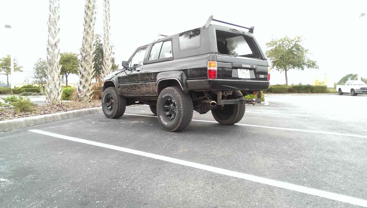

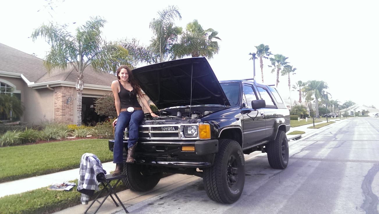

Finally after owning my very first 4Runner for almost two years. It was road ready. January of 2015.
I loved it. I loved everything about it.
I loved the way it rode, I loved the way it looked, I loved the way it sounded.
That truck was my everything. My dream truck.

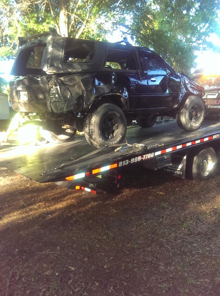

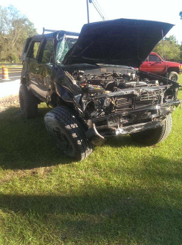

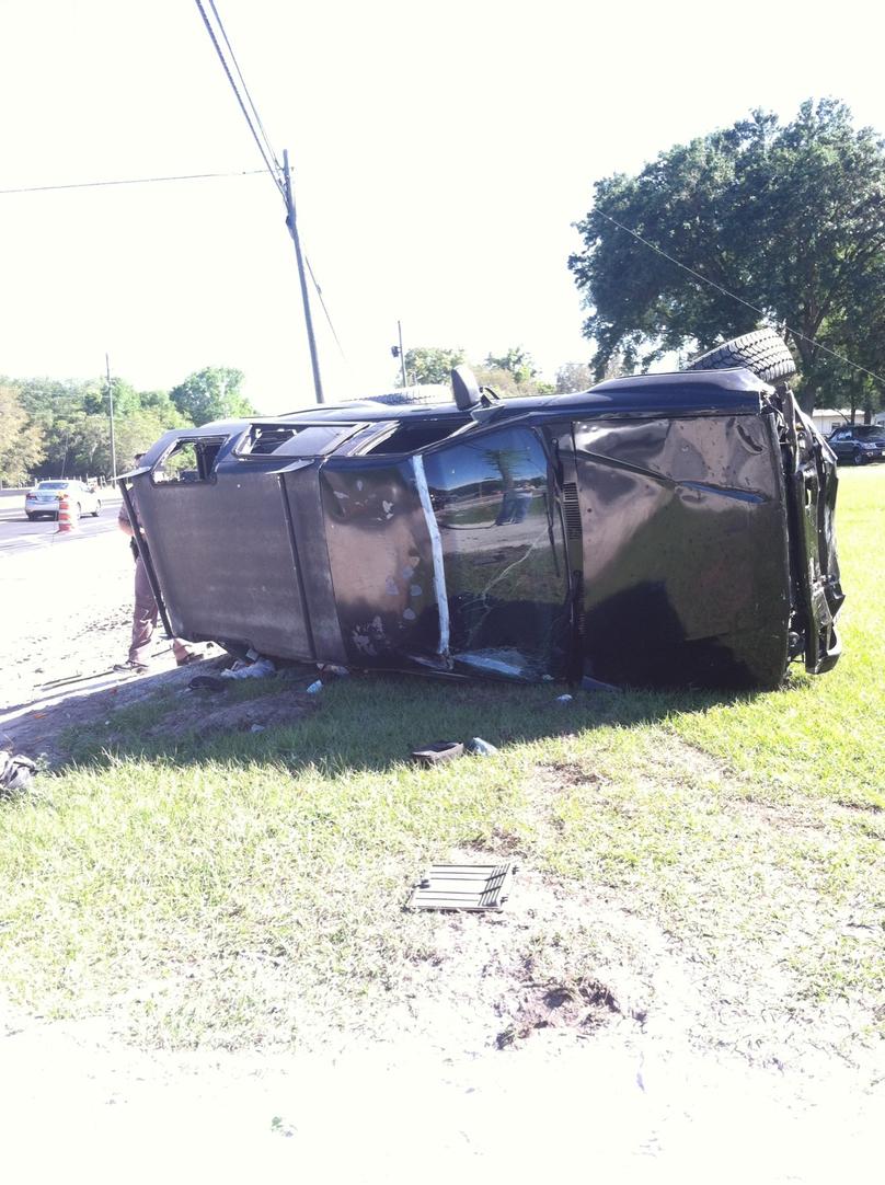

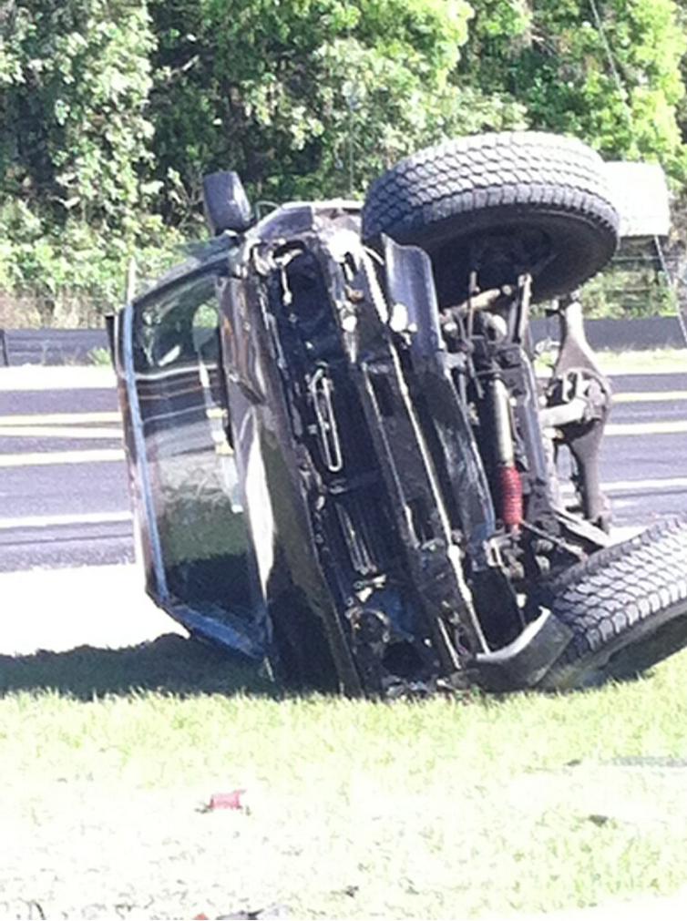

April 4th, 2015.
The most heartbreaking day of my life.
I went to a good friend's shop to check on my wheel bearings and help him prep a pickup to paint.
I was suppose to be dog sitting and I knew I was cutting close to when I had to be there.
So, at 4:30, I left the shop. 30 Seconds of driving, and then someone pulled out in front of me.
They hit my rear tire so hard it broke the block lift I had in the back, causing my rear axle to shift. And I lost control.
My truck went into a ditch, through a fence, took down a telephone pole, flipped, then landed on it's side.
I remember closing my eyes at the site of the fence, knowing I was going to go through. And when I opened my eyes, I was hanging by my seatbelt, staring at my passenger window.

Sorry you were in an accident, but for some reason this has me a little confused:
They pulled out in front of you, they how did they hit your rear tire?
I think she swerved to avoid head-on impact and was hit on the side.
Sorry about your runner Tori, especially after all that hard work. Glad you are OK though, it could have been worse.
Yeah, as soon as I saw him turning into my lane I instantly swerved to avoid him and he got my back tire. My truck literally drove over the guys car but I guess the impact was too much and broke my block.
After the accident, I thought about turning the 4runner into a beater, but I didn't' have the heart or motivation.

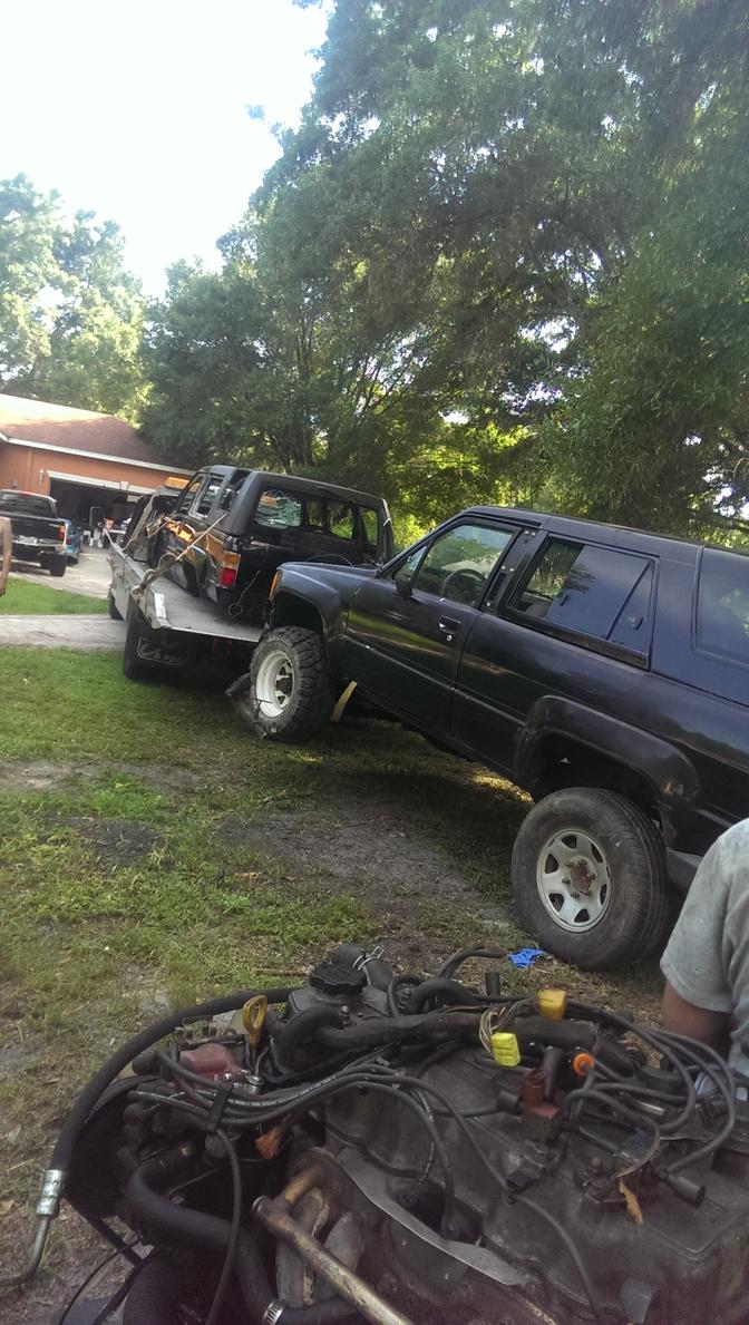

In the meantime, I had plans to part out both 4runners to make some money for a new one, but a friend asked to do a trade.
(1983 Pickup for my parts truck. Plus the body off the rolled 4runner for spare parts for the pickup)
I said yes.
We loaded up both 4runners and bye they went.

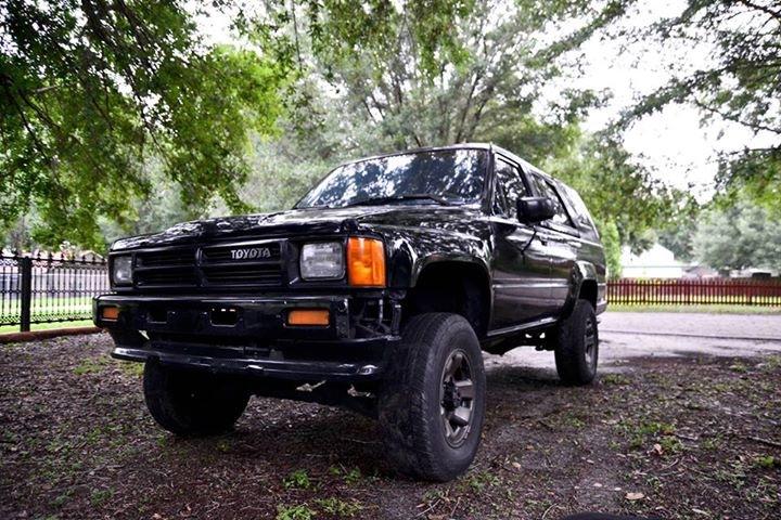

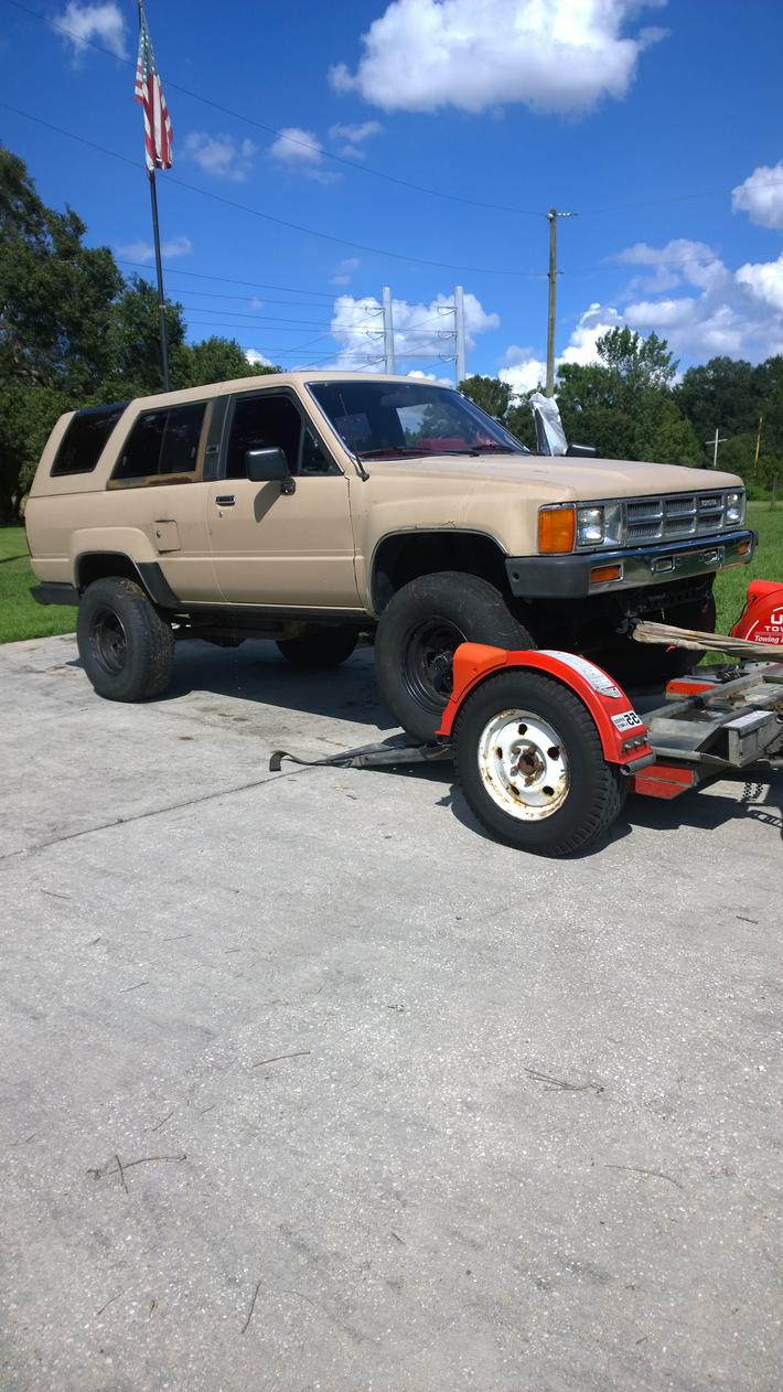

For those wondering. This is what the new 4runner looks like. I will add more pics, of the interior and all around soon.
that 4Runner looks like a good score for a grand
just out of curiosity did you pull the rear drive shaft when you towed with the tow dolley?
you are probably fine if not but just a heads up for future reference the output bearings on Toyota transfer cases don't get properly lubed if flat towed (per Marlin of Marlin Crawler)
I found this out too late after flat towing my 84 across country. 300 miles after staring to drive it again I replaced the transfer case.
than 20 years later i brain cramped it again and didn't pull the rear d/s when pulling my 81 trekker, it slipped into gear and destroyed the t/c and transmission.

No I didn't. I just put it in neutral, both tranny and tcase.
I used to tow my black 4runner like that a lot and never had any issues.
But I also never towed it for more than an hour at a time.

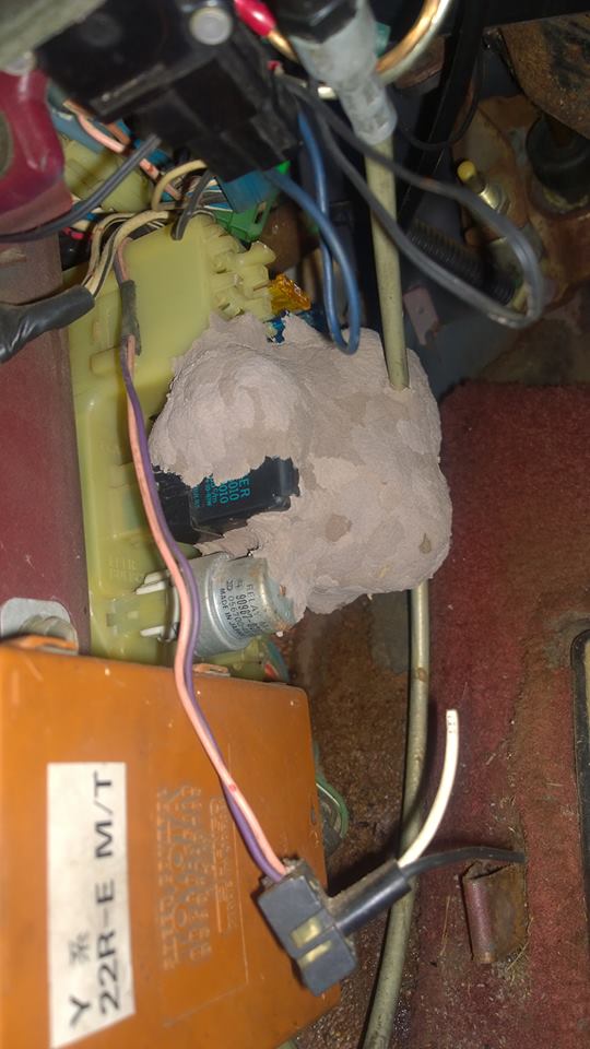

I looked around at the fuses, and found a HUGE mud dauber nest on the fuse box on the driverside.
(Checked the fuses, all are good)

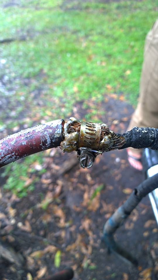

Then went to the battery cables. Replaced the ground cables with some from my old runner.
Checked the cable from the positive terminal to the starter... It was a nightmare.
Replaced that.

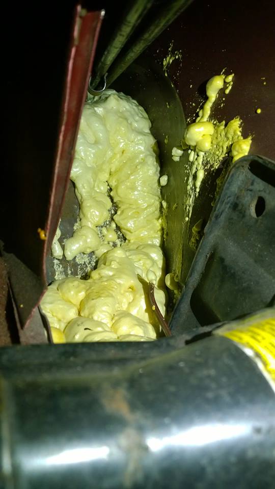

Oh, and I crawled into the back to see if I could get the back window down, and found insulation in the rear panel. Oh yay.
