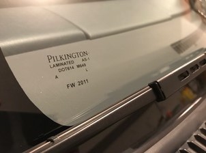

I hate to be the bearer of bad news, and but mine says Pilkington on the lower passenger side corner. Mine was replaced in 2011, so maybe Pilkington changed where they label... trying to be positive. It's been great glass - still crystal clear and smooth sans one small rock chip.

I did some research:
The DOT numbers will give you the exact manufacturer and country of origin. Here are the codes:
DOT number search: DOT Number Database
Top brands are:
- my favorite, Pilkington, which invented float glass and bought top US maker Libby-Owens-Ford. They are OEM for BMW and many others
-SGS Saint-Gobain-Sekurit OEM for Mercedes and lots of Euro cars
-Carlite OEM for Ford
-AP Tech OEM for Honda and others
Brands to avoid are PGW, Safelite and XYG (really bad). Off brands will break more easily and frequently will have distortions or blemishes. There is a lot of cheapo no-name Mexican and Chinese glass out there, although not ALL Mexican glass is crappy; it depends on the manufacturer. I don't know of any Chinese with a good reputation.
PPG used to be good, but then the windshield biz, known as PGW (Pittsburgh Glass Works) got sold to LKQ Corp. in early 2016 and apparently quality went downhill.

@thedirk thank you! according to your chart I have a genuine DOT563 SHENZHEN AUTOMOTIVE GLASS MANUFACTURING P.R.O.C., CHINA
The install shop will be getting a call from me.
