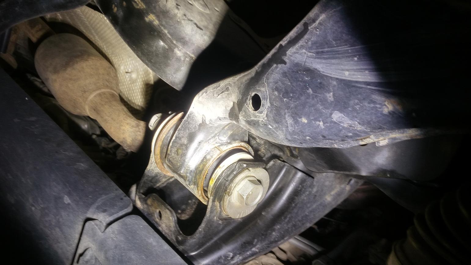

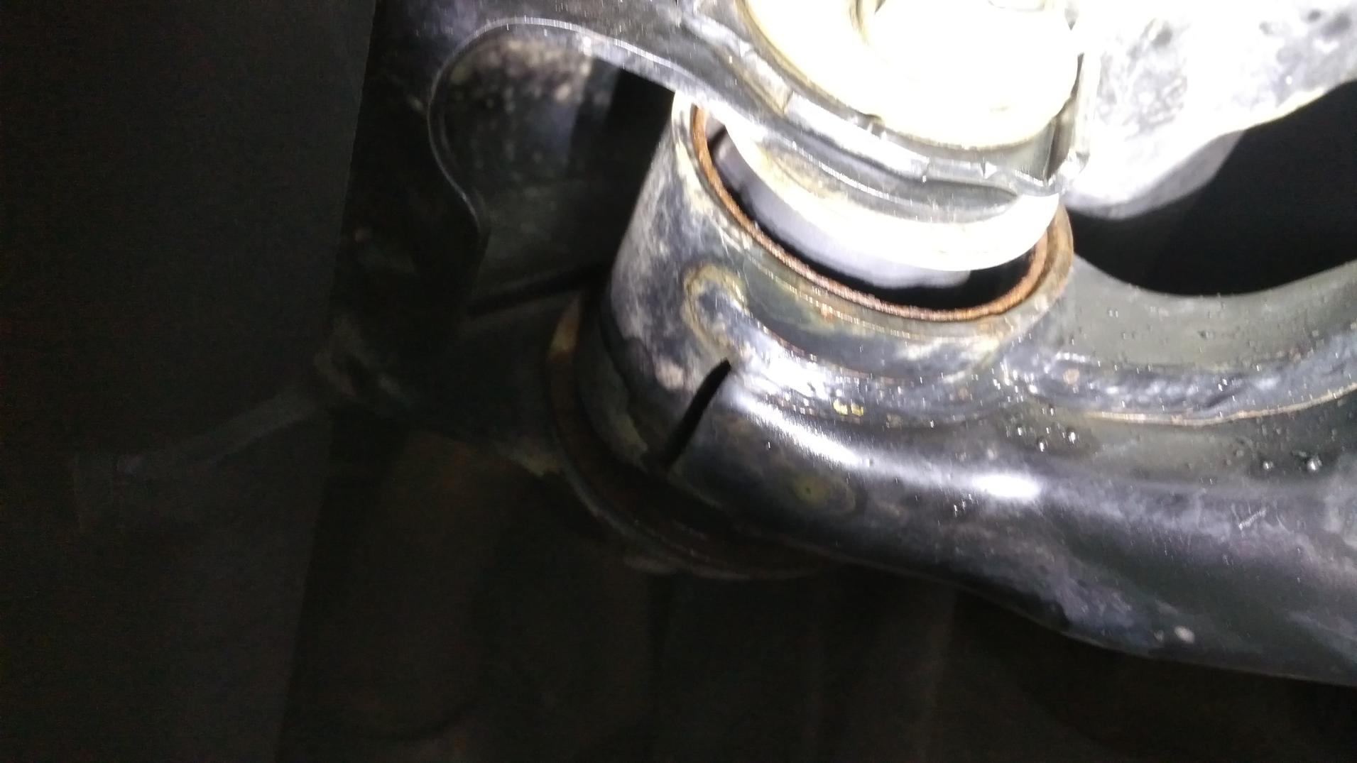

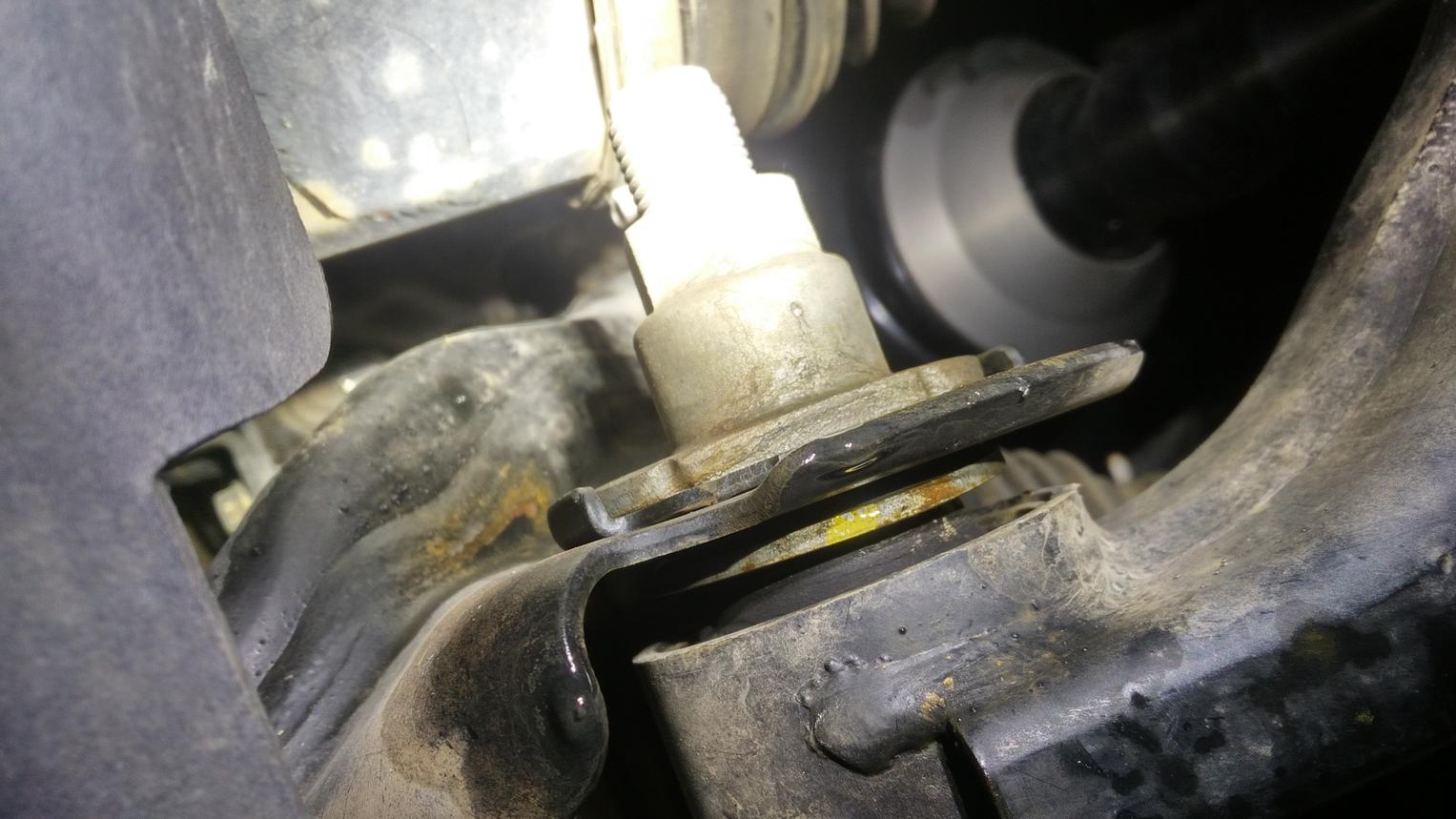

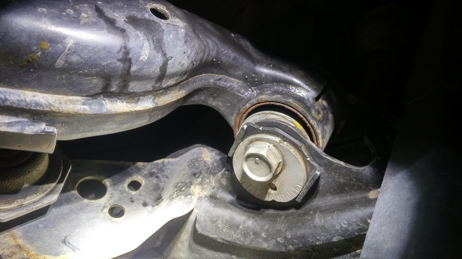

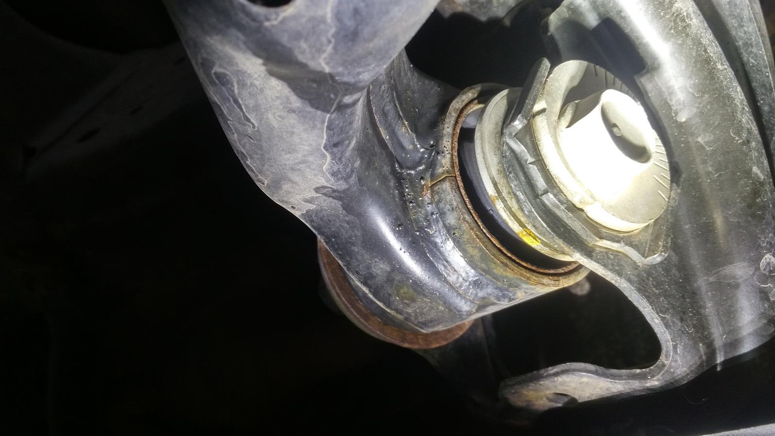

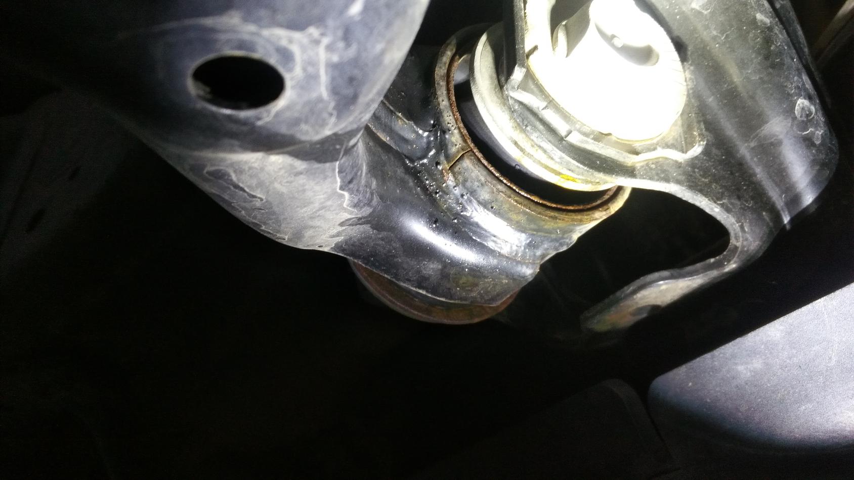

Sup gang, havent been around much, decided to lube up the front end and saw this.
Does this look right? Did I trash my lower control arms?
If they are trashed, do you recommend replacing with stock or replace with aftermarket like total chaos lower control arms.
Thanks!

Depends, do you need an excuse to tell the wifey you need new lower controls arms? Else from what I see, no. Some rust on the outside of the inner sleeve? I don't see anything bent or tweaked. Am I missing something?
that space is very typical of OEM injection molded bushings.
you could press/burn those out and install some delrin/polyurathane shouldered bushings and it'd tighten the front end up quite a bit.
but yea, that all looks normal.
