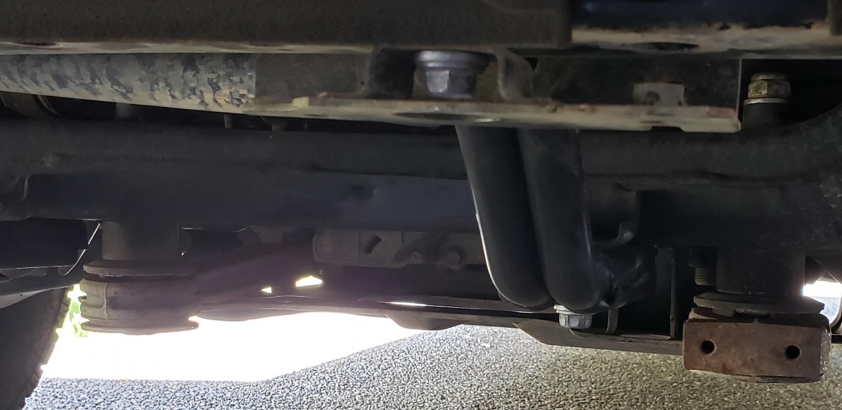

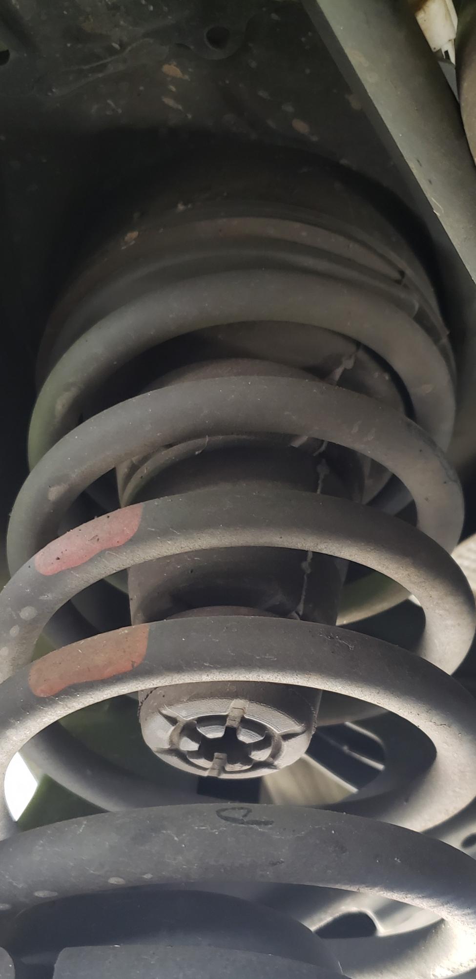

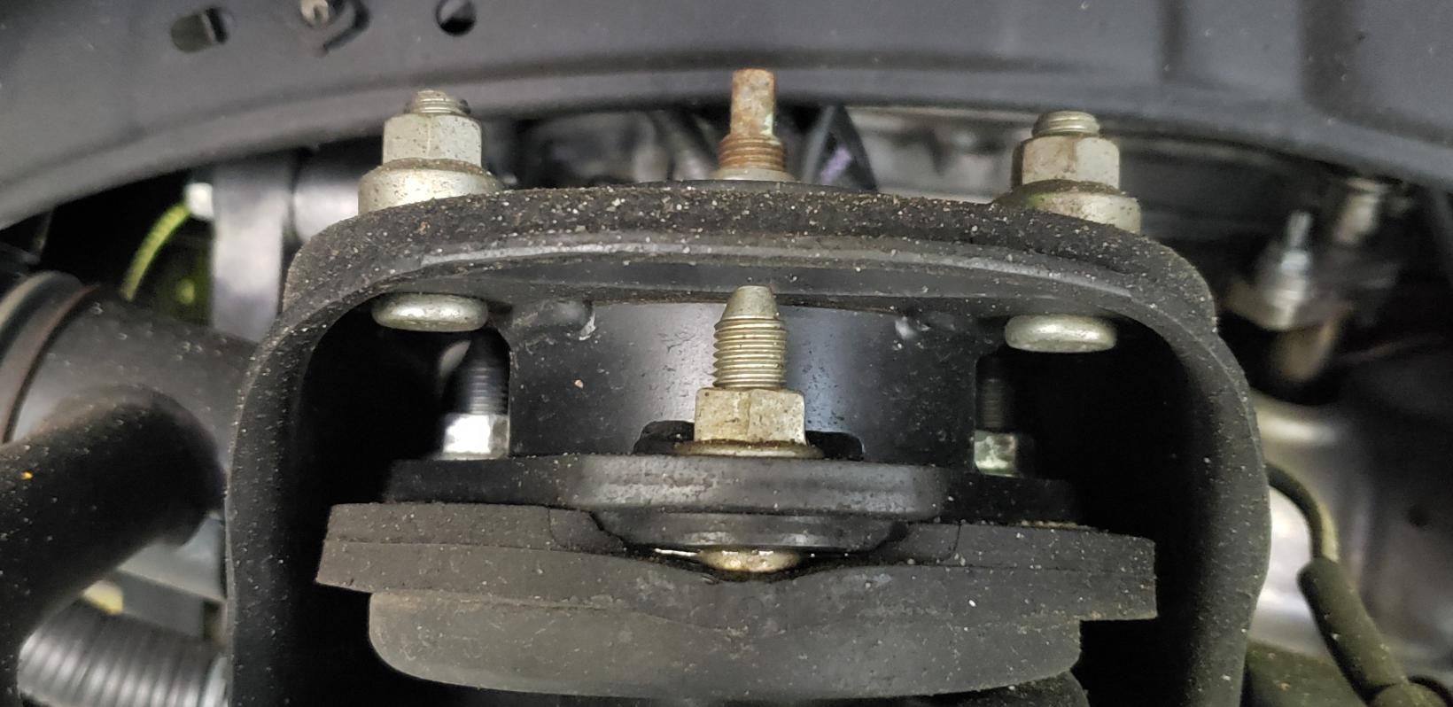

This is what I'm working with. The front is 1.5" as measured with my machinist's scale. I know discerning a brand will most likely be impossible and is irrelevant anyway. I would like to know if the rear is lifted or stock height and that's just the factory rubber insulator above the spring.
Additionally, are the tube braces that run fore and aft from the core support to the axle really necessary? I've seen some rigs with them removed permanently.
