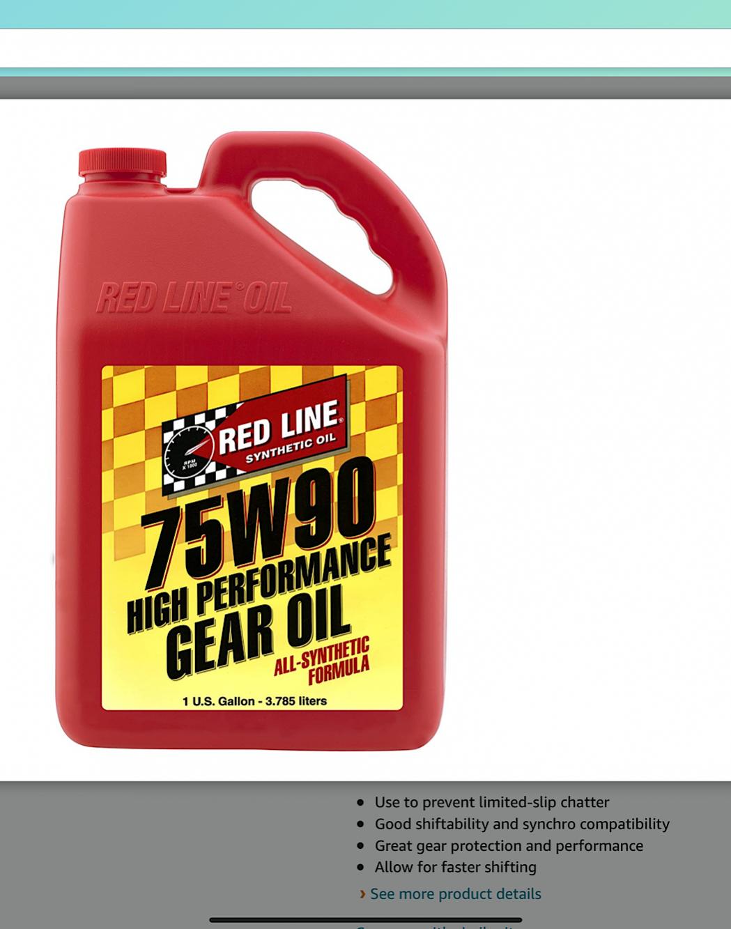

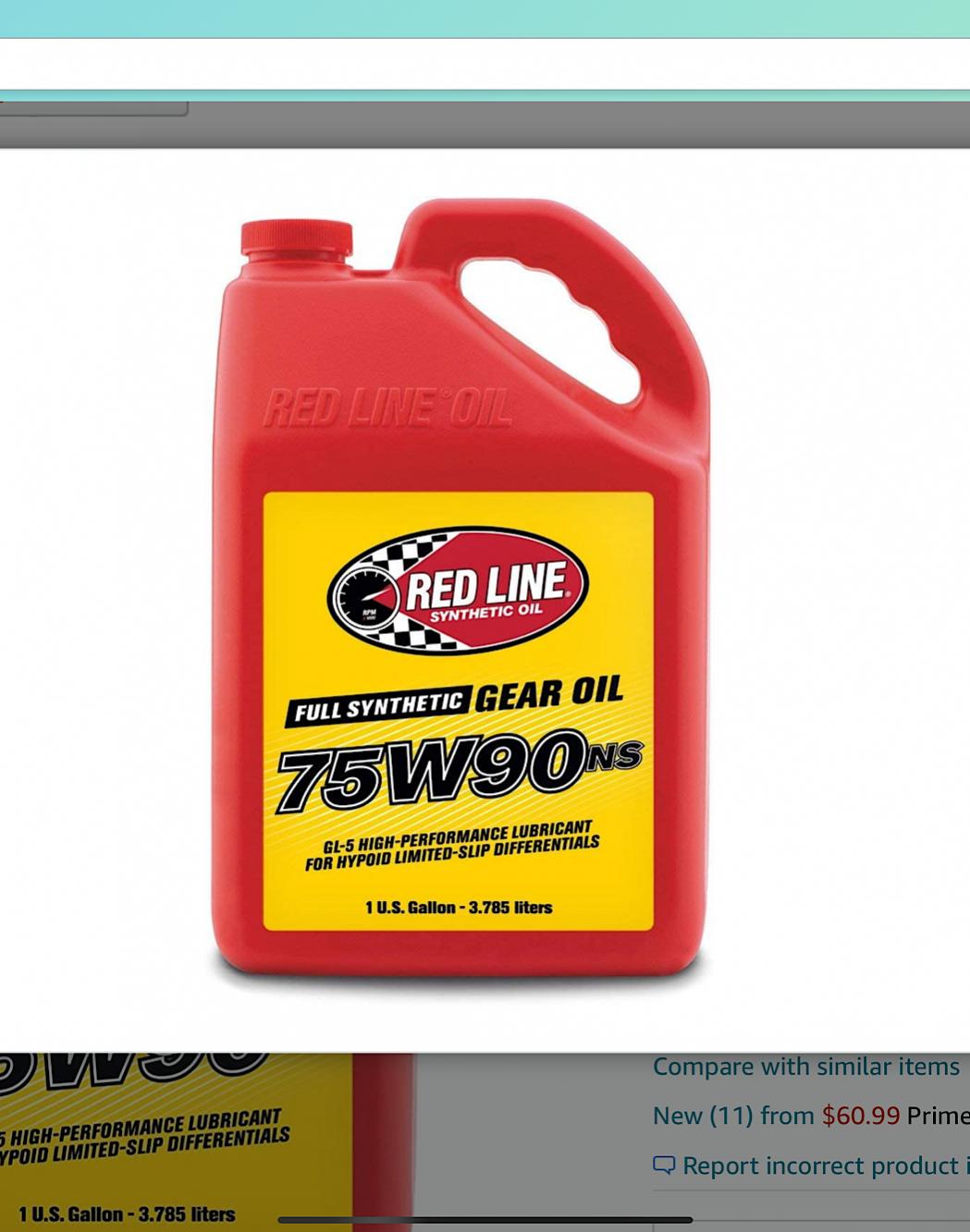

Which one would you use between these two

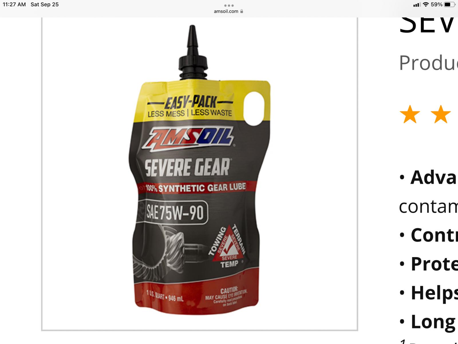

Redline is a fantastic product and highly recommend but I like the easy bags that Amsoil has. No need to pump the oil into the diff or transfer case using a hand pump. With the bag you just squeeze the fluid in and your done. Both are fantastic gear oils.
