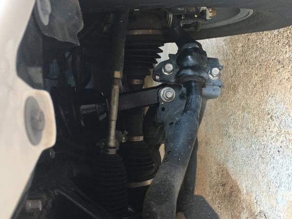

Finally got the lift done today.
Rears are at 24” hub to fender and fronts are 22”. No diff drop and my CV angles look ok to me.
