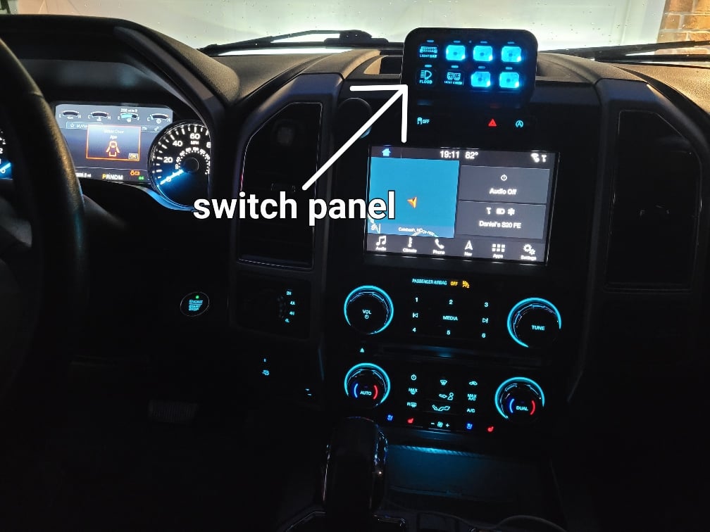

I just did a full install on a Auxbeam switch panel on my F150. Other than running the wire to the switch panel through the firewall, its all the same. I will email you the PDFI created for it. If you PM me. Its to large a file one to upload. A switch panel install for the 4runner is definitely on my to-do list. Hope to help. I also have a vdeo on my channel going over the features of that panel.

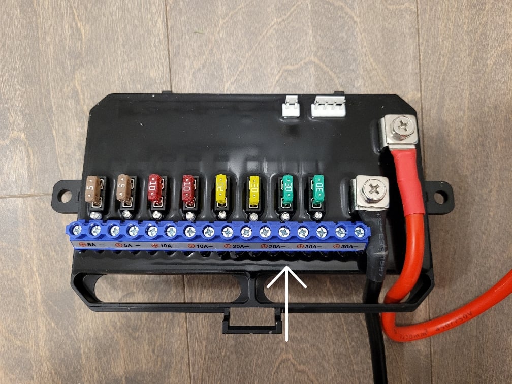

This is what mine are hooked too...the fuse box that comes with the Auxbeam has built in relays and of course you have the 60amp breaker running to the battery. The accessories themselves run to the + and - within that fuse panel box and correspond to the switch on the panel inside the truck.
There is only one wire from that fuse panel box (mounted in the engine bay area) that runs into the the cab through the firewall to the actual Auxbeam switch panel, that powers and is used to control the accessories...
