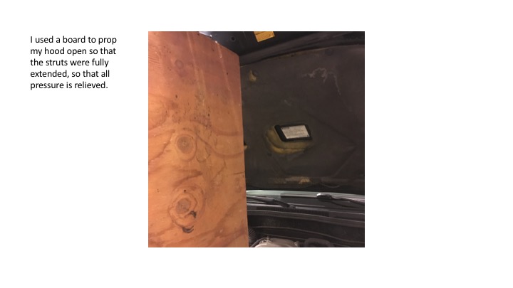

Hood no longer stayed open. Time to replace the hood struts.
