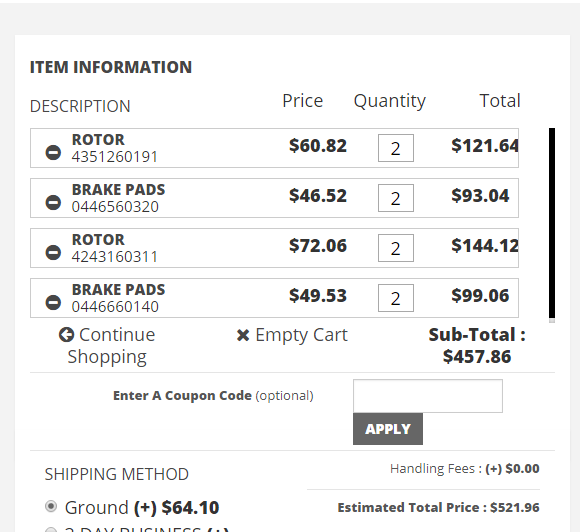

How much are new rotors? Turning rotors makes less and less sense to me. If I’m going to go through the inconvenience and cost to do pass and turn rotors, why not just throw new rotors on instead
This is the option I always take tbh. Good rotors are not that expensive.
Looks like $260 ish + shipping for new OEM rotors.
Is that normal to need to replace rotors at ~65k miles? Seems like they would last longer than that.

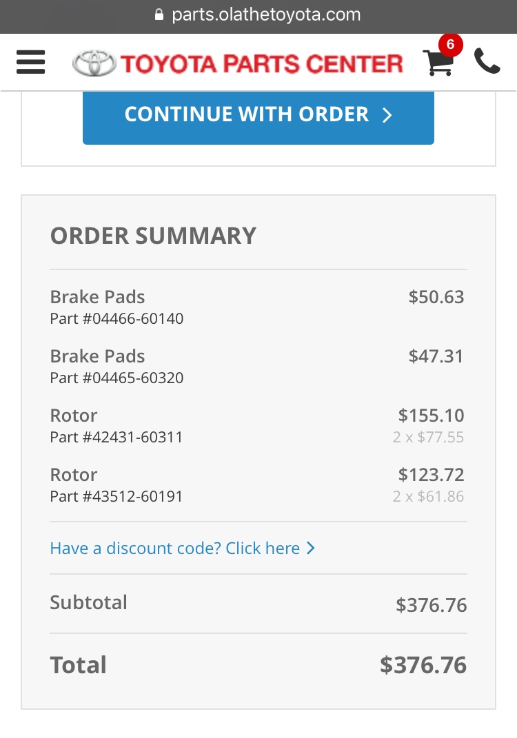

Uhm... That is more than new rotors and pads cost... I think we had $160 total in top tier pads and rotors on my neighbors 2016.
Add another $65 for shipping and you’re at $440 for just materials. No labor. I’m confused??
Are you saying you bought new OEM pads and rotors (front/rear) for $160?
