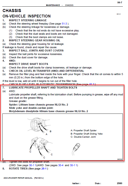

Yes, I've been on this forum for years and have read the threads. Looking at my post above, I regret not being more clear. I should have said, "I would like to know from a definitive source the why behind the two-types specification..." Like a Toyota document or manual, something from a grease manufacturer, etc. That's not a swipe at anyone who has provided their take on the grease question and I appreciate you tracking down the info you shared.
Obviously any grease is better than none and perhaps Toyota's spec represents the ideal vs. good enough. In the end, this is probably like the oil debate, the truck doesn't care as long as the parts don't grind and we owners are the only ones obsessing about it.
This doesn't answer your question as for the "why" part, but as a starting point for research, it does verify exactly what Toyota recommends in case someone with more brain horsepower than I wants to look into this.
