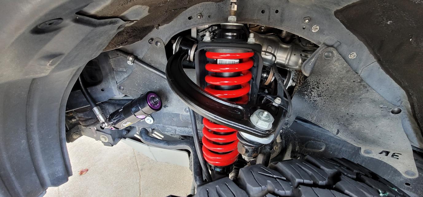

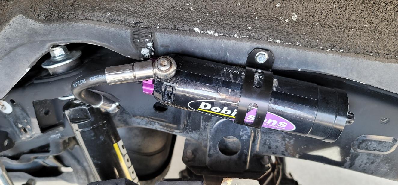

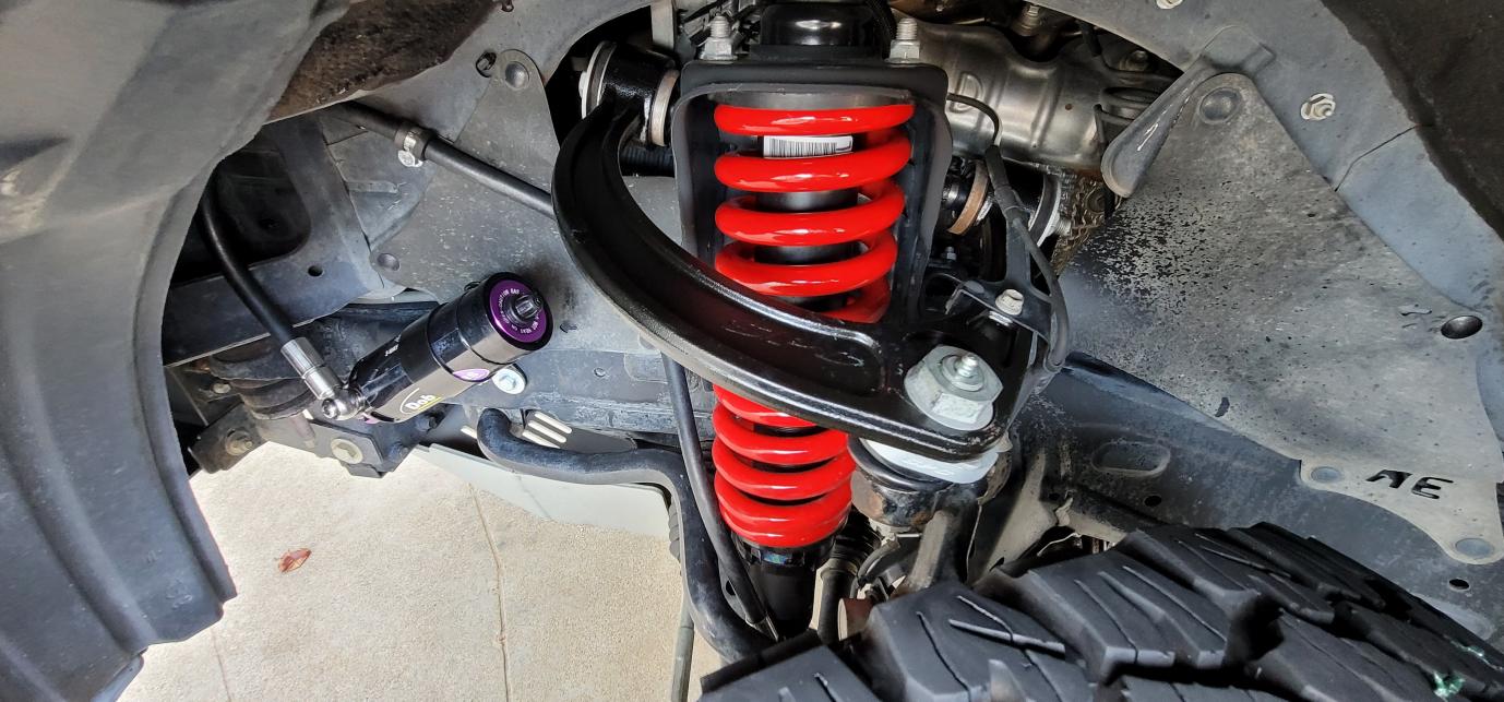

For people in the future that need it also... Here are a few pictures of my buddy's resi locations
Front:
Rear:
Front:
The way those fronts resi's are installed, they're extremely likely to get hit with the UCA on full up travel. It's not recommended to be mounted there for that reason, plus you're limiting/blocking access to adjust the rebound adjuster on the top of the strut.
The resi needs to be forward or rearward of the strut tower, out of the way of all moving parts (like the UCA's) and the tires that can turn in towards it.
https://exitoffroad.com/wp-content/...MRA59-A574-Vehicle-Specific-Fitting-Guide.pdf
I suggest you do a full suspension travel test and check it out. IF that resi gets loose, you could destroy it, and the hose, and if that happens, you'll need a full dismantle of them to clean and replace the oil and parts that got damaged.

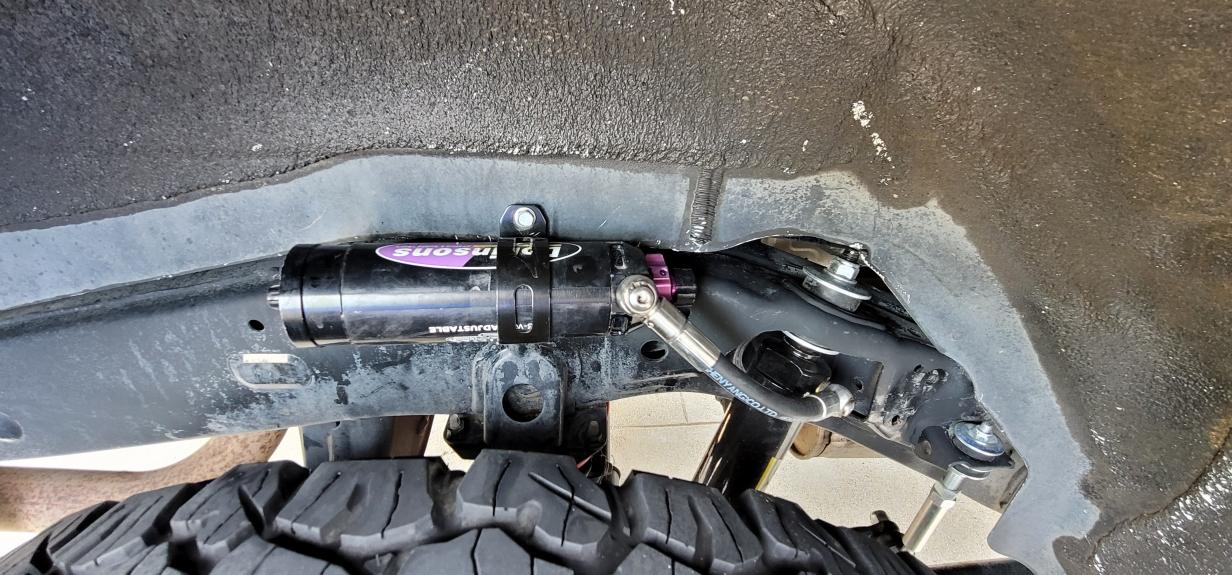

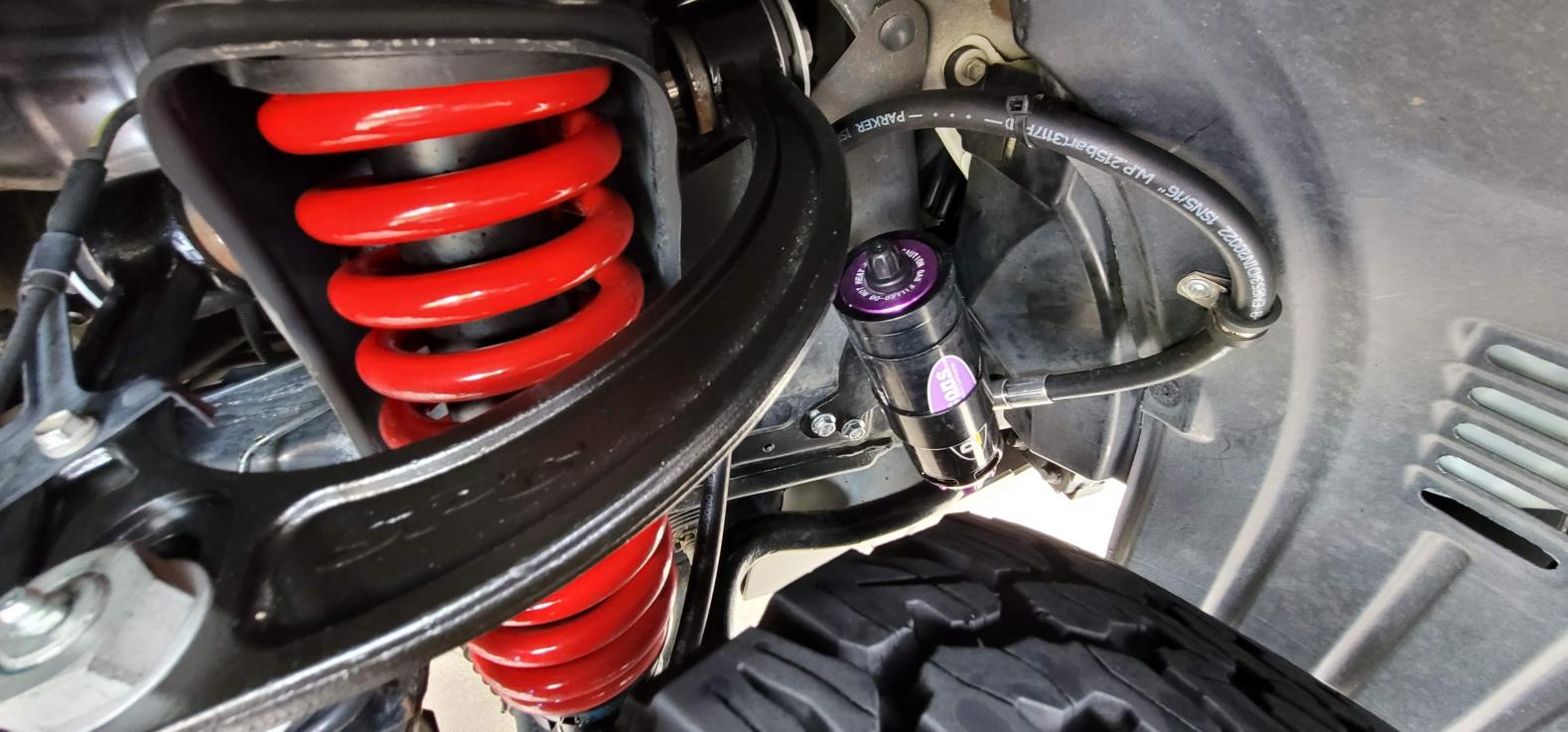

Here is mine on 2017 TRD Pro
Damping control settings are awesome, Settings are preferred how you like your ride quality to be. I'm 4+ clicks Positive and love it there. about 400+ miles on this suspension now ( went snow wheeling and mild off-road ) not a single issue in rubbing

I really like your front resi mounting position. Did you use existing holes or did you have to drill holes in the frame? How about the rears? from what I can tell, those are not pre-existing holes.
Appreciate you sending pics!
the front went into existing holes and rear one existing and one I drilled a hole and added rivnut

Hey TaNk007
How is that rear mounting location doing for ya? No problems with tires rubbing it? My bro has the Fox 2.5 dsc and the resis are sorta in the same place... maybe sticks out a little further from the frame and further back and his tire rubs when the tire is stuffed. Yours looks like it would be ok.
I finally got my rear springs this week and got to installing the rear setup tonight. The pass side supplied mounting worked like a charm but the driver side sucks balls. The pictures on Exit and Dob page are nothing like the 4th gen... at least for my 4th gen. The existing holes in the frame with the mount cause the resi to hit a bracket on the frame and the gas tank. If you push it back the resi goes into the spring. I've been trying to tweak it by drilling new holes but gave up for tonight.
I like how you mounted them. Might got that route.

Hey, no rubbing issues I went to 285 and it still clears fine
