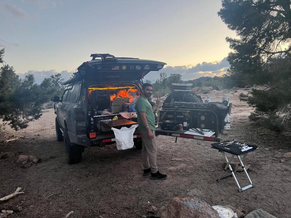

Pic1: my buddy testing out the equipment by making breakfast: sausage, eggs, toast, and coffee after driving all night long from san diego to alabama hills. With this setup, everything is within easy reach without moving his around to much (fridge, drawer contents to his right side, food prep surface in front of him, and a single burner and knock off jetboil behind him).

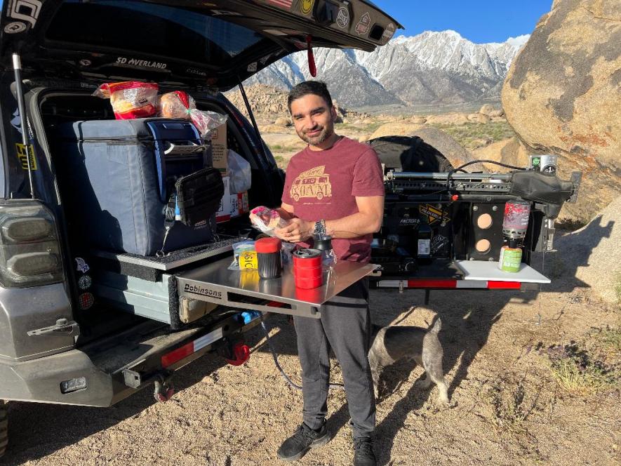

Pic2: using the entire setup to make lamb chops for dinner. You can see how a grocery bag mounts at the end of the table for really easy cleanup.
