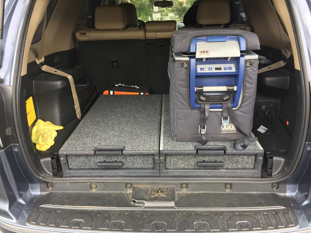

I just put in two rf945 in my trunk. I removed the third rows and put it on plywood. I've only had them for a few weeks, and I wish I went with the taller ones.
The rd945 will fit, if you snug them closest to the rear lift gateyou only lose about an 1inch on the reclining seats.
The roller floor (rf945) let’s you keep the full recline but only holds hand tools and small items no taller than 2.5 inches
