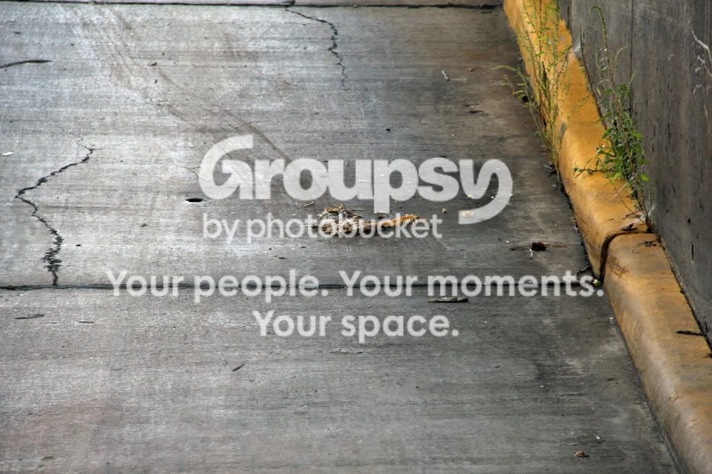

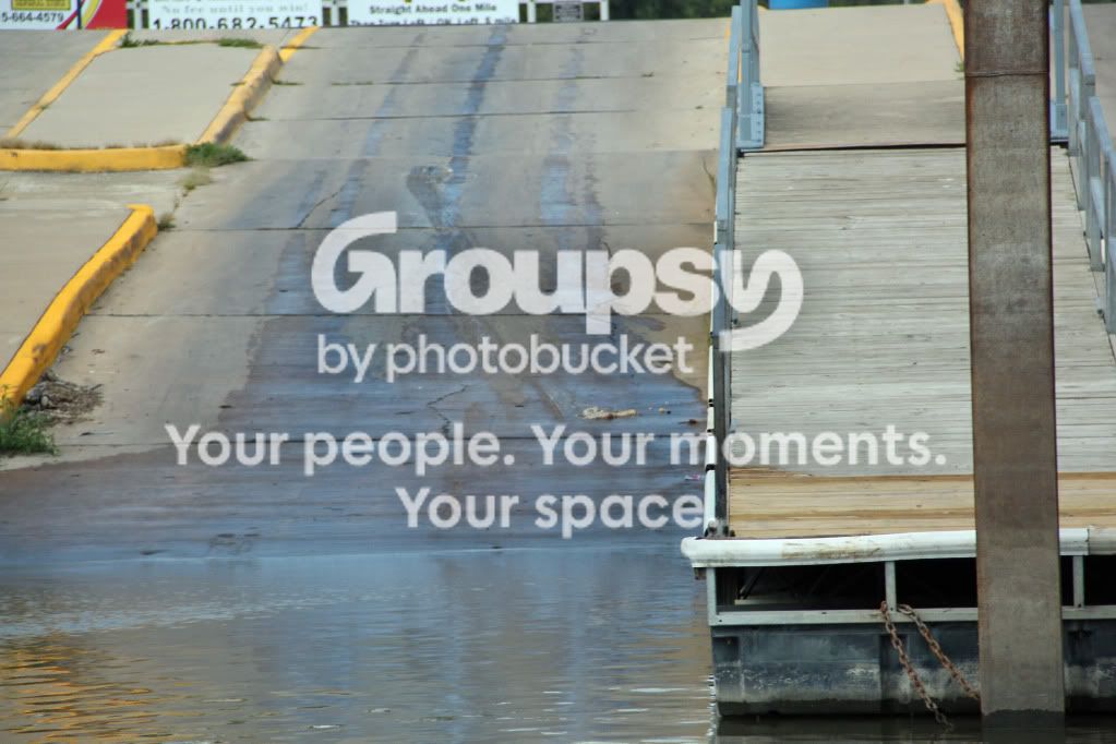

Here is the story: I was backing down the boat launch ramp with my foot on the brake, gently rolling down. There was a dead fish on the ramp, but instead of just rolling over it, it got caught under my front right tire. I dragged the fish for about 20 feet before I stopped to launch the boat. The front right tire did not turn once the fish was under it, it just skidded the rest of the way down. Nothing beeped and no "Toyota Dubstep" (that's what I call the sound that the abs/dac/atrac makes). The other three wheels were spinning, center diff unlocked, and in 4HI (normal for a Limited).
Point of the story: Should the system have been working or does it disengage when in reverse?
