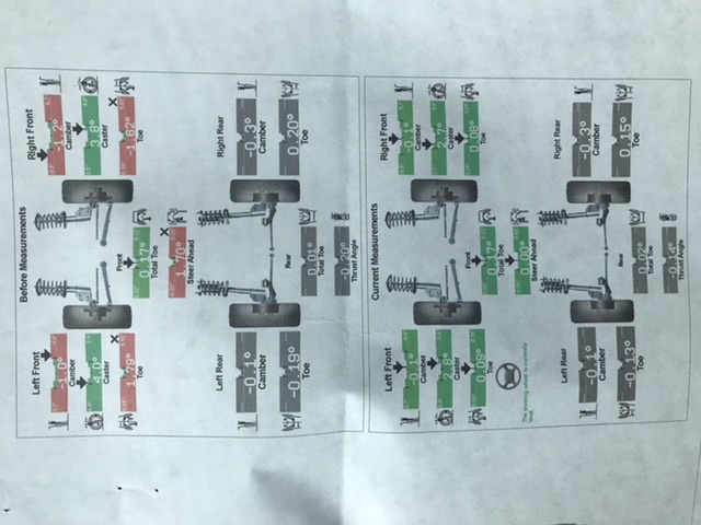

Just installed Icon 2.5 Front Coilivers w/ RR & CDCV, Icon 2.5 Rear Shocks w / RR & CDCV along with SPC Upper Control Arms. Just got it out of alignment shop. And because I know absolutely nothing about alignment, I’m want you guy’s opinion on my results.
Looks good to me...how's it driving?
Drives great. Just didn't know if more caster is needed or anything. I don't know jack about alignment. Installed the suspension myself. Took me two days and a bottle of Aleve for my back, but I got it in. Got the CDCV set at the softest setting for now. Gonna give suspension time to settle and may crank the front up a little more. It has a little bit of forward rake right now with the bigger overlander springs, but plan on installing a Victory 4x4 rear Strike bumper w/ swingouts in the next 30-60 days so my wait for final height adjustment until then.
I feel like you should have more Caster.
That's what I was thinking but it drives great. I got the Firestone Lifetime Alignment, so I can always have it redone. Running stock tire size at the moment. 285/70/17 General Grabber ATXs going on in two weeks.

I am not familiar with SPC UCA, but your Caster is low . Try to get it to 3.9 or 4.1 . I am sure you will be good to go for 285’s. Good luck
I was just looking at my alignment spec sheet. And I will not claim to no jack $hit about alignment, but from looking at my before measurements, my left caster is at 4.0 and my right caster is at 3.8. It appears to me that the alignment dude *ucked it up by just adjusting the LCA cams to dial in the camber. I can say for a fact that he did not touch the UCA at all.

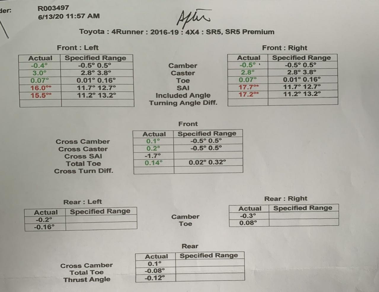

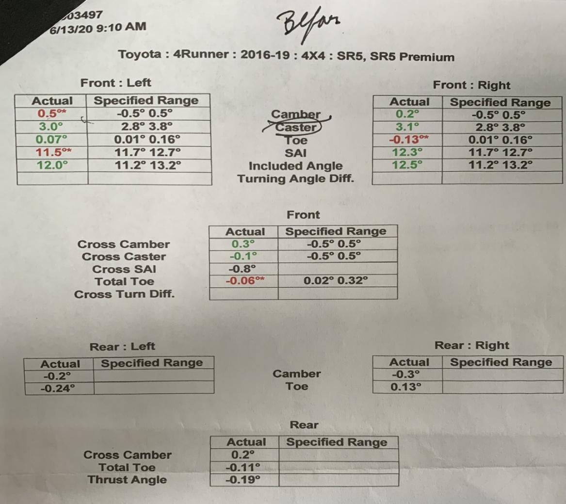

Installed Ironman Nitro lift (3”/2.5”) and Ironman UCA’s w/ 4* built in caster.
Went to local shop for alignment assuming it should be simple. Currently running stock wheels/tires with plans to size up to 285’s- requested caster above 4 to make space. Tech worked diligently for 2.5 hours but it was obvious he didn’t have experience. I should have asked about this before taking it in- my bad. End result is that all is in spec, but couldn’t get Caster above 3.0 on drivers side and 2.8 on passenger. It drives great, but could use some advise. Should I find a more experienced shop before buying new tires or am I being OCD that my Caster is in the low end of spec?
Before and After alignment specs below.

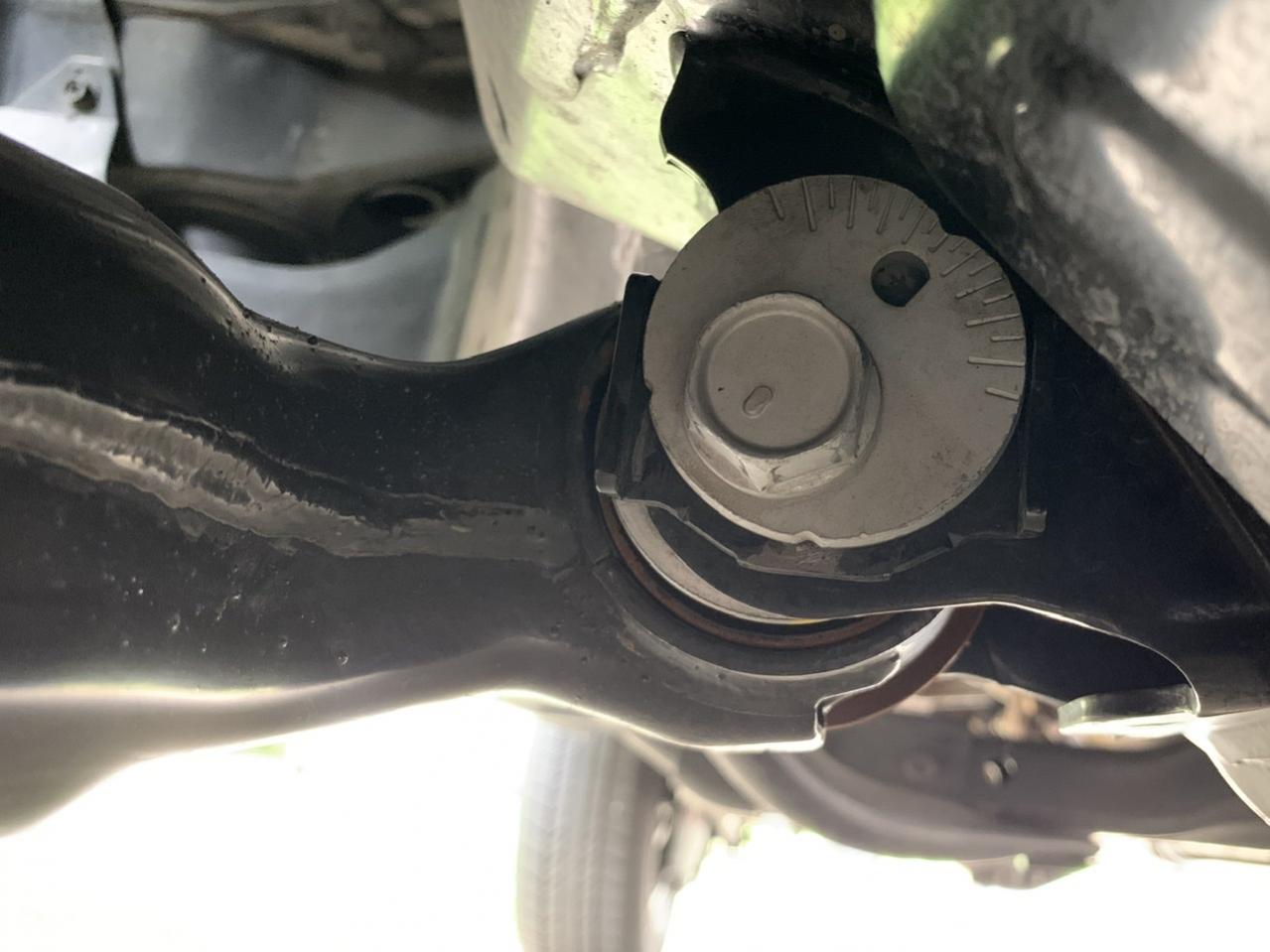

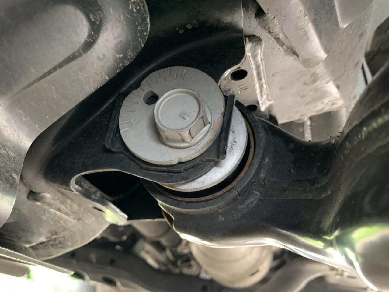

Does it look like the LCA cam was even adjusted or is it still in the neutral position?
I see signs of adjustment but don’t know how to read what was done.
