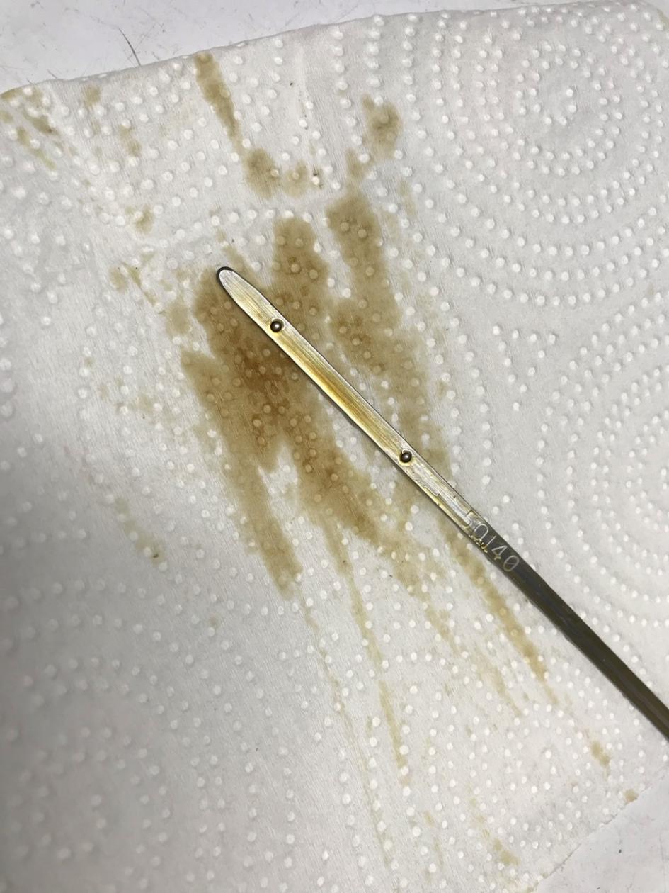

Here is my oil after exactly 3,202 miles since its last change back in July with SuperTech 0W-20. Still looks pretty clean to me.
Edit: also forgot to mention that my rig has over 94K miles.
