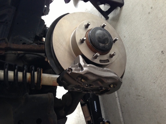

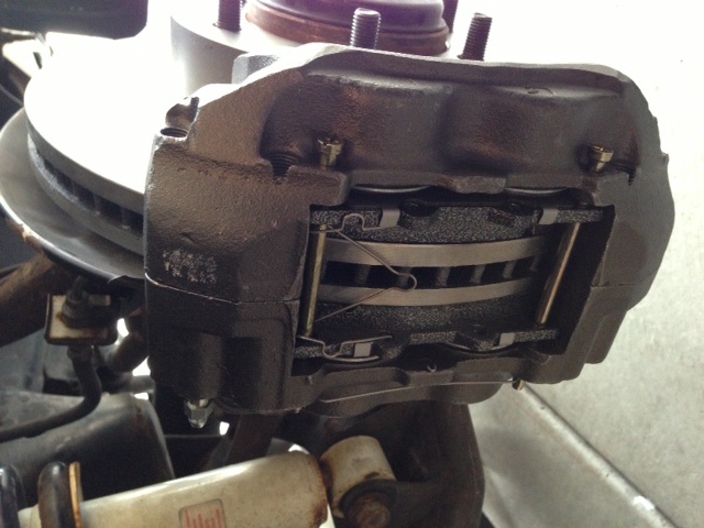

Finally got a chance to get the brake job done! It went pretty well, although one of the calipers had some extra material/flashing around the brake pad area and I couldn't get the pad to slide in. Replaced it with another caliper and it was fine. And for some reason, it took me awhile to get the rotor on the passenger side to sit true on the hub and rotate evenly (that one took awhile to figure out what the heck was going on...)
I also found a broken bolt on the brake line bracket nearest to the wheel, so it took me awhile to drill that out and replace it.
The 199mm calipers were a direct bolt-on, no cutting of the dust shield was necessary. Had some minor rubbing between the rotor and dust shield, but a couple of minutes with the Demel fixed that. The stock split 3-spoke wheels fit fine.
First-time brake job for me - thanks to everyone on this forum for their excellent write-ups and expertise! Now I just gotta figure out a time and place where I can go drive it and do the bedding-in procedure!
