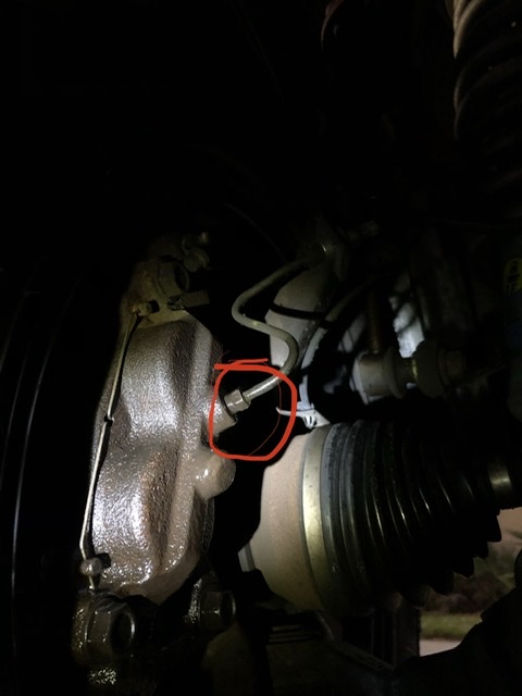

Just today noticed a few things going on with my brakes, sitting at a stoplight with constant pressure from me onto my brake pedal I would catch myself rolling forward and have to push the brakes harder to stop again, it’s gotten to the point today already that I put the vehicle in park at stop lights. As I started paying more attention, I noticed that I haven’t heard the electronic motor sound that usually comes on rather frequently At all today. And just now before getting on the interstate I noticed I could depress my brake pedal all the way to the floor with relatively little effort. No vibrating or shaking when braking but I think once , under longer braking it felt like the brakes were releasing a little bit and grabbimg again.
I have oem 5th gen Brake pads, centric 5th gen calipers and toytec stainless brake lines front and rear which were all installed by a Toyota dealership.
Any thoughts on what my issue could be?

Update: pulled off at a rest area, barely. There’s brake fluid all over my drivers wheel well and leaking from where the hard line connects to the caliper. Currently waiting on a tow truck. No warning lights what so ever came on to signal any issue
Thanks for the update.
Sounds like the dealer botched the install on your SS braided lines or did the problem appear out of the blue?
This is the area where the brake is leaking- the hard line connection to the caliper itself and it’s only the front driver side
Easy fix if you have tools and a little ability, you just need to replace the hard line from the caliper to the steering arm and then bleed that caliper, you need to get a 8" hard line with Japanese fittings from the parts store, more brake fluid and line wrenches, the hardest part will be gently bending the new line to shape without kinking it, I had the same issue and had it fix within 30 minutes, cost less than $25. most of that was 2 quarts of brake fluid and I still have one of the quarts I never opened.
