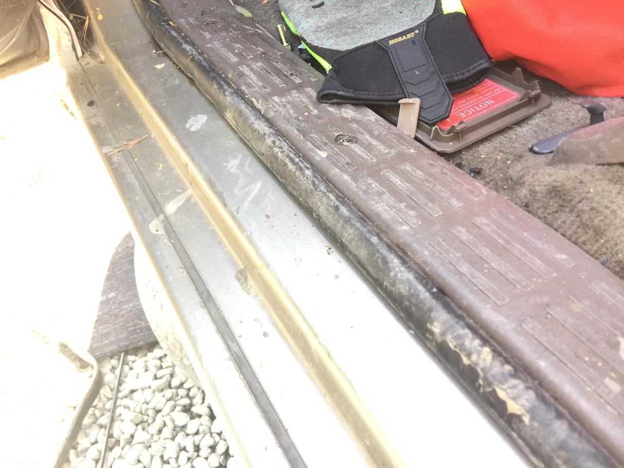

IF anyone here has had their drivers side weather seal tear from your feet rubbing on it as you hop into your rig over the years I have one I'll sell...
HERE is an example of the torn worn out seal. The one I have is NOT torn...

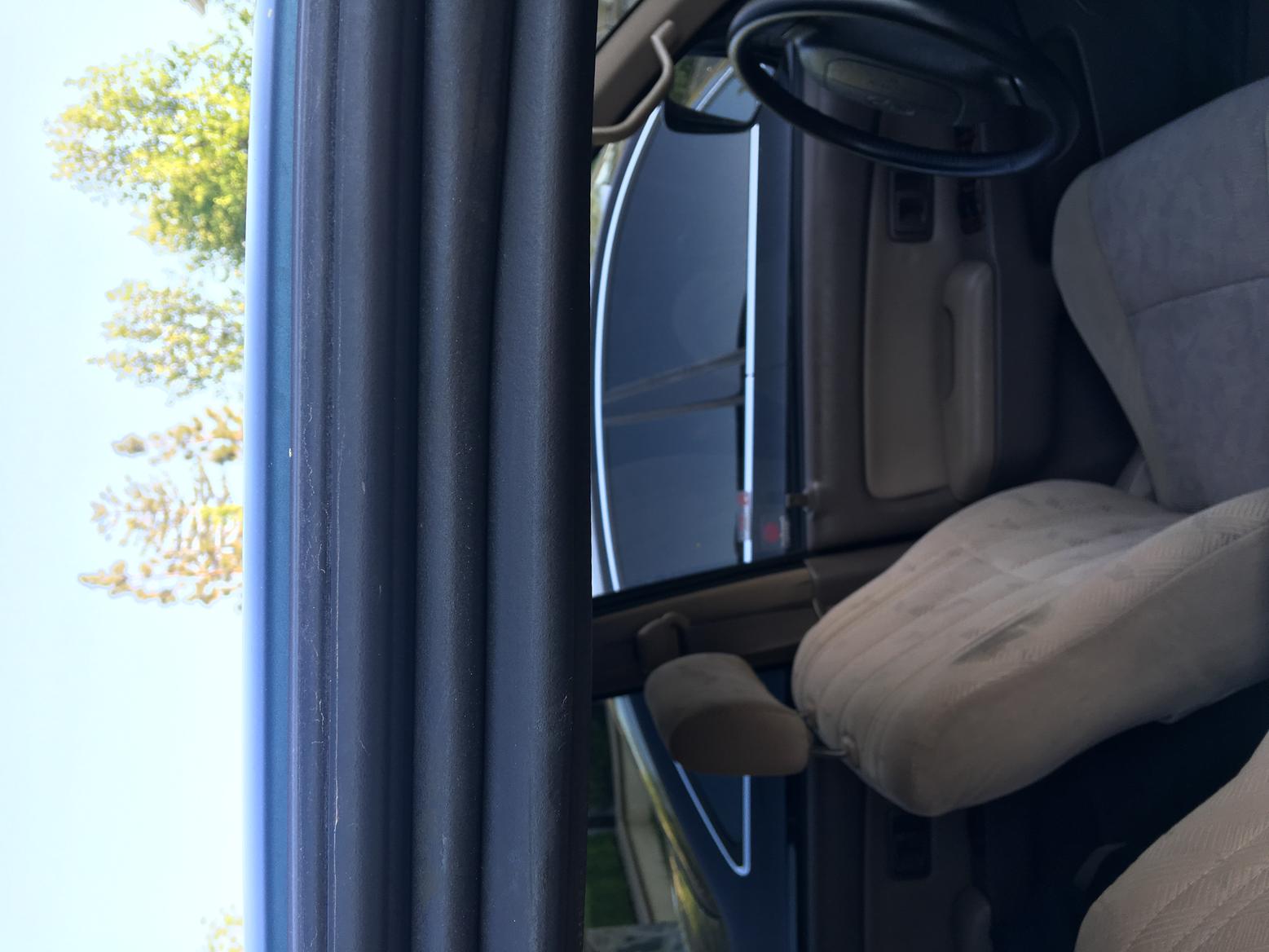

I found the picture for the one I took off another 4runner...
This one is not torn & in good shape. Just dirty.

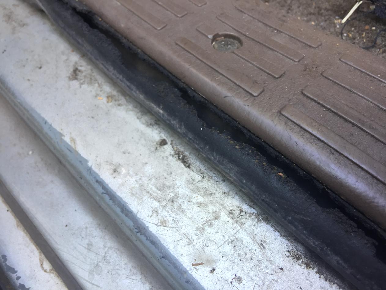

For what it's worth...
I ended up gluing a second strip above the first door seal strip. It cut back on some wind noise and caused door to close a little more solid. Only $5 at pick-a-part

This material was $25 per 10ft roll at Oreilly Autoparts, and one roll came up about 12" short on the drivers door, so I had to use two rolls. It's clearly lower quality rubber and the adhesive on the back is nothing great, but it has successfully stopped my door from squeaking and banging back and forth on bumps. Which was the primary reason I was looking to replace this stuff.
On closer inspection I realized the oem seal is actually a bigger piece that's attached under a lot of trim parts. It's also a lot thicker and more rigid than this little universal one. If I removed the oem one entirely, I was afraid the new seal wouldn't actually be thick enough to replace it, so I cut the tubing portion off of the oem seal and applied this cheap one over the top of it.
It looks like sh*t and frankly it's a temporary fix, but it has stopped the god awful door rattle. I expect this seal will fall apart in a year or two, at which point I'll just have to pay $$$ for an oem replacement.
