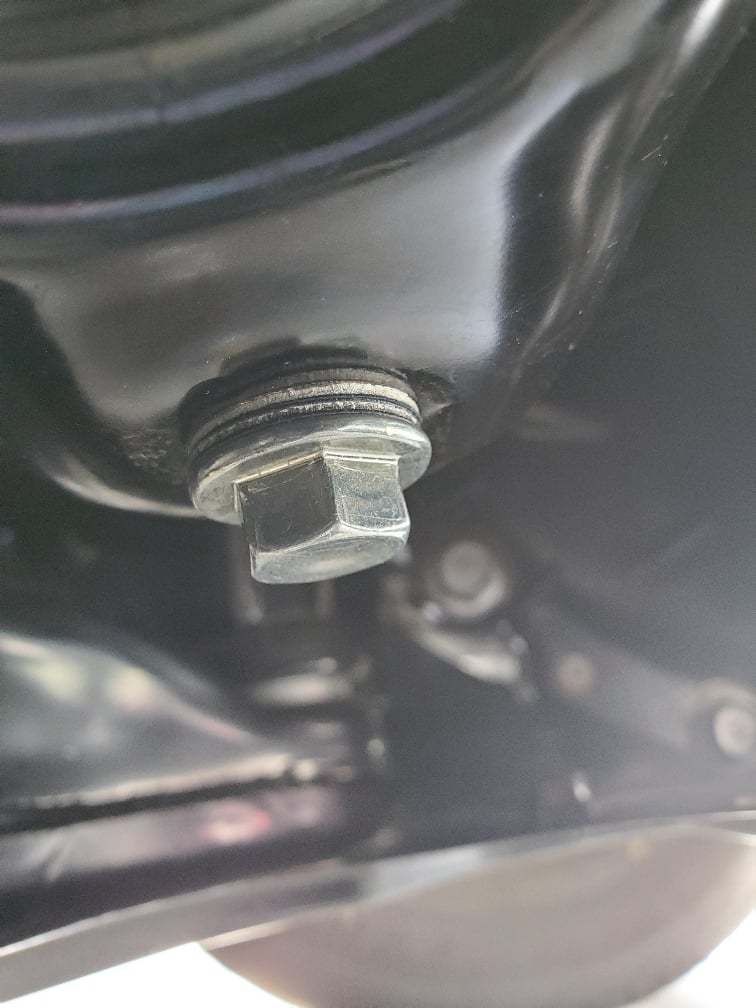

Just changed the oil on my 4runner. There seemed to be an extra washer that was stuck to the pan. I'm not sure if this was the original washer or if it was part of the pan. I tried picking it off with my hand and it wouldn't budge and didn't want to use a tool on it in case it's supposed to be there. I added a new washer on top of it, and then the bolt. Did I **** up?
I started the car for 5 seconds, no leaks.

Should only be one washer between the plug and the pan. Next time you change the oil, take a 1" putty knife or large screw driver and gently tap at the washer stuck to the pan....it should come right off.

Thanks. I started the car and there's no leaking. Do you think it's alright to drive for another 5k? Or should I just err on the side of caution and remove it.

You'll be fine with the 2 washers till next oil change....same thing happened to me before. Kudos to you for catching it....I'll bet there are more than a few 4runners out there with double oil pan gaskets!
I noticed the same thing after screwing drain plug back in. Removed it to examine. After concluding it just didn’t look right, took a thin bladed standard screwdriver and attempted to gently pry. It came right off. When I had attempted to do the same with just my fingers it wouldn’t budge. I’d just periodically keep an eye on it till next oil change. Doubt it’s gonna back out as far in as it is, no biggie if it’s not weeping either.
They can stick pretty tightly. Also, the pan is under no pressure. If you torqued correctly, you should have no problem.

By the way, that photo looks like there are THREE gaskets under that bolt. I’d be a little concerned about how many threads are engaged in the oil pan.
