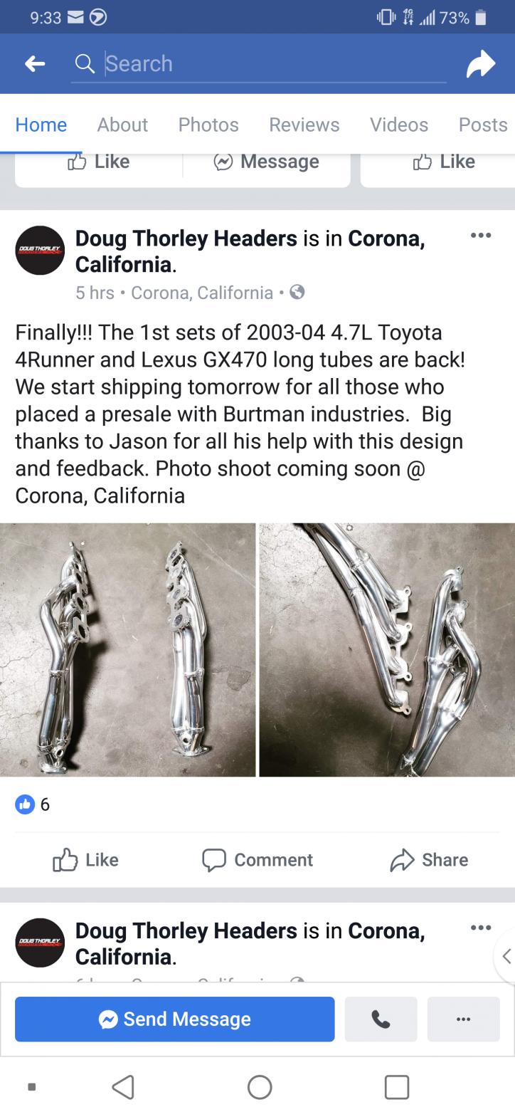

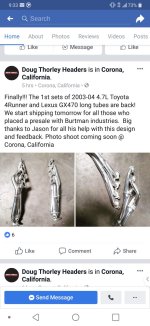

[MENTION=9]Jason B[/MENTION] makin it happen!
