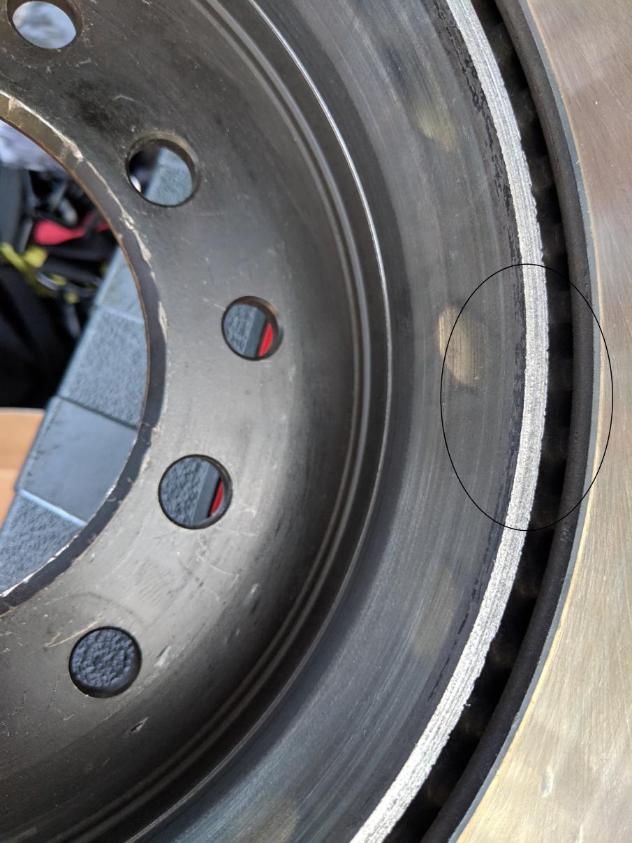

Here is a picture of the backside of the rotor with the area of interference marked.

Purely guessing:
You're are dealing with two issues.
The scarring on the interior is left from the springs and pieces of the e-brake assembly that they found when you took it back.
The remaining noise is from the backing plate/dust shield rubbing on the back of the rotor. I'd bet that when they removed the old rotor they beat the hell out it and hit the backing plate or dropped the wheel on the plate. It seems like the noise/rubbing could have been found when you put the new rotor on.
E-brake shoes should last damn near forever. Why did the springs and clips just 'fall off' just after the Pep Boy monkey installed new rotors? They did this! Something with the e-brake assembly was damaged when they were in there.
Even if they won't make it right, new shoes and a full rear spring/clip install kit is only about $60. They were right there looking at it once; now another $500 to go back again? BullShit.
Mechanics and Doctors- Hate em.
I'd bet anything that you are right. I ordered a e-brake kit from Toyota that should be in today so once I get the rotor off I will look again to see where the possible bend is. Since I eliminated any related noise from the screwed up brake shoes by removing everything in there I should not be having this rub but it's loud as hell and by inspecting the rear of the rotor something (as you said more than likely the backing plate) is rubbing on the back of the rotor.
I'll look for rub marks again today on the actual backing plate to see if I can find the spot.
At this point with the argument had at the shop over this I will just tackle the job myself. I did the shoes on my 75 Volvo military vehicle so I will assume this will also be a shit job. :argue:
