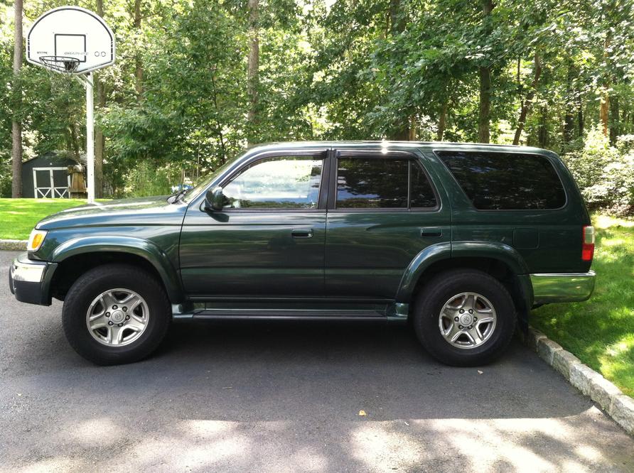

Everyone love's pics. Here's moms 4runner:

After 13 years of life in NJ and 162,000 miles (I know thats nothing), moms 4runner is starting to show some wear and rust. Although I think her 4runner is better looking then most found around here. It's still her daily driver and she loves it anyway. I'm looking at getting a rust free one. Money isn't really an issue.
