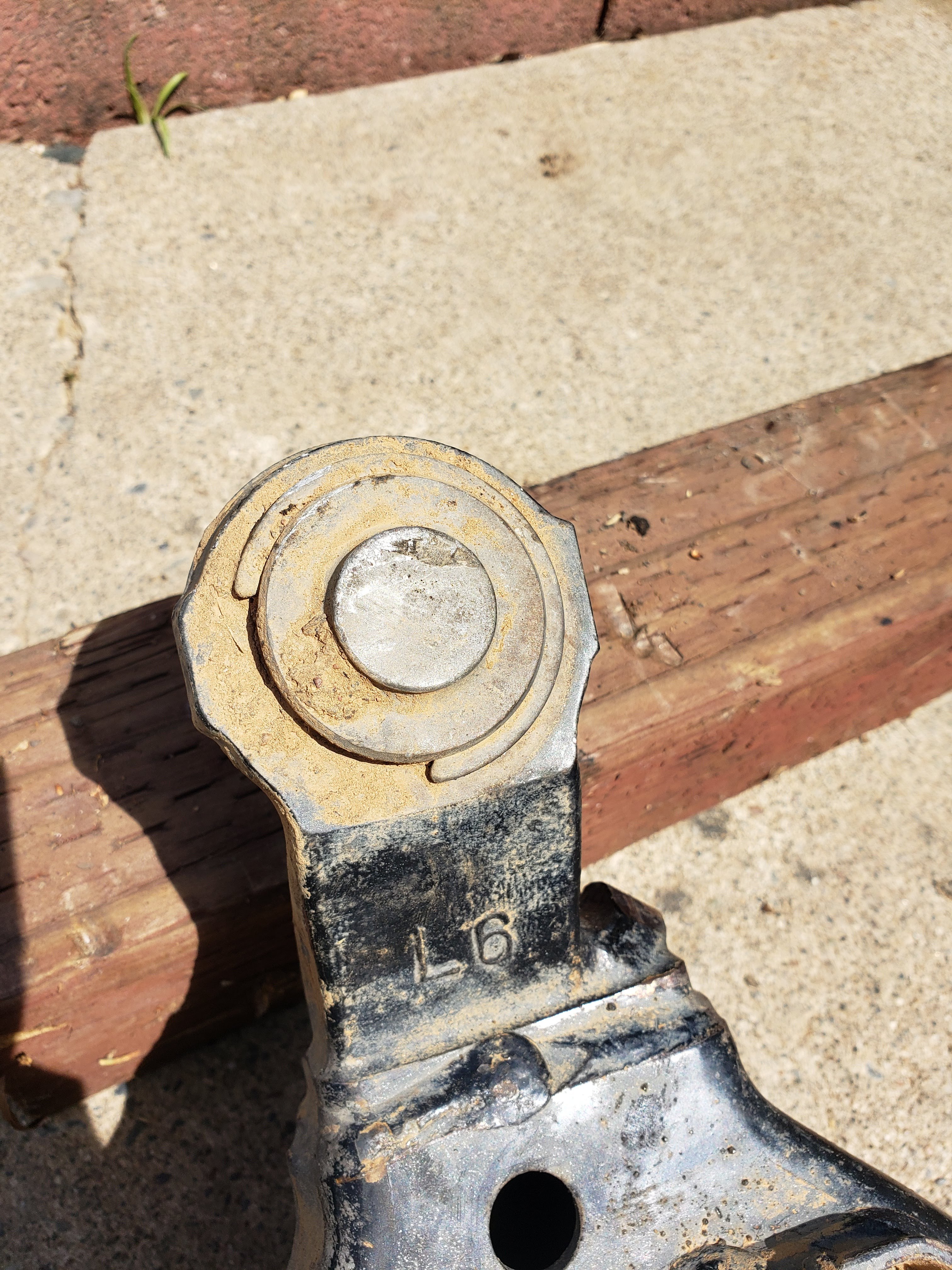

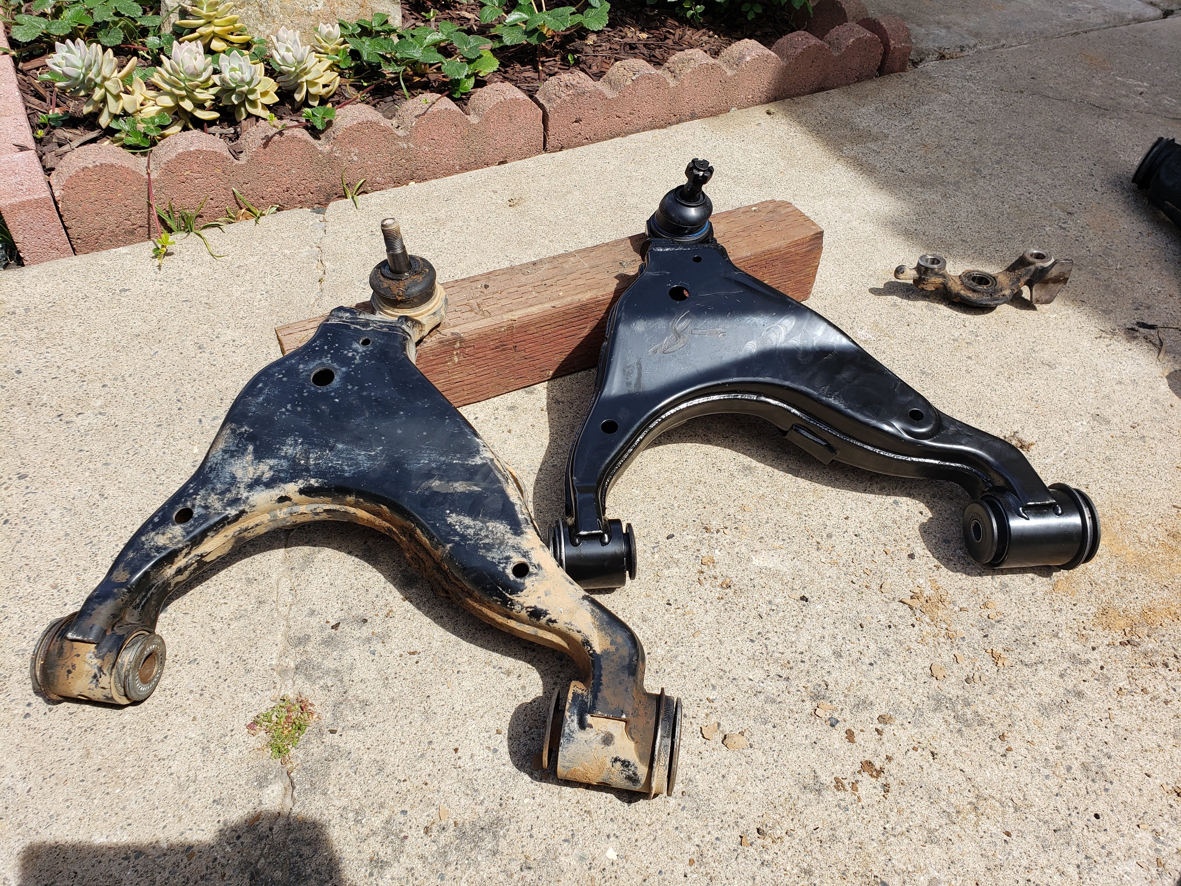

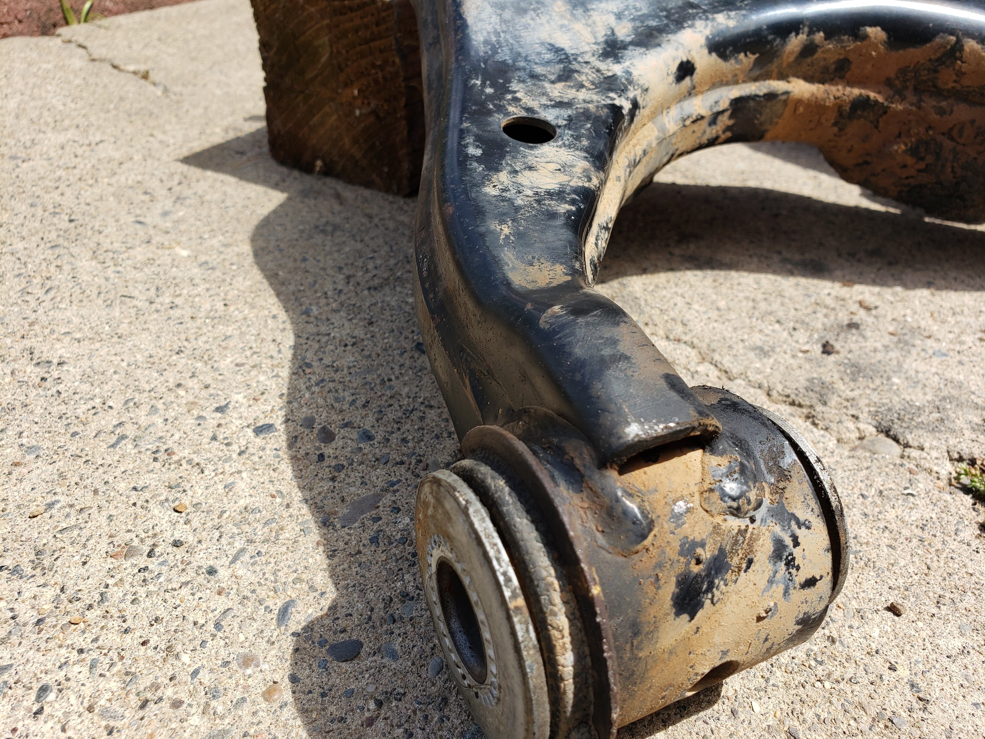

I did a bunch of research about removal and installing the LCA while waiting for them to arrive. Lucky me, I only had one seized cam in the front passenger side. Used a grinder and it took 4 min.

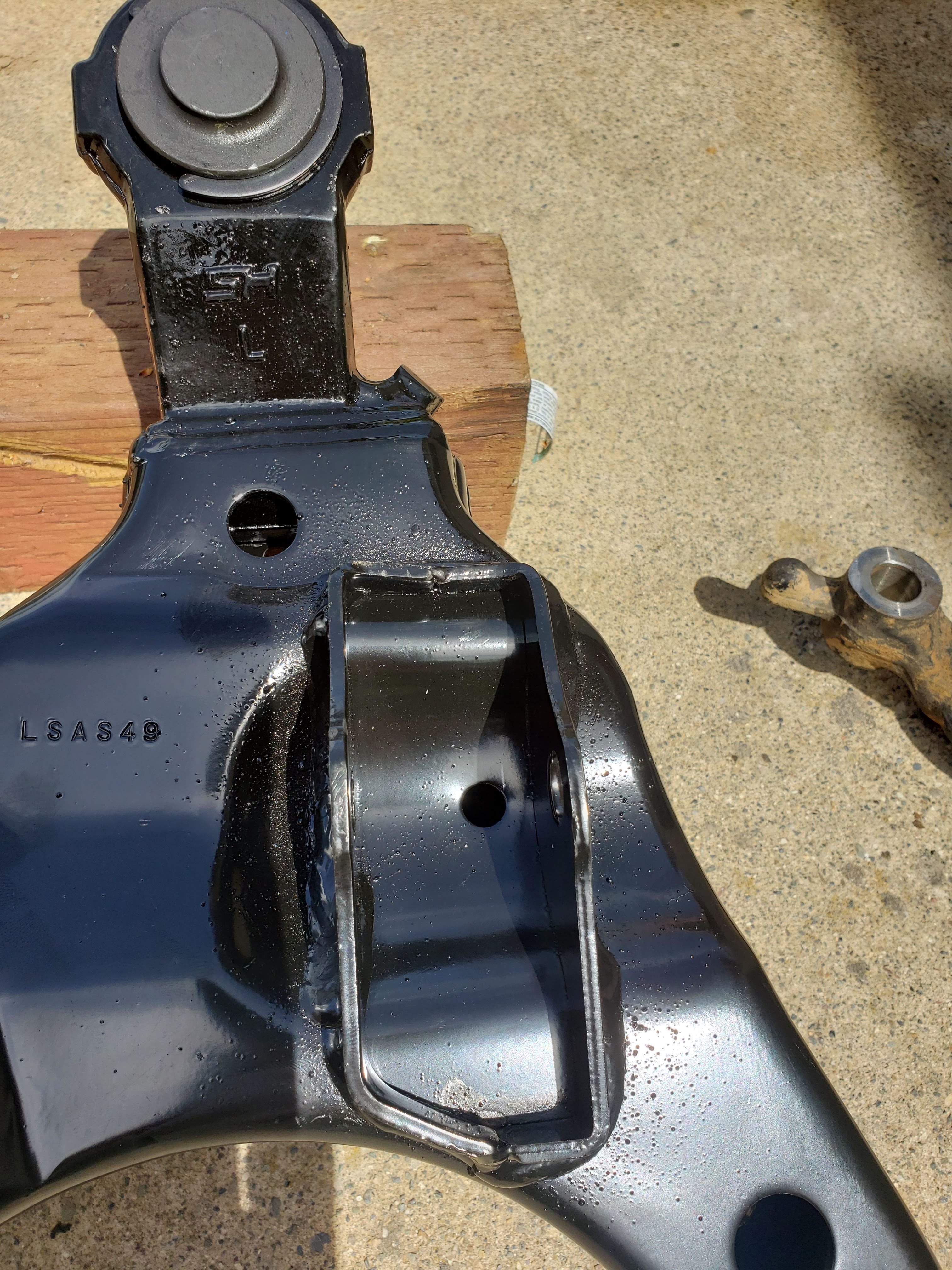

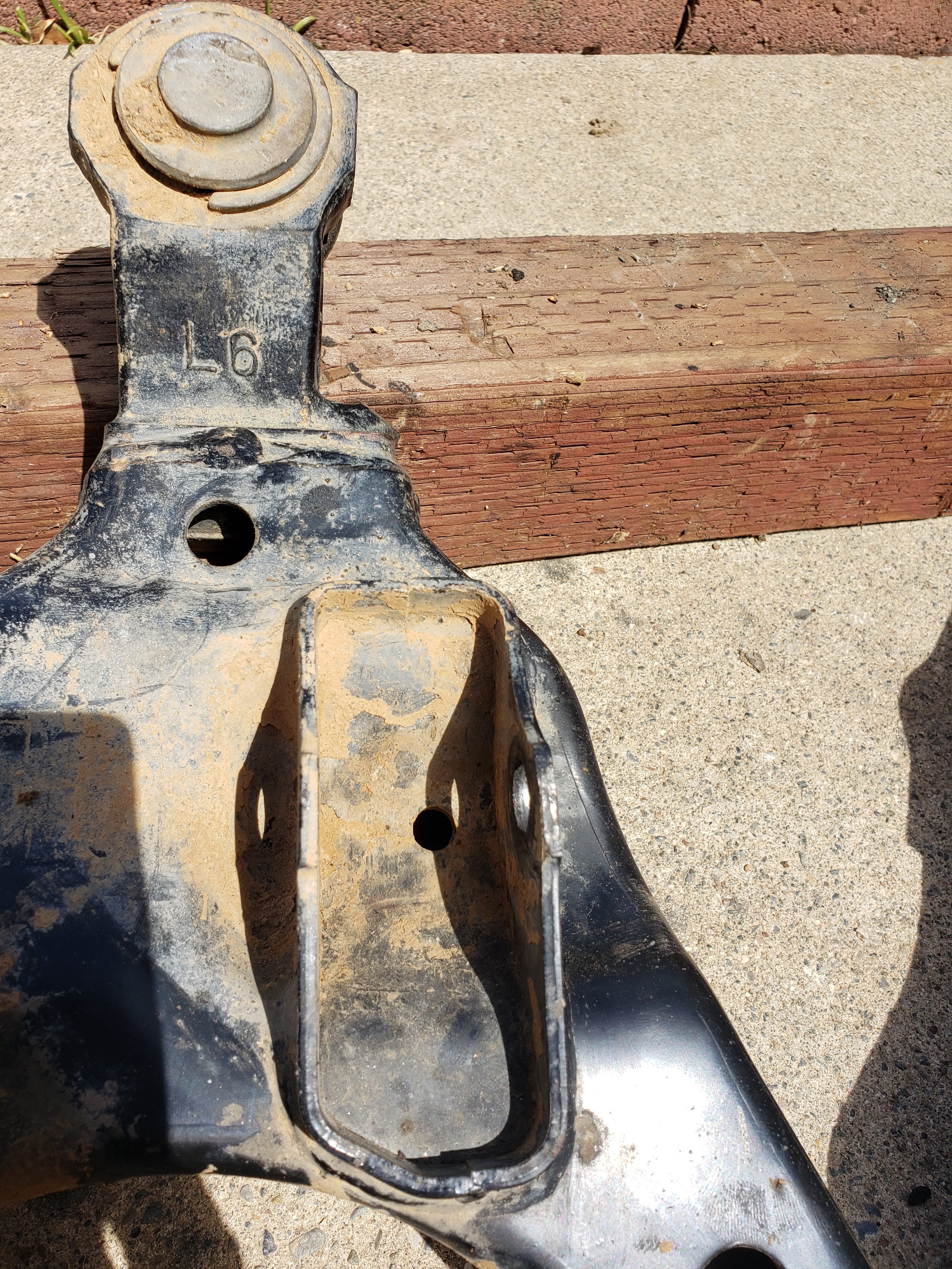

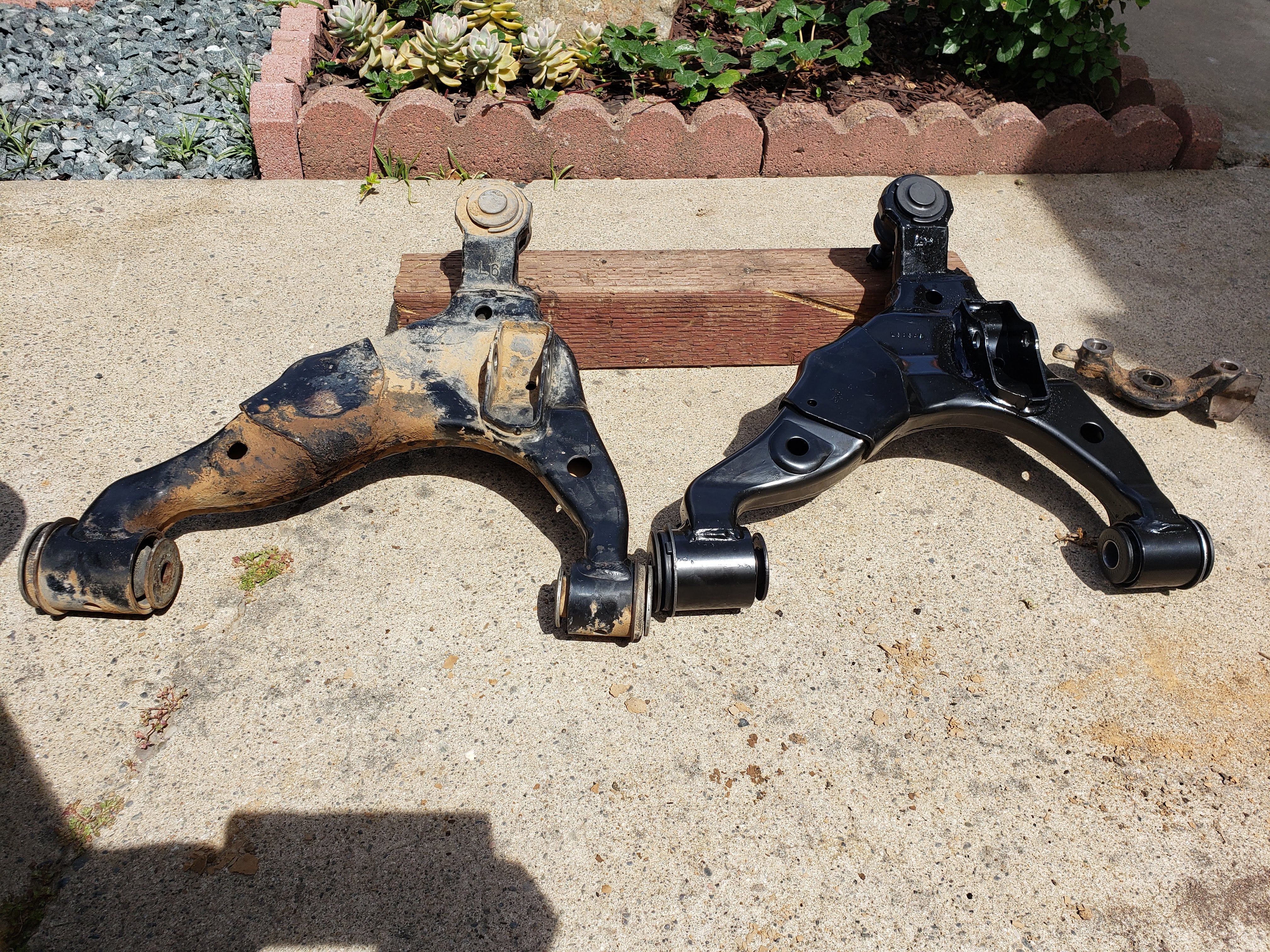

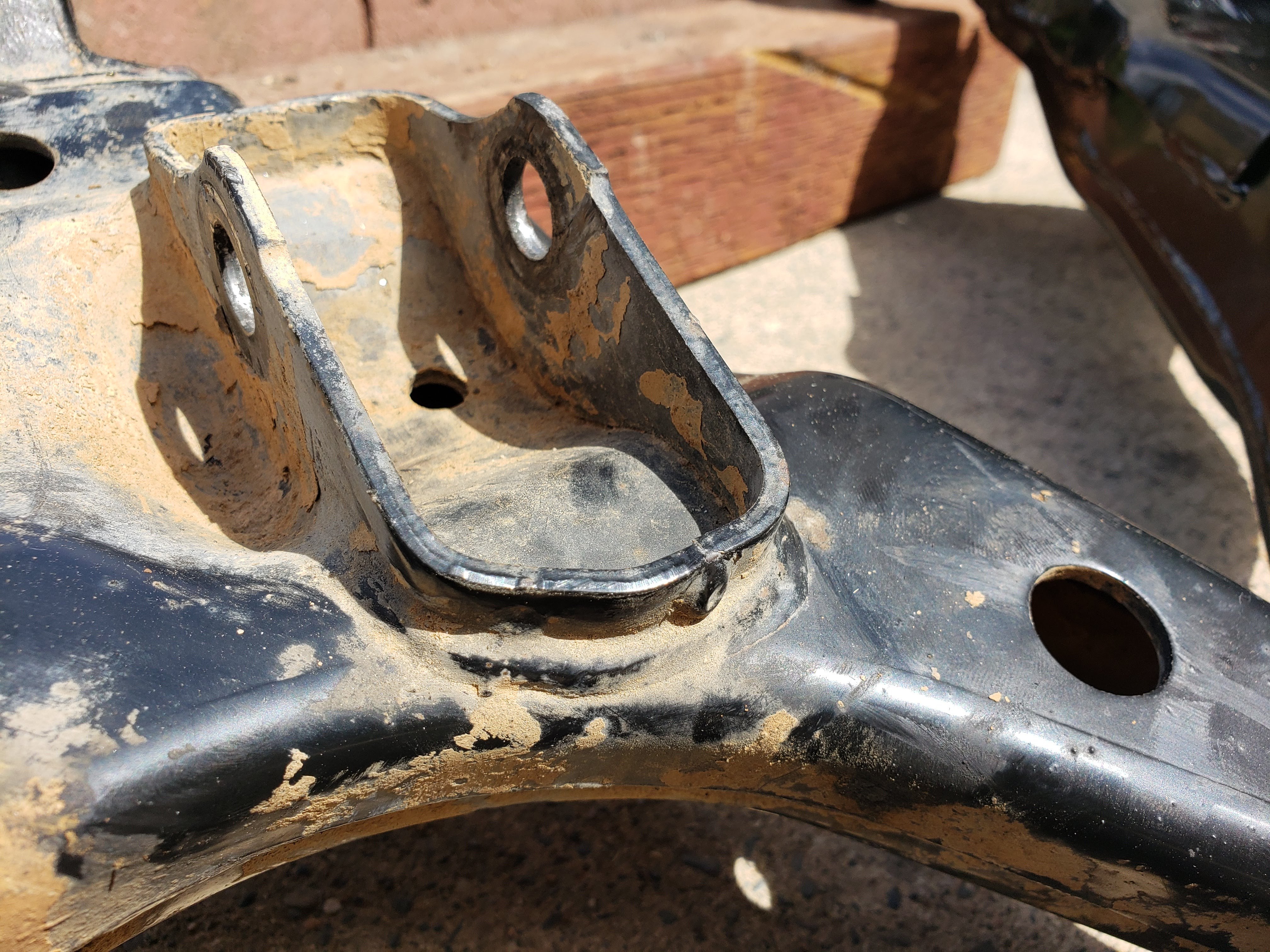

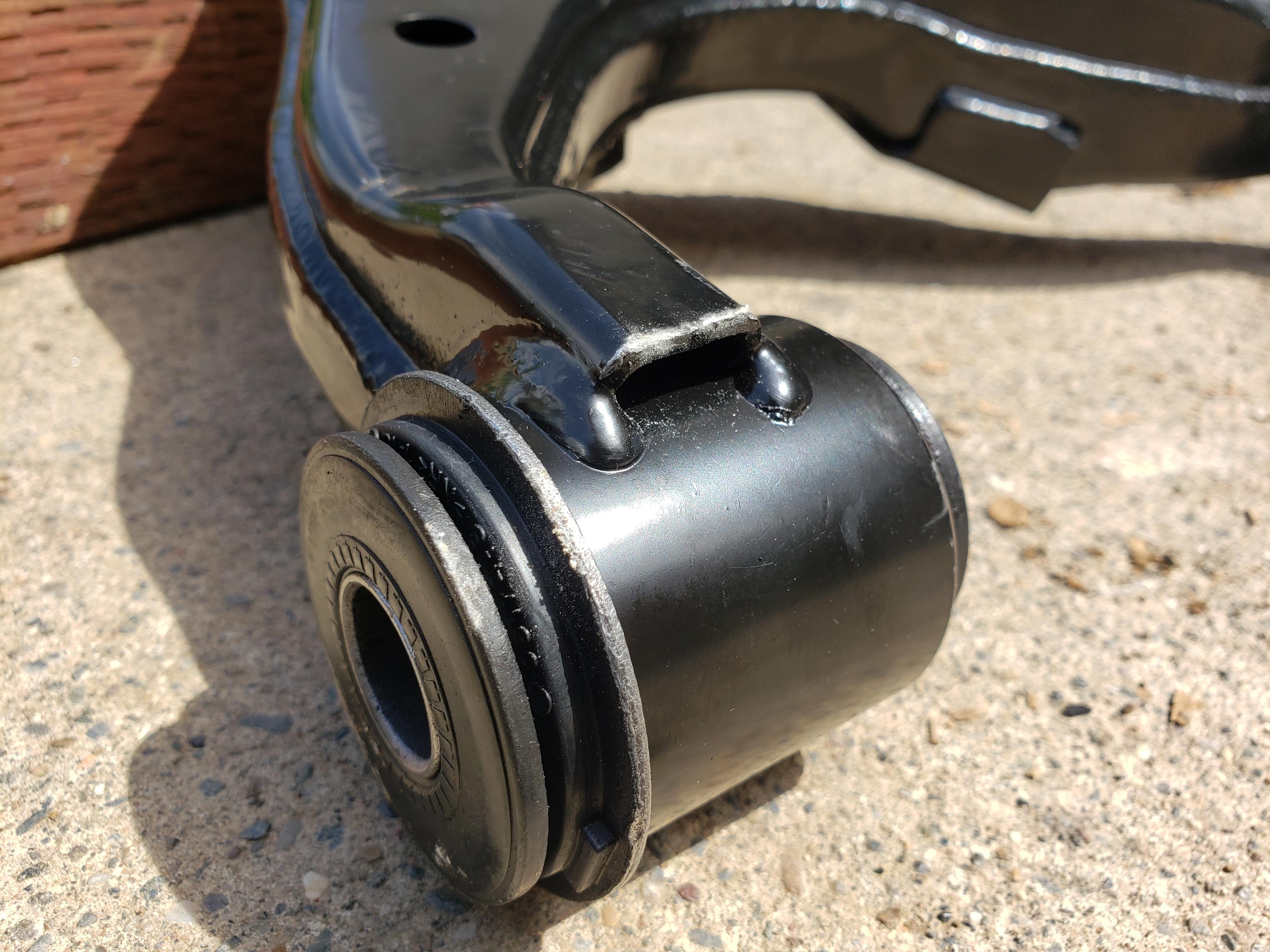

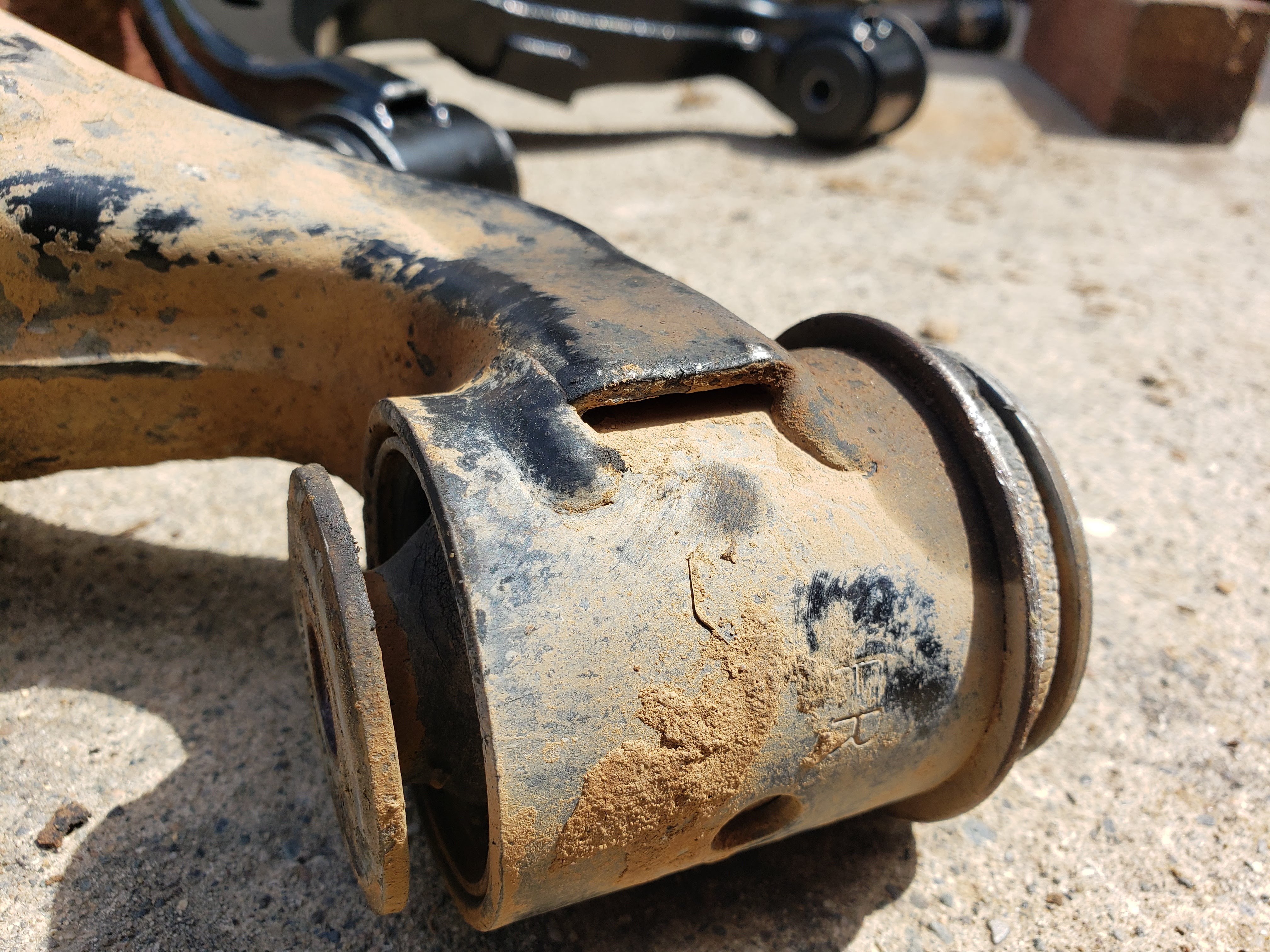

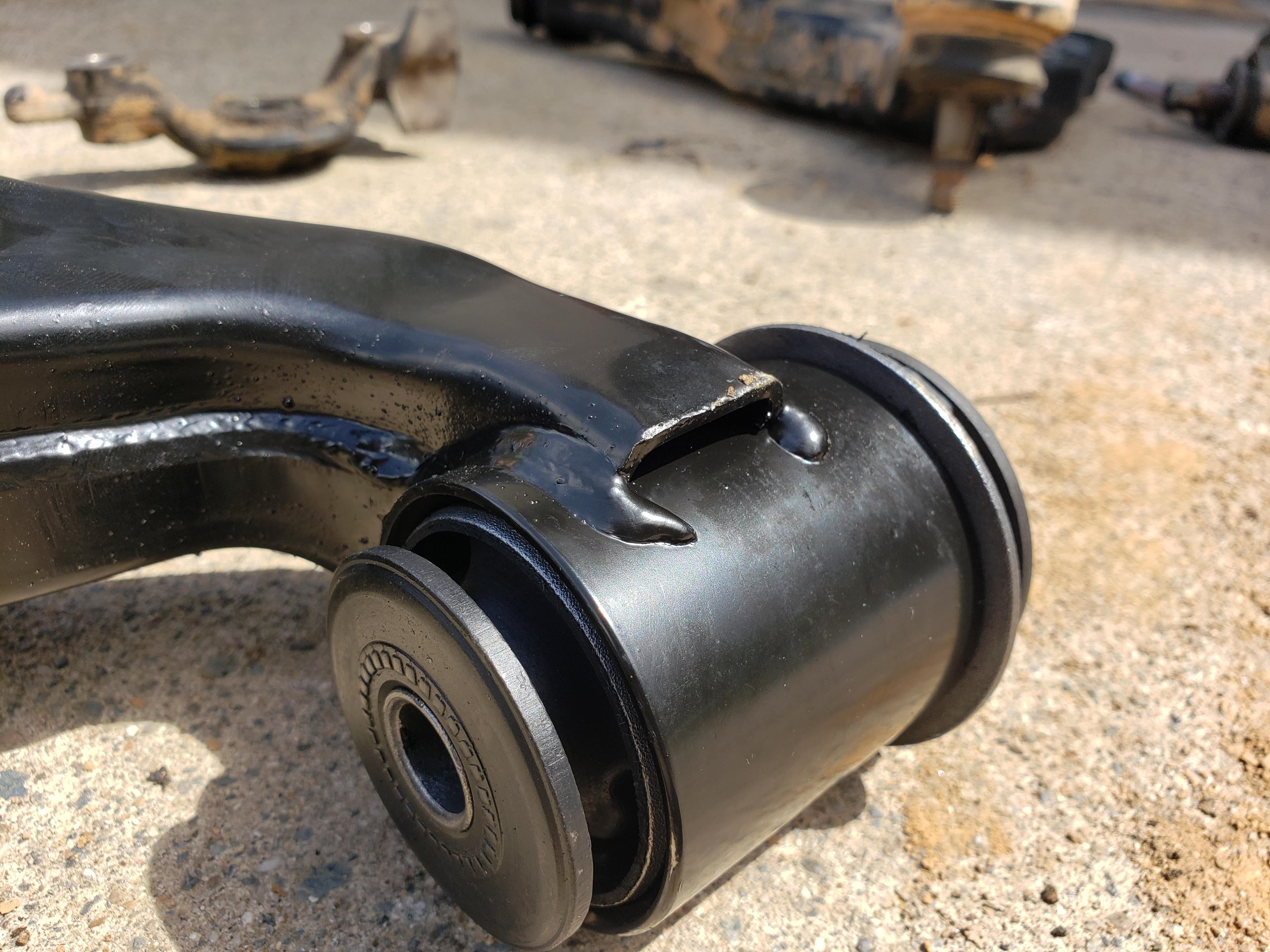

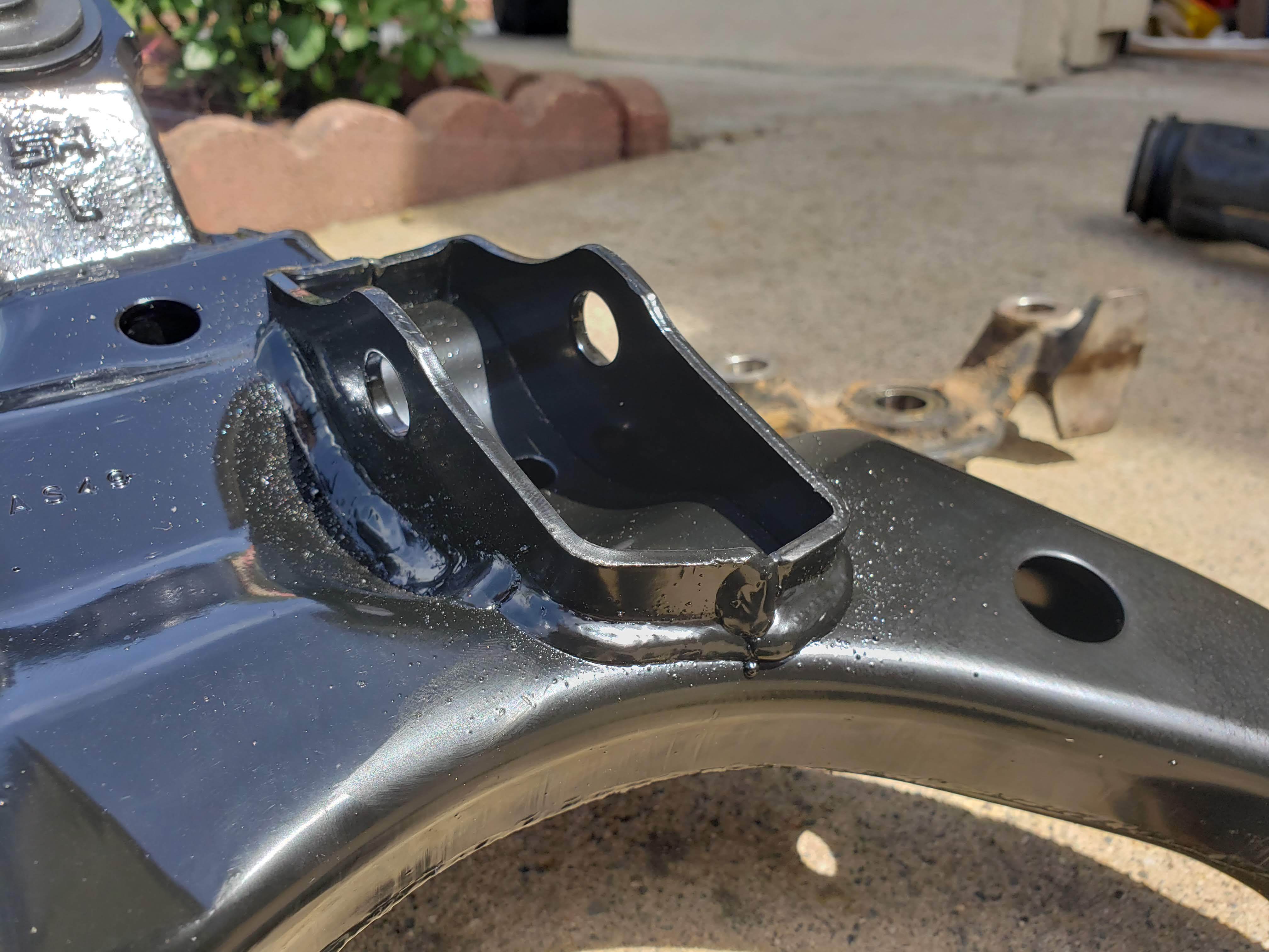

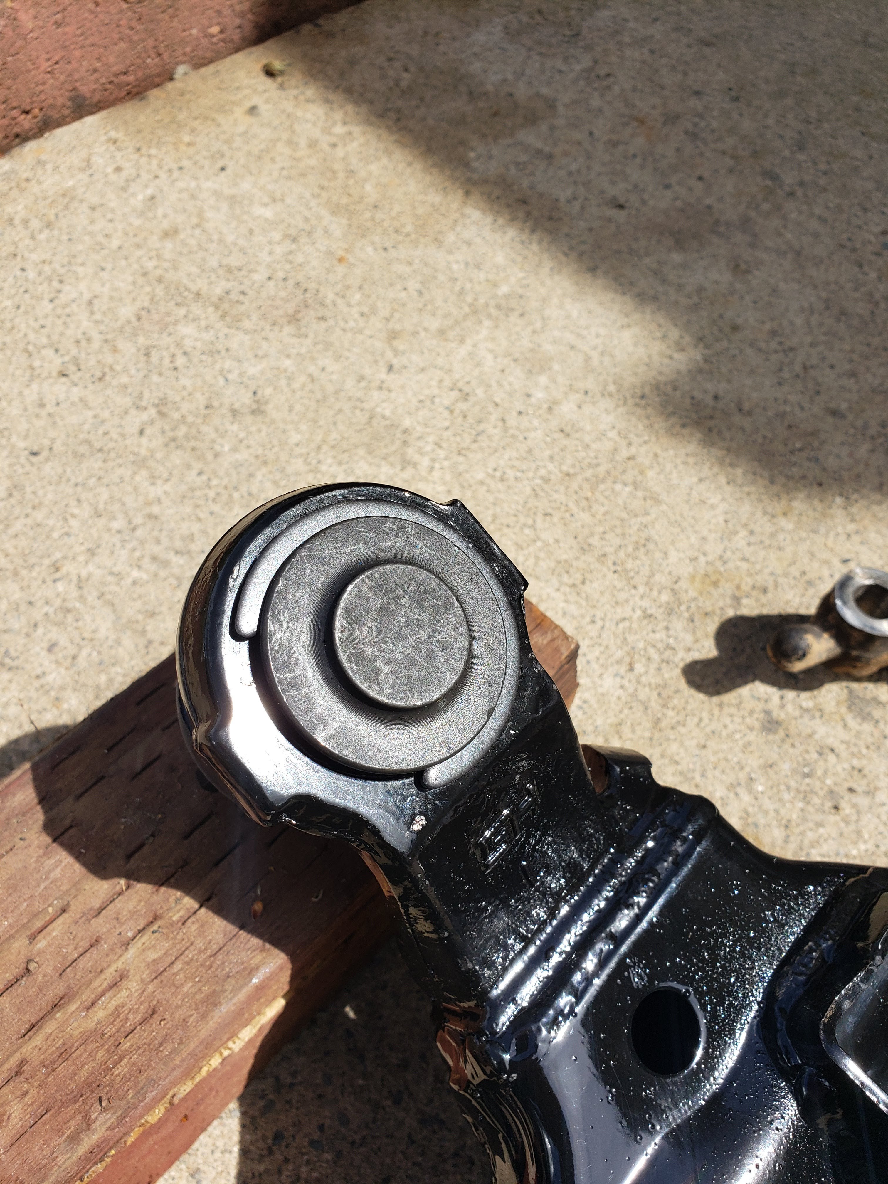

About the Ebay lower control arm. It is almost identical to the stock one. Difference i can see is the spray of metal from welding
and this part has a bigger "divot"

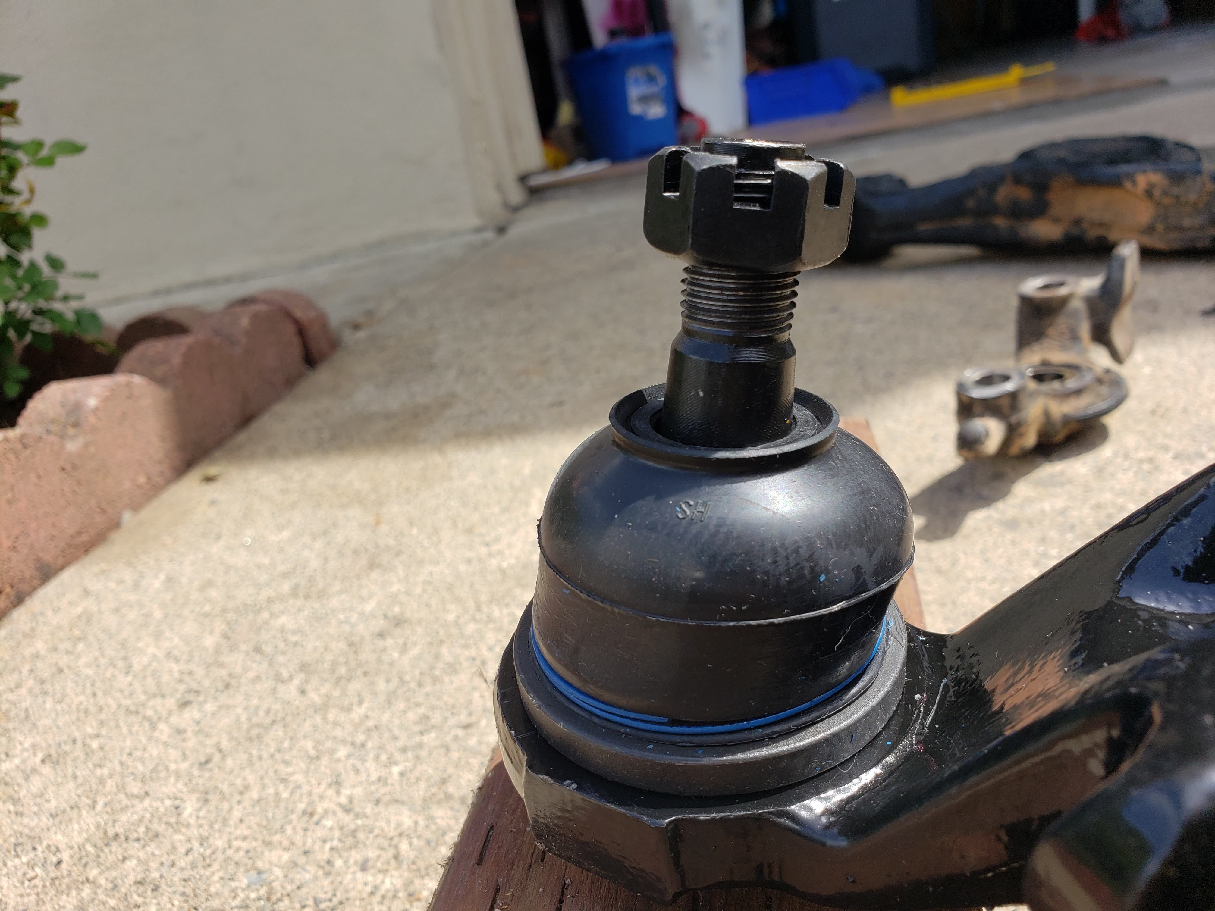

Balljoint looks identical as well
other then that, i installed them without any isssues and truck feels nice and tight. I guess we will see how they last.

Before I installed it I pulled the BJ seal to the side and needle greased some more grease in it just in case.
