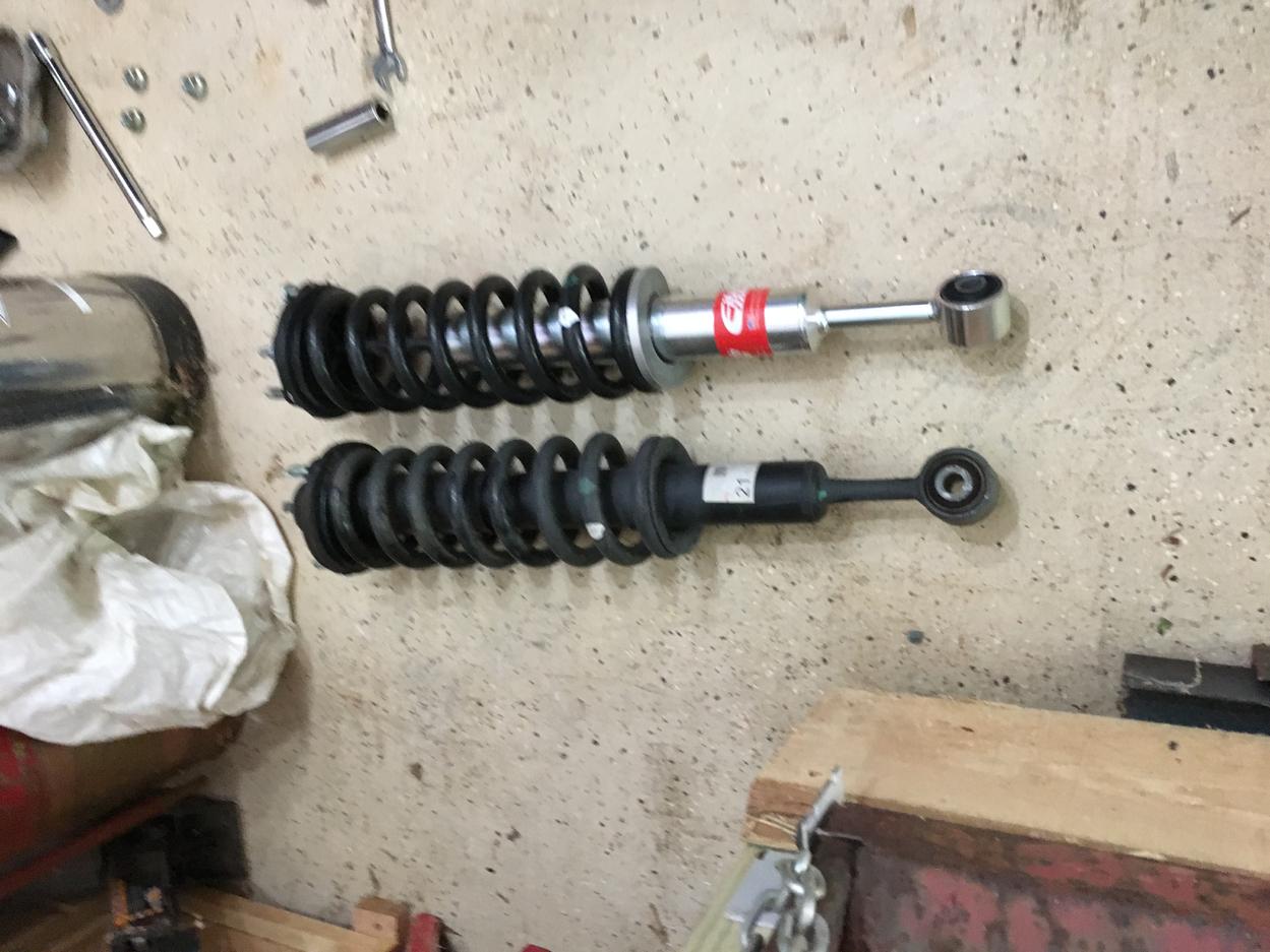

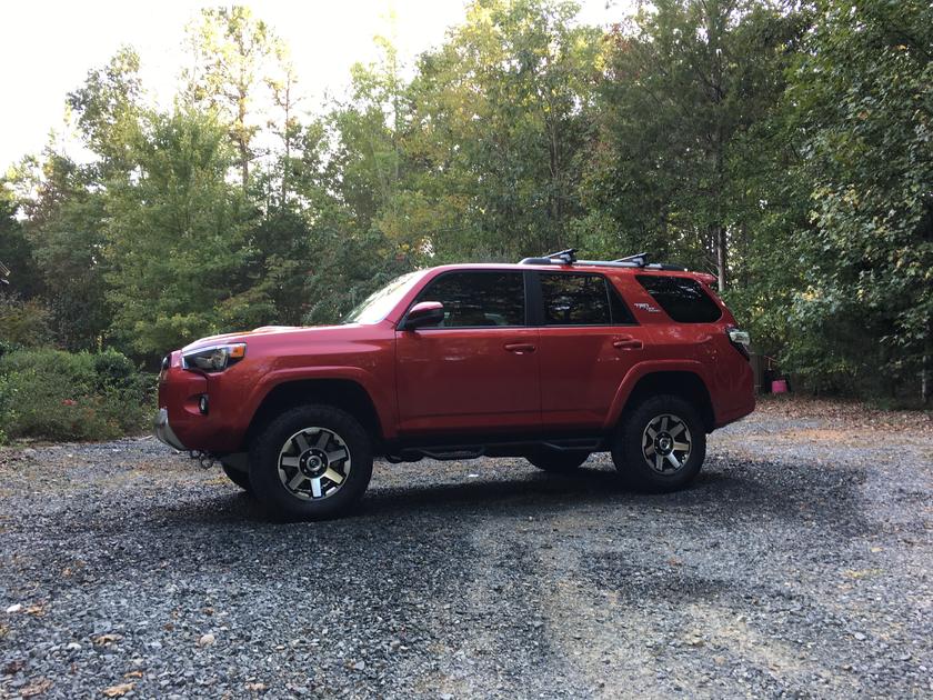

I thought I’d share my experience with the Eibach pro truck shocks. I was looking for a mild 1.25 to 1.5 front lift and better shocks. I started by looking at Bilsteins However, the 6112 were backordered and I thought the 1.85 was too much with no rear lift. I ended up with the Eibachs on the factory springs at the 1.6 setting. I ended up getting the Eibach rear spring also, but I got the 4th gen ones that netted my .8”. The ride is firmer but not harsh or sharp. Overall I’m very happy with them.

What’s the part number on those? And what is your actual front lift? Looks like more than 1.6. Looks good.
Eibach E60-82-008-02-01 - Eibach Pro-Truck Sport Shocks EIB-E60820080201
Shock, Pro-Truck Sport, Monotube, Rear, Toyota, RWD/4WD, Each
(Mfr. #: E60-82-008-02-01)
$91.34 2 $182.68
Eibach E60820710210 - Eibach Shocks and Struts EIB-E60820710210
Shocks and Struts PRO-TRUCK SPORT SHOCK 2010 to 2018 TOYOTA 4Runner
(Mfr. #: E60820710210)
$115.64 2 $231.28
Eibach E30-82-073-01-02 - Eibach Suspension Leveling & Lift Kits EIB-E30820730102
2007 to 2009 TOYOTA FJ Cruiser Base PRO-LIFT-KIT Springs (Rear Springs Only)
(Mfr. #: E30-82-073-01-02)
Here’s what I ordered from Summit racing. The front was at just under 2” before the alignment. Afterwards it was dead on 1.6.
