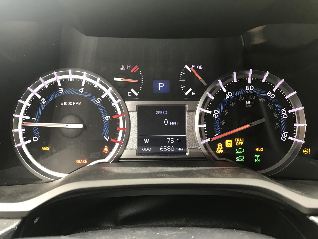

Every Dash Light On....Gauges Not Working
So my new 2018 TRD Pro is having this electrical issue you all speak of. Only 6,000 miles on the thing. I dropped off at the dealer and they said it was the instrument cluster. They had it for three weeks getting the parts and the mileage reprogrammed to the new cluster. I get it back and two days later same crap. If anyone knows a good Toyota tech please PM me their contact info where I can share with my dealer. I feel like they are going to just keep changing parts for no reason. Attached is a picture similar to others as to what it is doing. As info this was while driving at 40mph and note the speedometer says zero. Thanks for any and all help.
Try searching for “Yaw Rate and acceleration sensor zero point calibration” I had these same lights pop up after doing an alignment after a lift. I was able to fix it at home following the steps.
