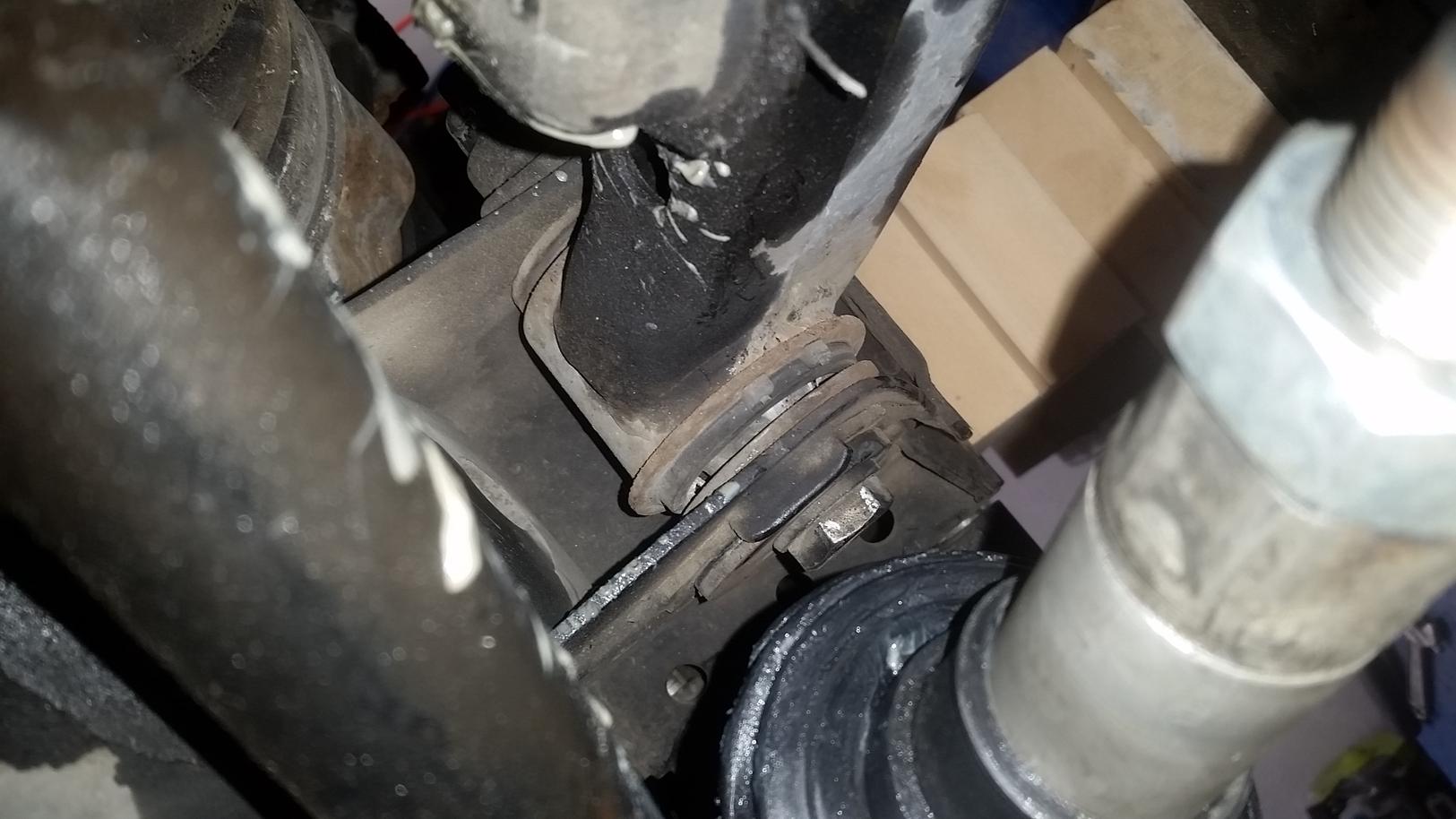

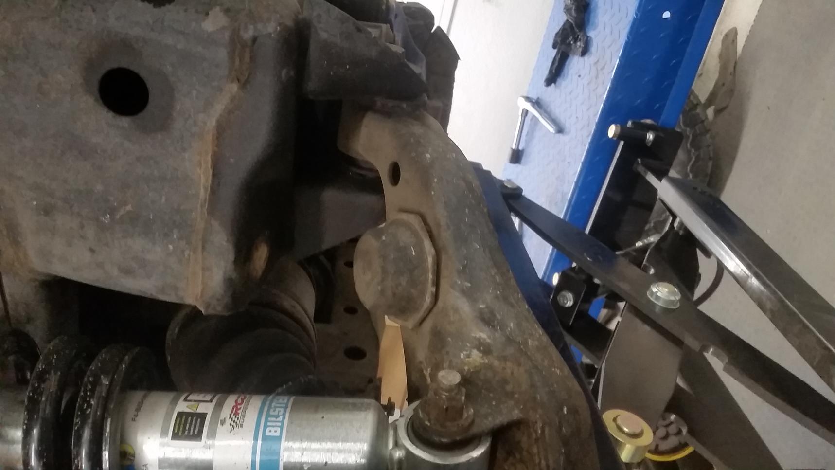

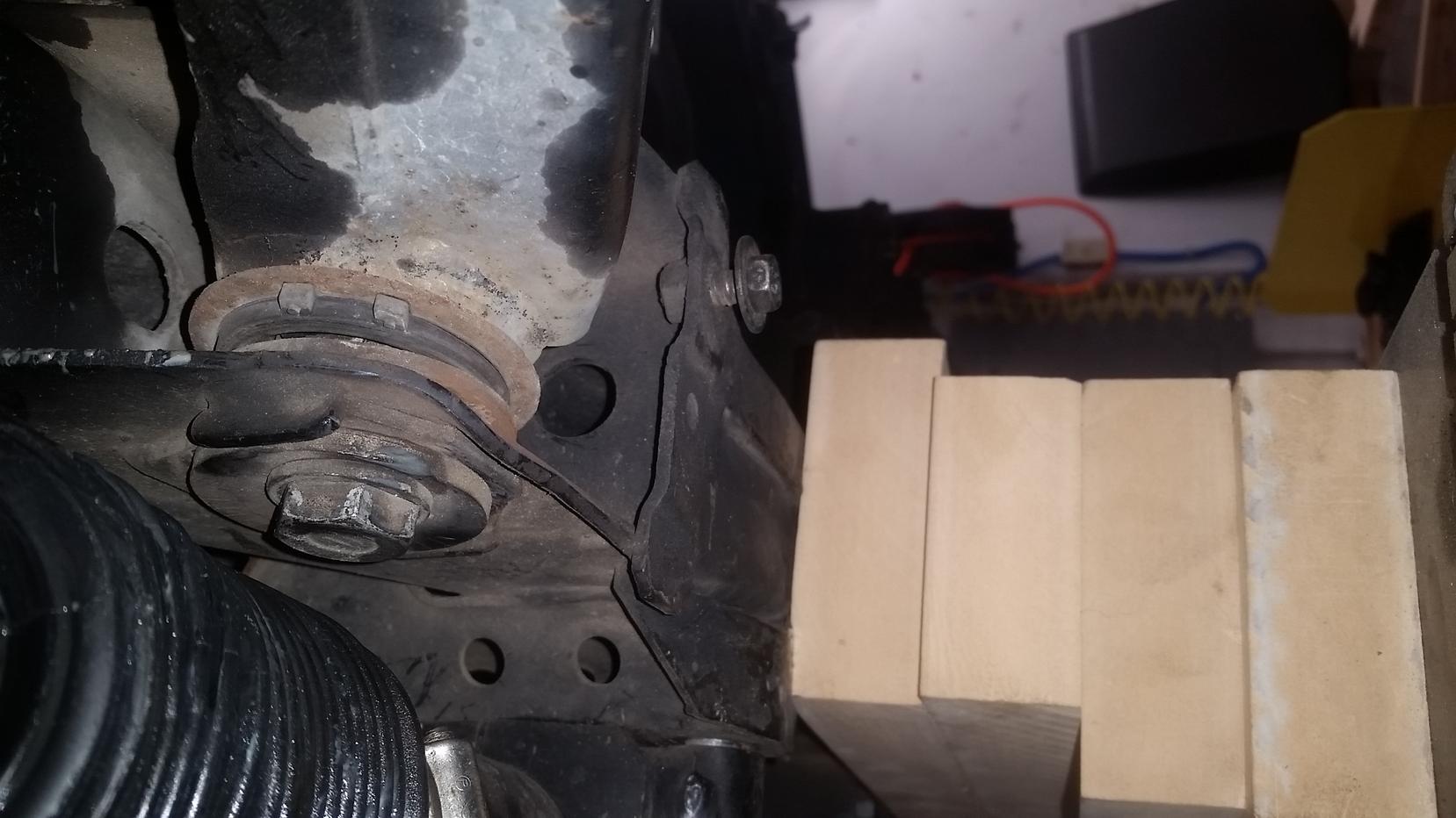

Rack is tight
See anything alarming?

So the rear A-arm alignment bold was hand tight after a logging road run......
