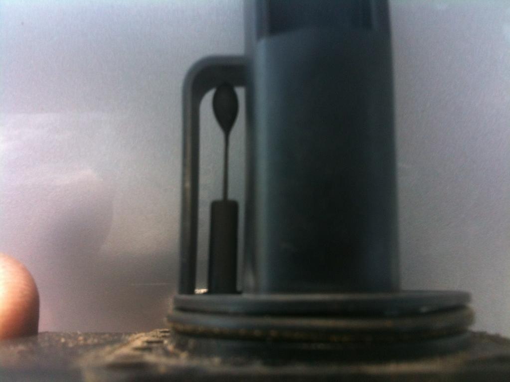

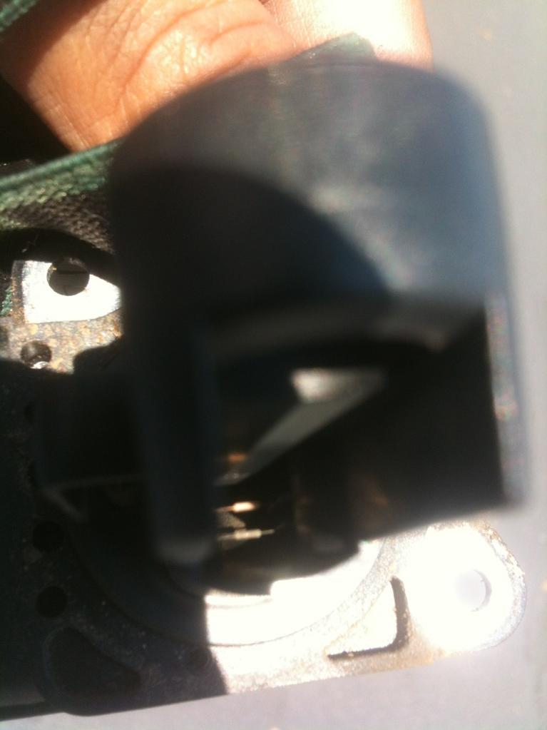

During my lunch I went out and removed the MAF Sensor. Looks good to me except for the temp wire which should not be causing the stutter right?
Disclaimer-iphone pictures
Looking down into sensor
Temp Wire?
I'll take it off Saturday to do the ohm test and still clean it to make sure...might as well do the TB while I'm at it...
