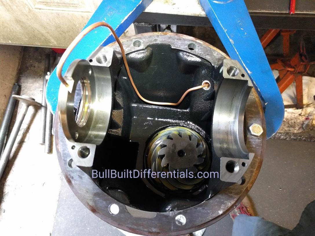

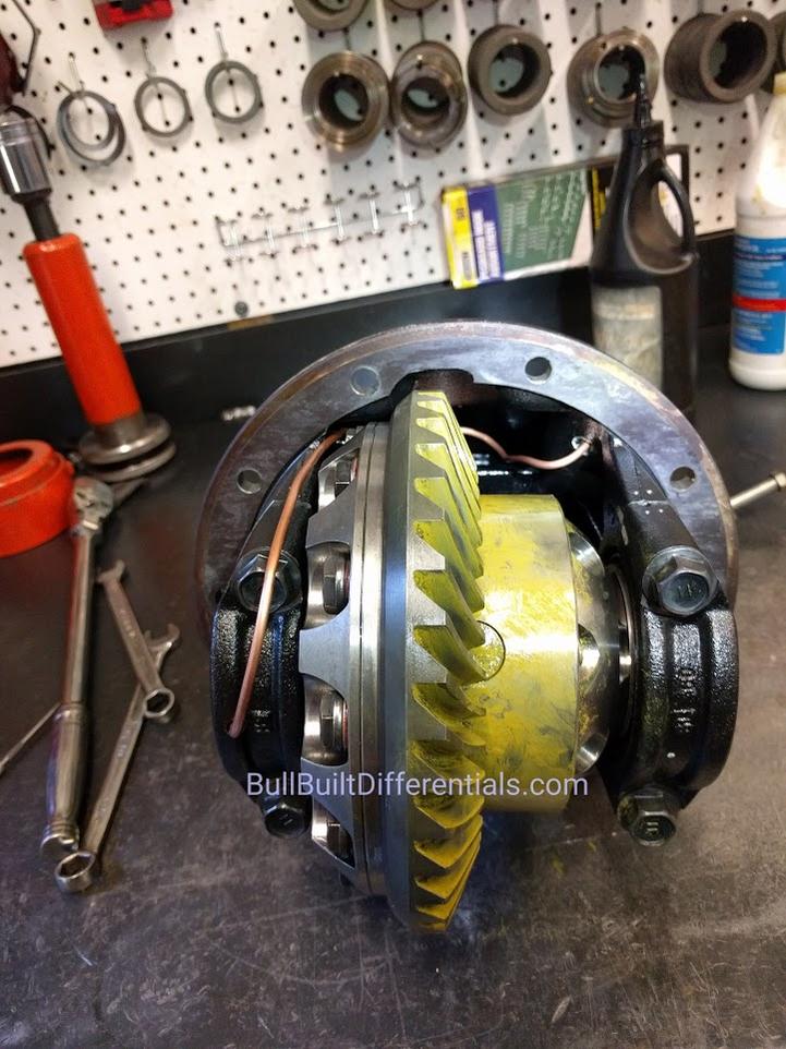

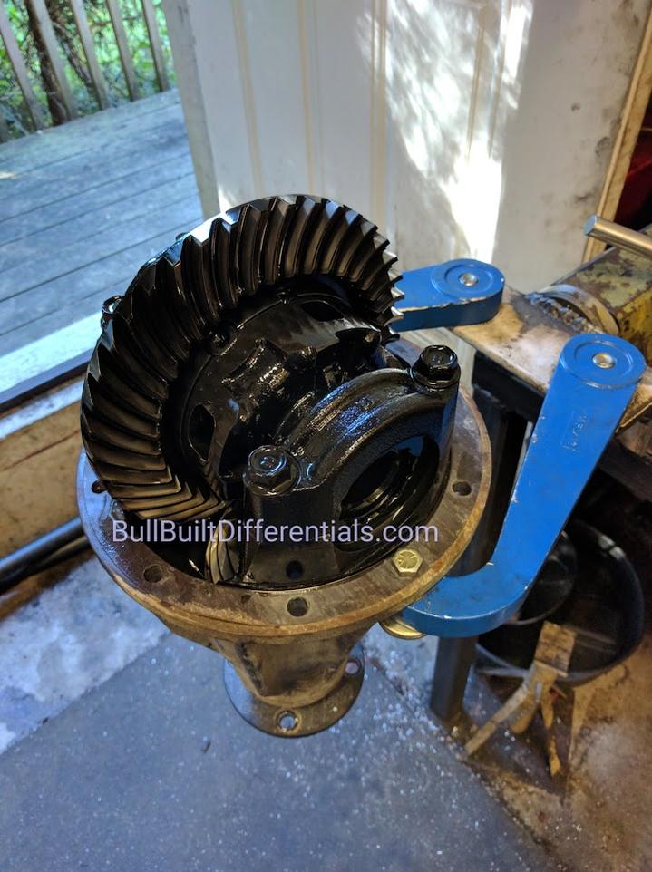

I had my locker installed with gear oil for a tad under $1500 by a shop highly recommended by ARB's tech department. This place does ARB's fleet vehicles. The install took a day. It's a perk to live 20 minutes away from ARB USA :)
I wouldn't trust any shop to work my differential. Be sure to do some research before you go for it. I installed and routed the compressor/line myself.
I've had the locker on for 12k miles now and haven't had any issues. Engages every time with a flip of the switch. The ARB unit is also stronger than the stock e-locker. Machined billet vs cast.
