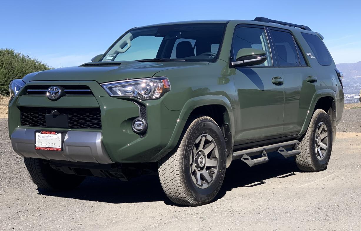

Greetings from a fellow Los Angeles resident with the same concern. First I’d like to echo what others have said about it being okay to drive with 4WD engaged while driving in a straight line or on wet pavement. But that’s no fun. I exercise my 4WD on a stretch of dirt road above Encino between Mulholland and the defunct LA-96c Nike Missile Control site. There are a couple of hiking trail heads there, and picnic tables. The dirt road is gated after sundown and on rainy days.
In fact, I drove there directly after taking delivery of my truck from the dealer.

You are my hero. I live in Studio City. This is perfect.
Great picture by the way.

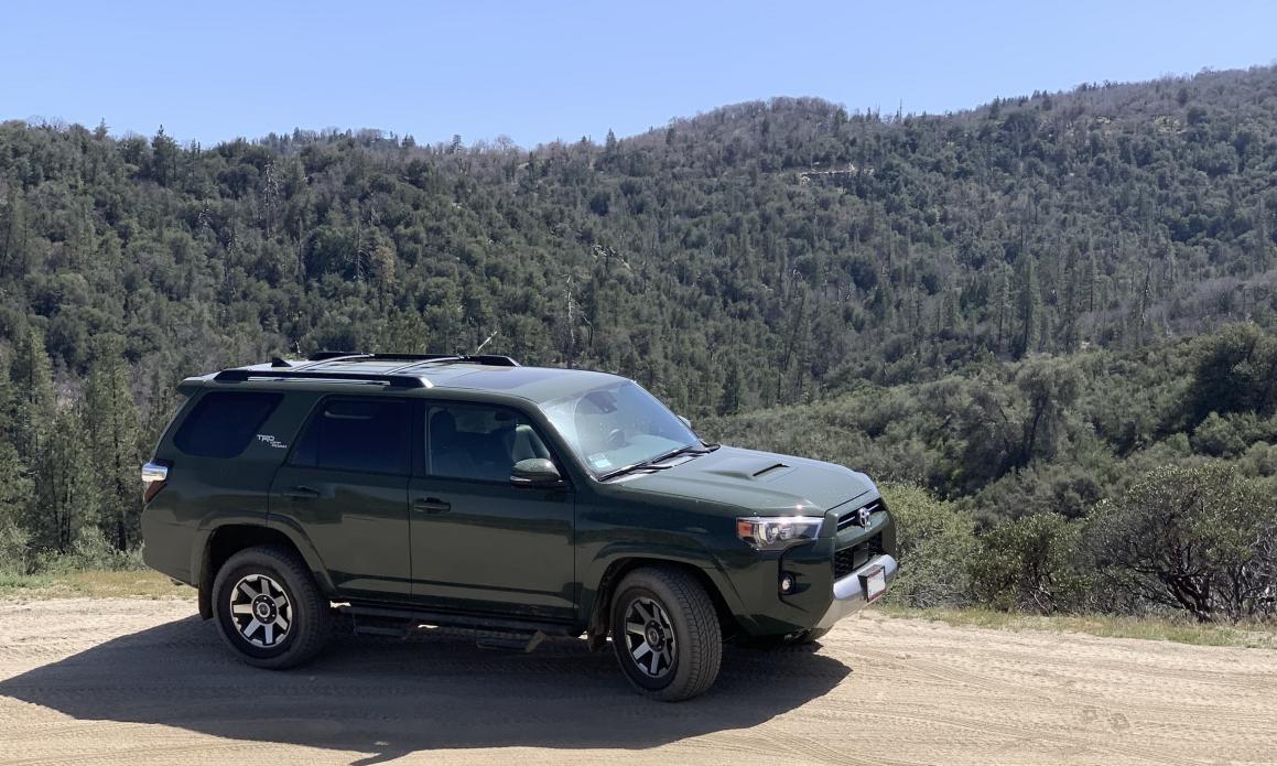

Well I had a fun first foray onto the trail in my 4Runner. I found a fairly legitimate spot to test out the crawl control. It sounds like being under water with a pod of whales. But it was fun to play with. The Predator steps will have to go…
