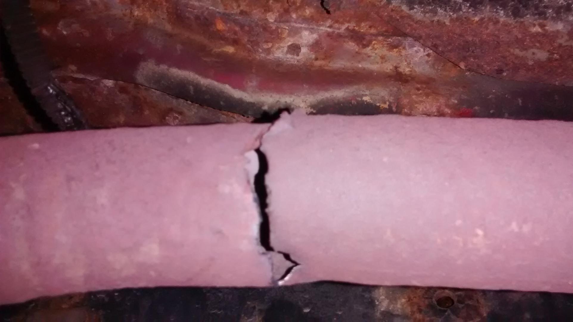

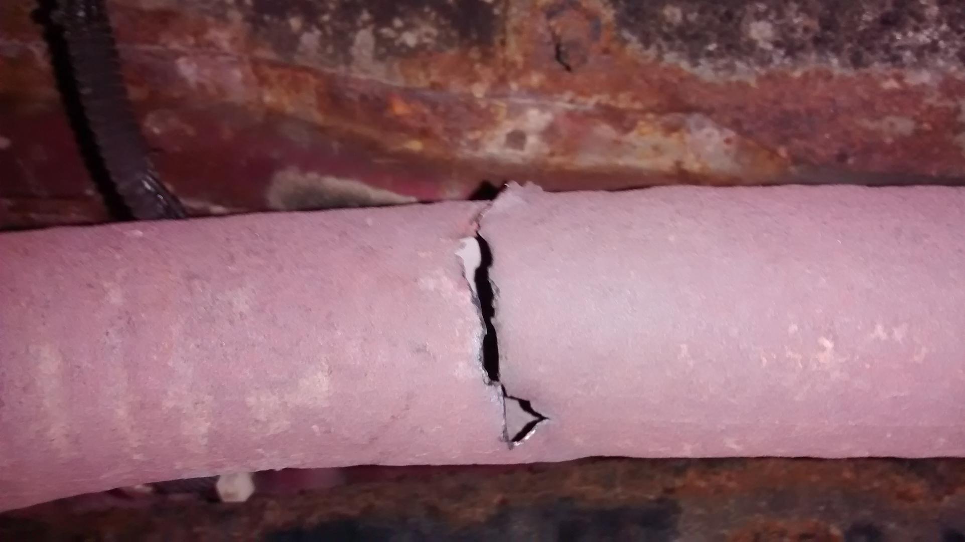

Exhaust leak
Thank you for the inputs . . .
This vehicle only sees about 400 miles
on the road , at most --- main use is as a
Farm vehicle use around the property.
The Exhaust Pipe Crack ( Quite Loud ) is
approximately 5 inches before the CAT and
8- 10 inches from Exhaust Manifold, give or take. I hope that it will be repaired before
this coming Autumn.
Thank you
cferry7
I've seen a temporary fix for this. Take a tin can like the size of Hunts spaghetti sauce, open both ends then split it lengthwise. Wrap it around that section and secure with a couple hose clamps. It works. How do I know? I once bought an old Mustang and when I went to put headers and a bigger exhaust system on it, there it was. I called the PO to ask him about it and at first he didn't remember. Then as I was about to hang up he says, oh yeah I remember! Did that about 10 years ago! :faint2:
definitely a good idea to get it repaired. that said, that will in no way damage the engine.
^ I've used that fix, worked great. If you want something a little more permanent, some muffler tape would hold that leak until you can get around to replacing the pipe.
Oh yeah. Weve all hacked a muffler back together before. Haha. Soup can, some muffler paste and a couple hose clamps!
