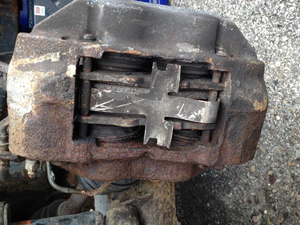

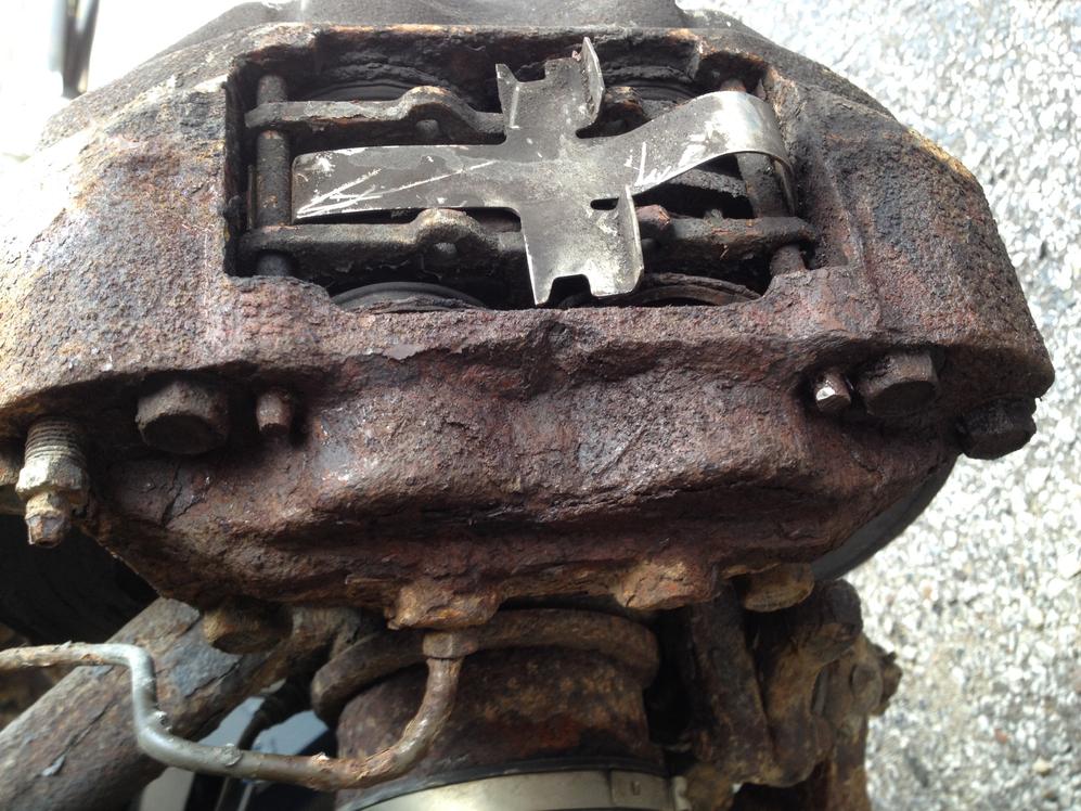

Extremely rusted brake calipers. Pins stuck?
So I ordered new pads and rotors because mine are warped to crap and beginning to squeal so I know they are well overdue. I live in lovely Ohio so everything is rusted. The spring clip I had to brake off and punch out the little pieces but the pins will not budge after multiple shots and sitting with pb blaster. I'm thinking I might have to get new calipers for both sides which I wasn't planning on. What do you guys think?

I'd got for some new calipers. It looks like the seals on the inner pistons are not sealing any more. In short order the pistons will likely seize.
Depending on what wheels you have, you migh consider cancelling your rotor/pad order and instead doing the Tundra brake upgrade. If you're replacing all the parts anyhow, the price difference is minimal. Or zero even (all depends).
Those are toast man. If I were you, I'd go ahead and do the Tundra upgrade. Even if you have to use the 199mms calipers because of your wheels.
You're already going to have to buy new calipers, rotors and pads, may as well spend a few bucks more and upgrade.

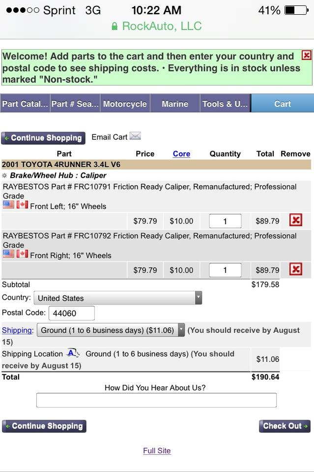

I already received the pads and rotors in the mail from rockauto and it would like cost a lot to ship them back since the rotors way a ton. I guess I should've checked them out before ordering or I def would have ordered the tundra stuff
bummer dude, those looks like they are in rough shape. I have my stock calipers still just sitting in the garage if you are interested.
I wouldn't worry too much about getting the tundra stuff, the stock brakes are fine. I would replace those calipers though same as others have said.
I'd recommend finding a 40% off discount code for advance auto's website (they offer these pretty often) and then use it to pick up some calipers from them. That's how I did my tundra brake upgrade for right around $200 total, the calipers ended up being $46.99/ea after discount. They typically run these as $20 off a $50 purchase, $30 off a $75, etc...
It also looks like you could use a new brake line. You may have to get them from a dealer, but it looks like that might be necessary.

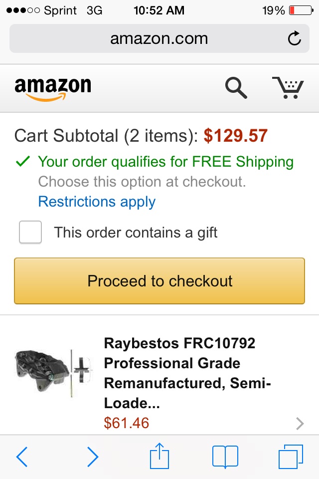

I see I can get raybestos remans from
Amazon for 129 shipped for left and right vs 190 shipped for left and right from rockauto? Is amazon a bad idea?

Go ahead and get some new hard lines as well. Maybe some new soft lines too or have some Snap On flare nut wrenches on hand.
Short of using oxy/ace for some real heat, I don't know how those pins will come out.
That rust is a mechanic's nightmare. If you get remanned calipers, paint them first.

For the brake lines, if your rubber lines are cracking, then you should probably replace them too, but definitely be careful with the hard lines. They get bent and strained easily when you service your brakes, so if they are rusted, then they won't be able to take the strain as much as good ones. I replaced mine when I re-did my front end.
I don't understand why they don't paint them either. I suppose it is a cost thing, but they could paint them much better and cheaper than we can. I have actually had some individual calipers from autozone/advance, etc. come painted, but it's a crapshoot (actually it was one of my buddy's calipers that came painted black). I cleaned and painted my calipers, but the paint didn't last very long and now they are just rusting.
or if you want to save money just rebuild those, use a grinder, dremel whatever you can to take the rust scale off then repaint them. rebuild and youre good to go.

I bought my brake parts off Amazon and had no problems. You also don't have the core charge to worry about.
Those are pretty bad but if you feel squirrely you can rebuild them. $13 for a brake rebuild kit from Toyota, $20 for some paint, and a weekend with no 4Runner.
