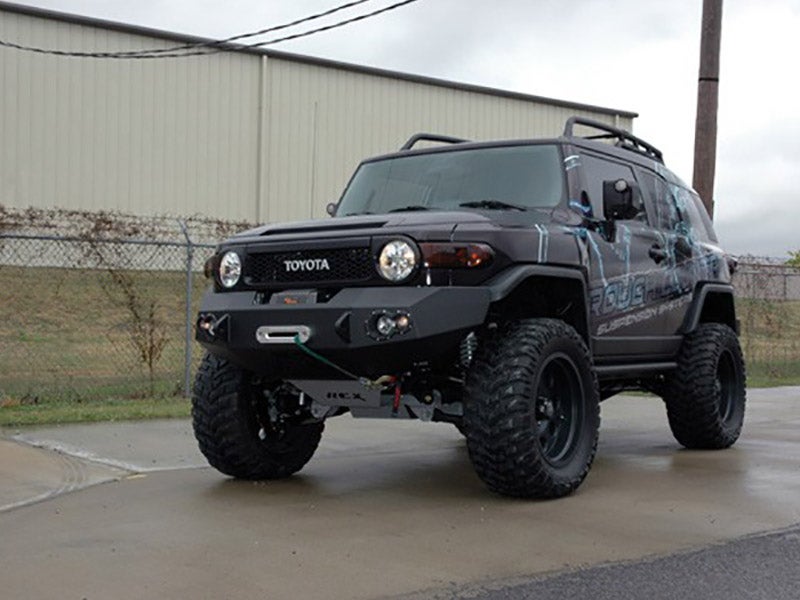

There's a significant difference between this type of a setup where it's really a 3" bracket and 3" preload adjustment to get you to 6 total inches and a 6" bracket drop like this one:
As compared to this:
In terms of off-road performance, I think there's a good argument to be made that outside of rock crawling duty a 3" lift with drop brackets and better geometry along with 35" tires would perform better than most 3" suspension preload lifts that are the standard.

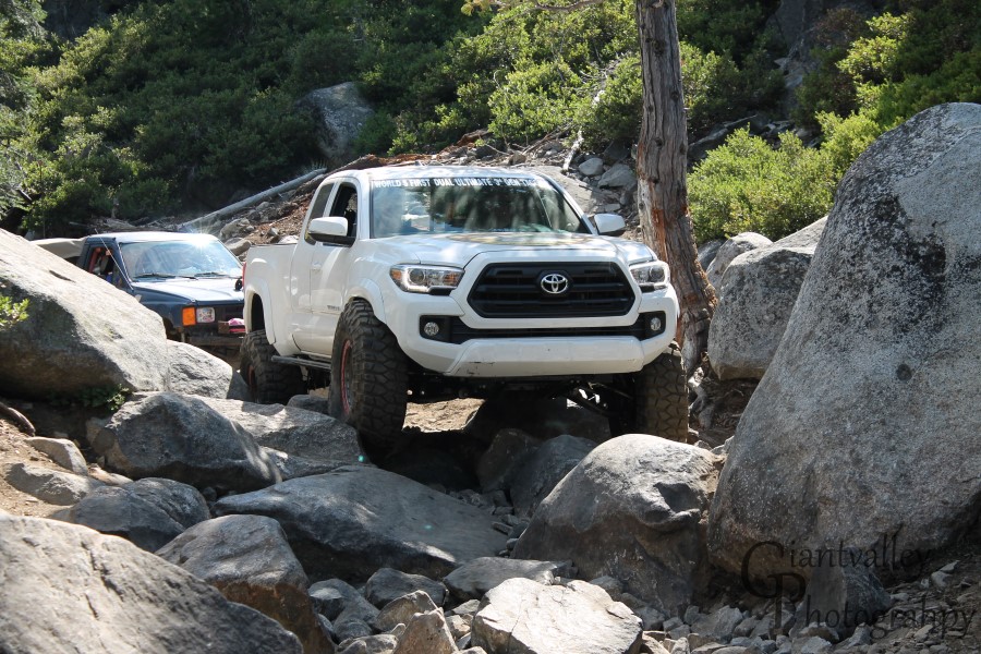

However, long travel is probably the ideal setup for most offroad use. And in the rocks - more clearance is usually a bit benefit. You can see how much more clearance you get in this Tacoma with long travel arms. And it has a lot more travel. But it's also a bit more $. ~ $2500-3k for the front control arms, plus axles, plus some solution for the rear.
