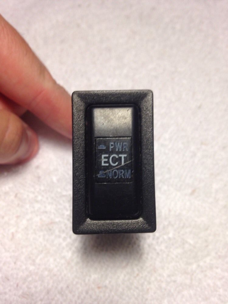

I'm doing this mod cuz my new Kenwood head doesn't retract the antennae when playing USB sources. I'm using a ECT on/off switch as they are cheaper than the custom or factory replacements - $12 off eBay. I found one on eBay with the plug after I bought one without.
Here's one without the plug for $10:
99 00 98 96 97 Toyota 4 Runner Power ect Norm Switch | eBay
Will be connecting the two antennae plugs via a splitter/adapter when I go back into the dash - didn't know there's an antennae in the rear glass - pretty cool. Will also run some RCA plugs for a subwoofer if I ever get the desire.

I grabbed a switch out of the junkyard. Any on/off toyota switch will do.
Dual voltmeter---Back window
KC roof lights----Antenna
If I remove the 'ECT' from the switch it could even sort of refer to the antenna. :D
