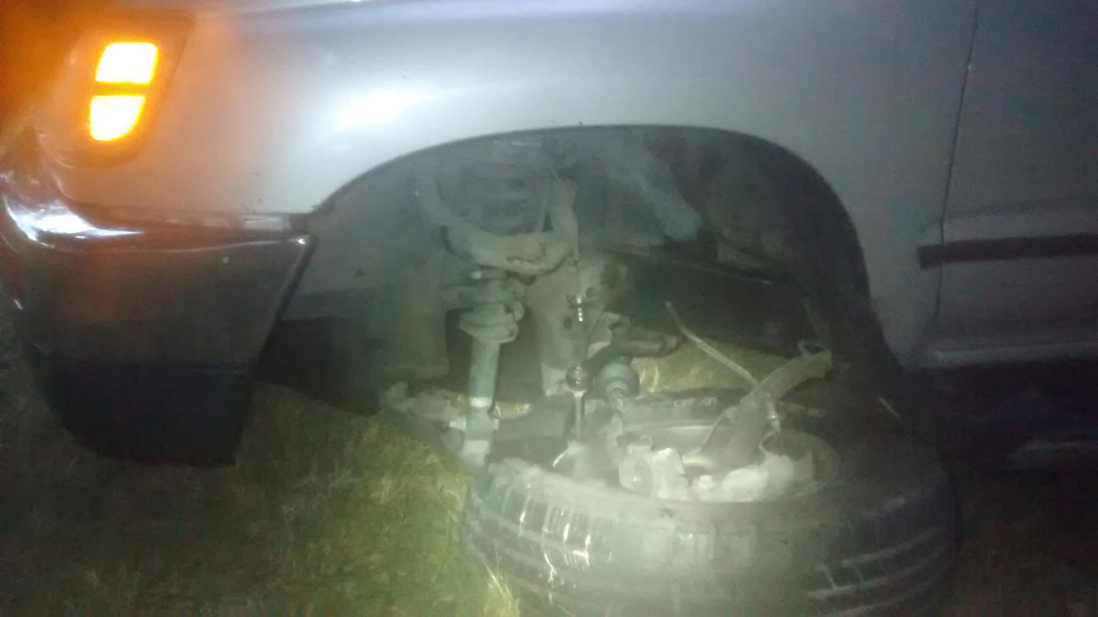

The ball joint failed on the 1997 3rd gen 4Runner I picked up a couple of weeks ago. It has about 180,00 miles on it.
What all might I need to do to fix this car?
Could an inspection have been done to reveal the problem so a repair could have been made to avoid a breakdown on the freeway like this?

Here's what I got:
1) Upper balljoint
2) Lower balljoint
3) CV Axle
4) End link
5) Brake line(s)
6) Rim
6) Maybe Lower Control Arm
7) Maybe the knuckle
Suggest you use search feature in 3rd gen section and there are current multi page threads on this subject. Also, Google 3rd gen 4runner+LBJ failure for tons of relevant hits.

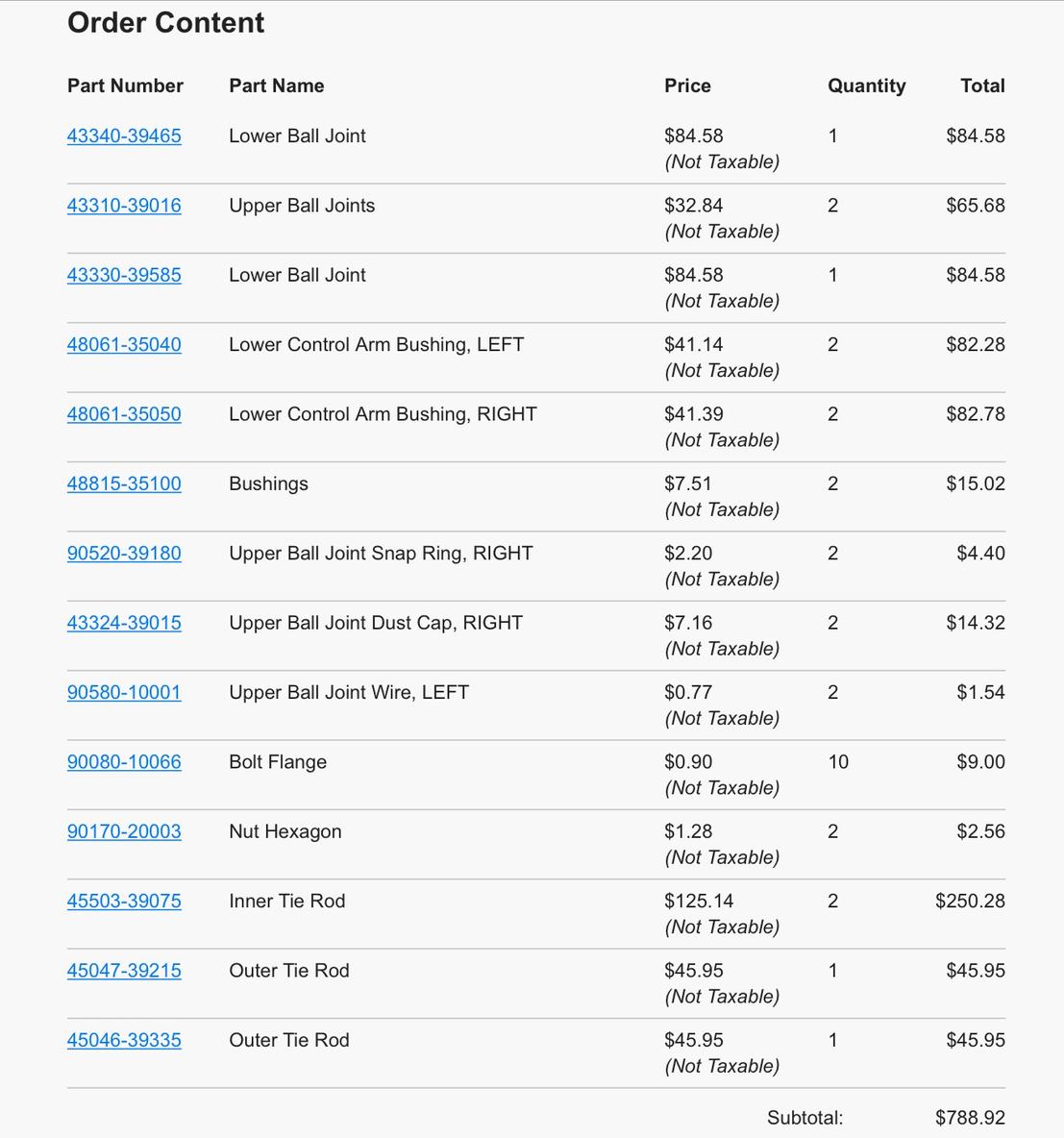

I'm in the process of ordering parts to prevent this scenario. Can anyone suggest anything I've missed here:

OEM only for the LBJ. Everyone will agree. Camelback Toyota always has good prices. So does Dallas of Toyota.
Parts.CamelbackToyota.com
The ball joints I had got from the dealer had the wire, snap ring, dust cap, etc included. Do you know what you are in for replacing the bushings?
Haha, yes I've read all about the "sizzle" to listen for when changing the bushings, etc. and decided I'm not THAT much of a glutton for punishment, so I'm admittedly going to let the shop down the road handle that one (I just bring them beer afterwards, write a check, and it feels like we all win a little that way).
If the ball joints do come with the extra snap ring/dust cap/ wire, I'll probably have an extra set for sale for cheap or trade to whoever might need it; the diagram wasn't entirely clear and I had a bit of a hard tîme believing that Toyota would actually include "extras" at that price.
