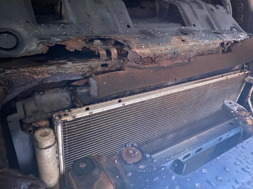

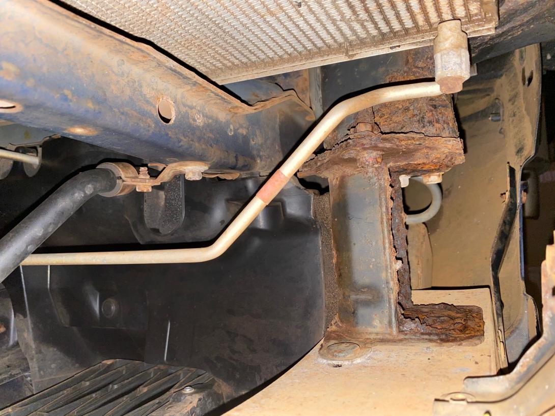

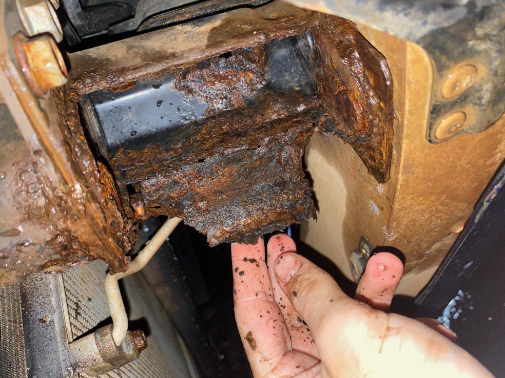

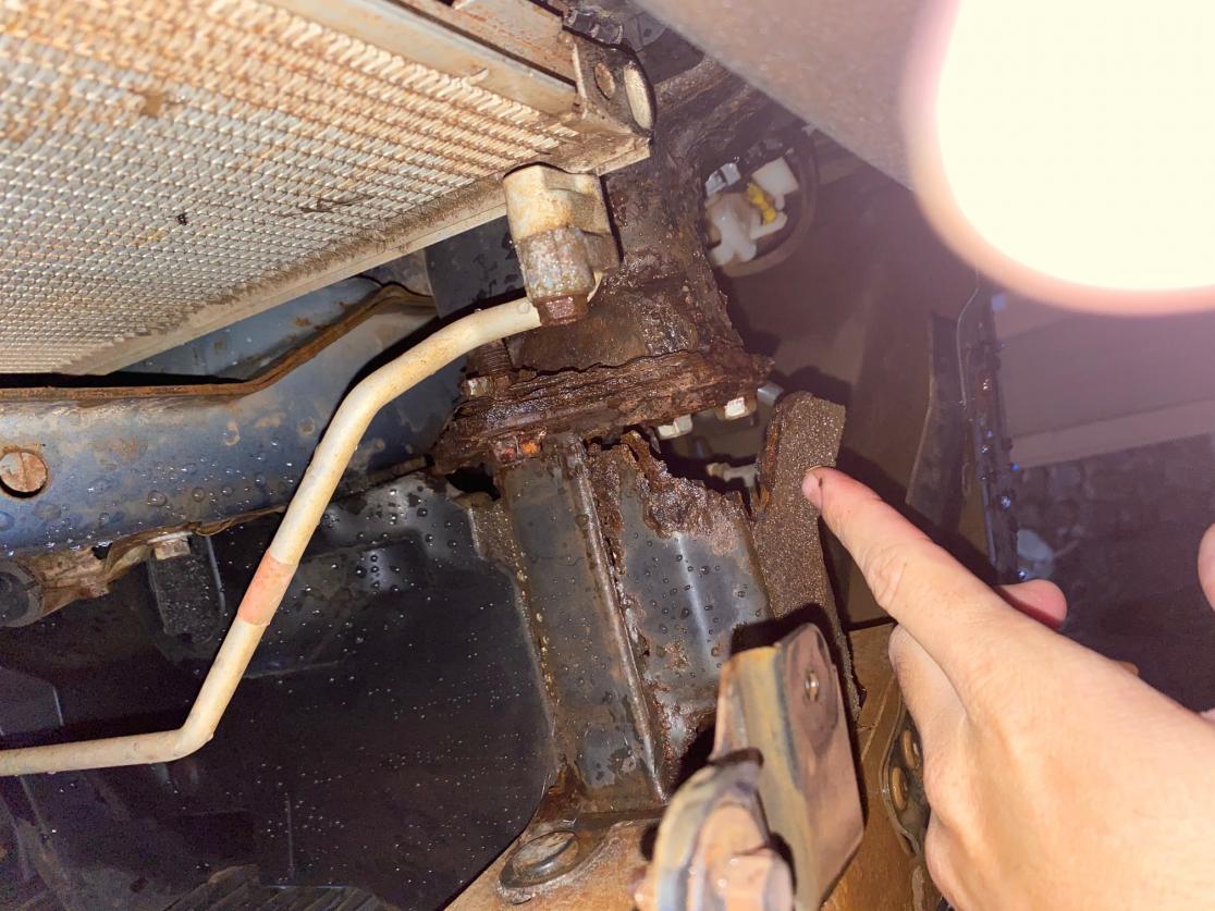

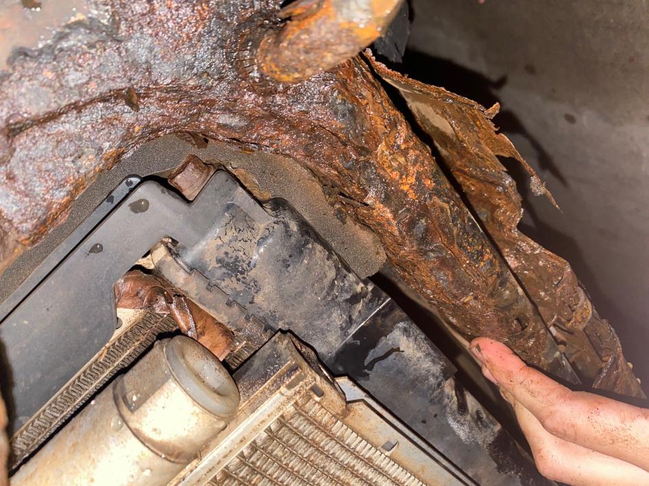

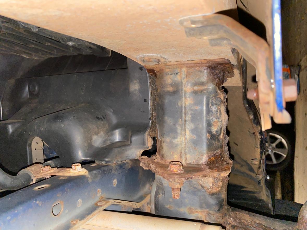

I recently installed a TRD front valence and that caused me to discover this excessive amount of rust.

Did you buy new? It has a lot of hallmarks of a crash that was rebuilt with aftermarket parts. You can see how bad the rust is on the parts that might have been replaced compared to the ones right next to them.
It does look really bad. Not sure if I'd go as a total loss yet, but you're getting close in my book.
No, its a 2014 I bought about a month ago... Didn't notice the rust until putting on the front valence. Have you taken a look at your 4runner lately?
I highly doubt the parts were replaced. The bumper support that looks mostly intact is pretty bad as well, I pushed a screw driver through it easily.
The bumper supports have the same foam covering the holes that would allow them to breath/drain.
