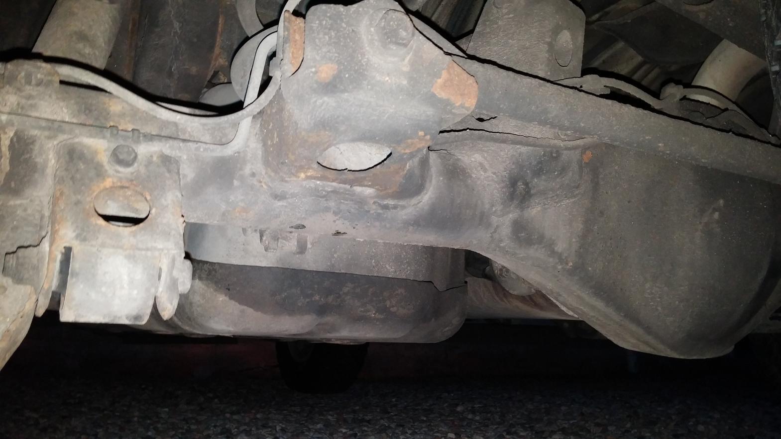

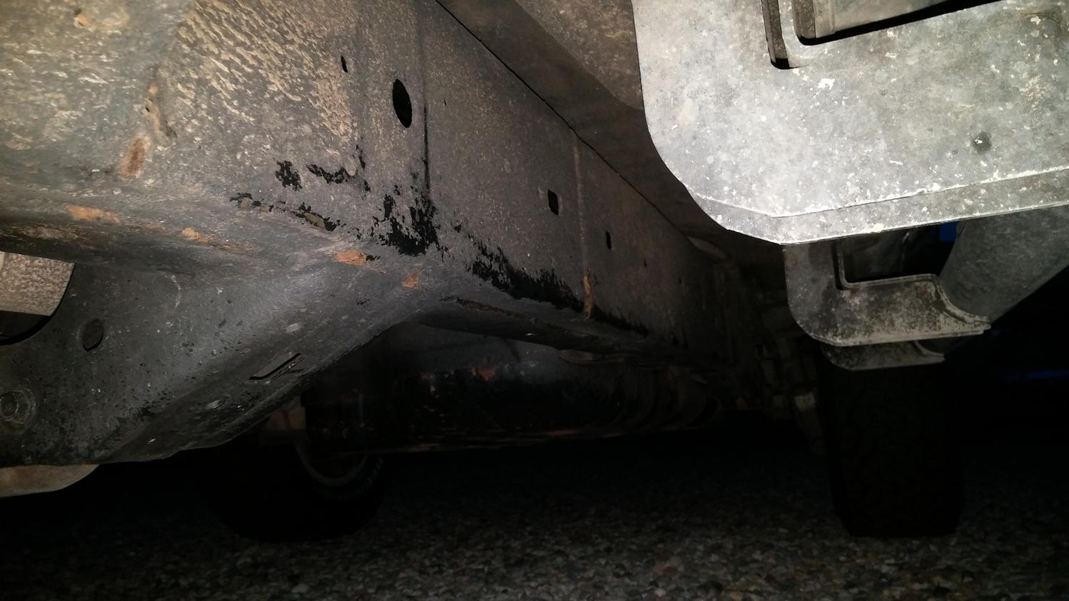

What type of undercoating? Do you know if it is rubberized? Petroleum based? Mine has some rust underneath too and was always undercoated with fluid film/petroleum based undercoatings. Here is an image as to what it looks like. Images are huge but don't want to shrink them so you get a rough idea. Not the best shots but this is with 140k and 8 Buffalo, NY winters. I know it sounds silly, but if it has a tow hitch in the rear, you can get a pretty good idea what the frame looks like based on that alone. If the tow hitch wasn't resprayed and it is covered in rust, frame probably doesn't look any better. At least, that was what I observed at the 10+ 4runners I looked at.
Edit: Just to add to this... This 4Runner is exceptionally clean compared to the others I looked at when I bought it (3 years ago in Buffalo, when I lived there). There was an 08 with 56k I looked at that was solid orange underneath from rust.
