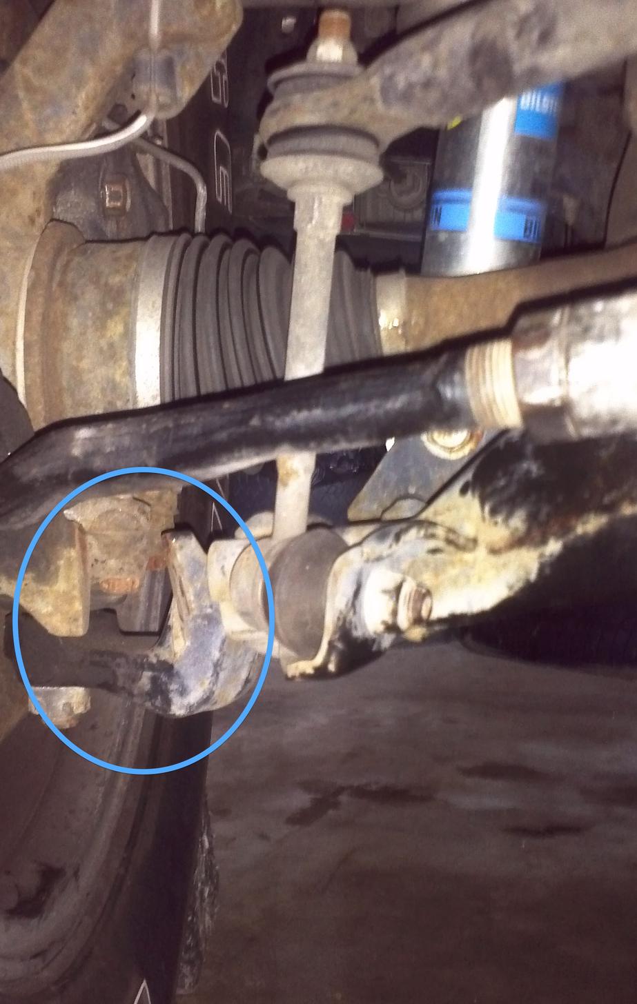

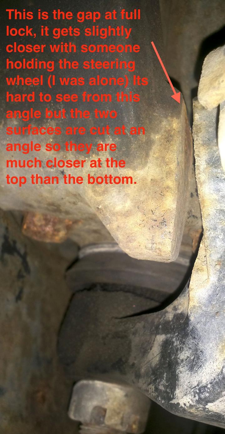

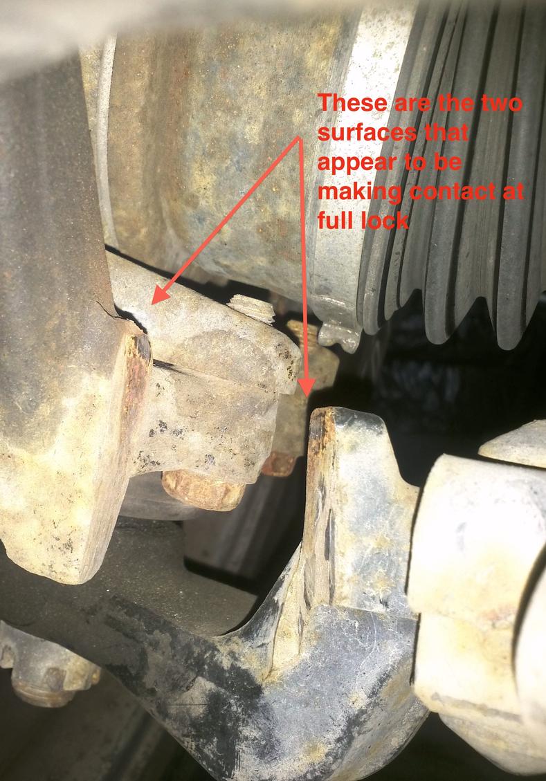

Thanks ShootMyMime! I think you are correct. Its odd I have put about 80k miles on my 4runner and never experienced this. I guess with the lift and finally having it correctly aligned it changed the angles and brought them closer. I couldnt replicate the noise in the garage but at full lock they are very close I'd say 1mm. I took a picture, I am on my cell phone right now but will post the pictures when I get home.

Hi below are the pictures I took. I apologize they are crapy cell phone pictures with flash. I hope this clearly shows the issue.
I believe this is what [MENTION=14772]shootmymime[/MENTION] and [MENTION=86948]mikebontoft[/MENTION] were describing as the possible culprit of the noise. I am going to paint the surfaces white at some point tomorrow or the day after and then try and replicate the sound and see if they made contact just to be 100%. The shiny area of the two faces in the second picture does show they made contact recently.

OK. not what I was thinking of, but mine is different anyway. It does appear though to have made contact and either way, metal on metal will make that noise.
It also appears that the more you adjust the tie rod sleeve, the closer that part of the knuckle will get to the lower ball joint at full lock. I think I'm looking at it from the back to the front, which means your tech had to have adjusted the toe out some. (likely showing negative toe-in)
Do you know what it was set at? I'd have them set toe-in at .02 on both sides as long as it means toe will become more positive (toe-in) than it currently is. Generally you set toe-in just a bit on RWD vehicles as it will come to zero when the vehicle is loaded during driving (front end picks up some and the wheels pull out a bit).
yep thats exactly what i am talking about. although your alignment specs are spot on, they would have had to adjust the outer tie rod to adjust the toe, that could change the gap between those bump stops for the steering.
