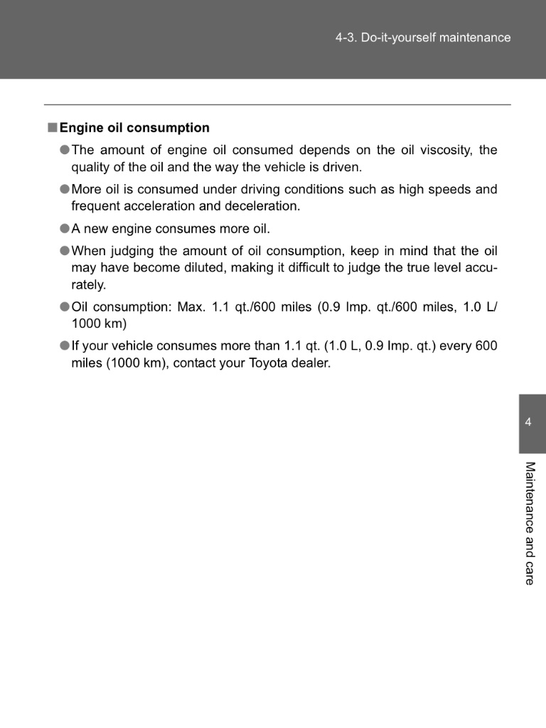

Exactly! There is no difference.
If we want to trust the engineers who supposedly wrote the manual, then I guess it's ok to consume a quart of oil every 600 miles, right?

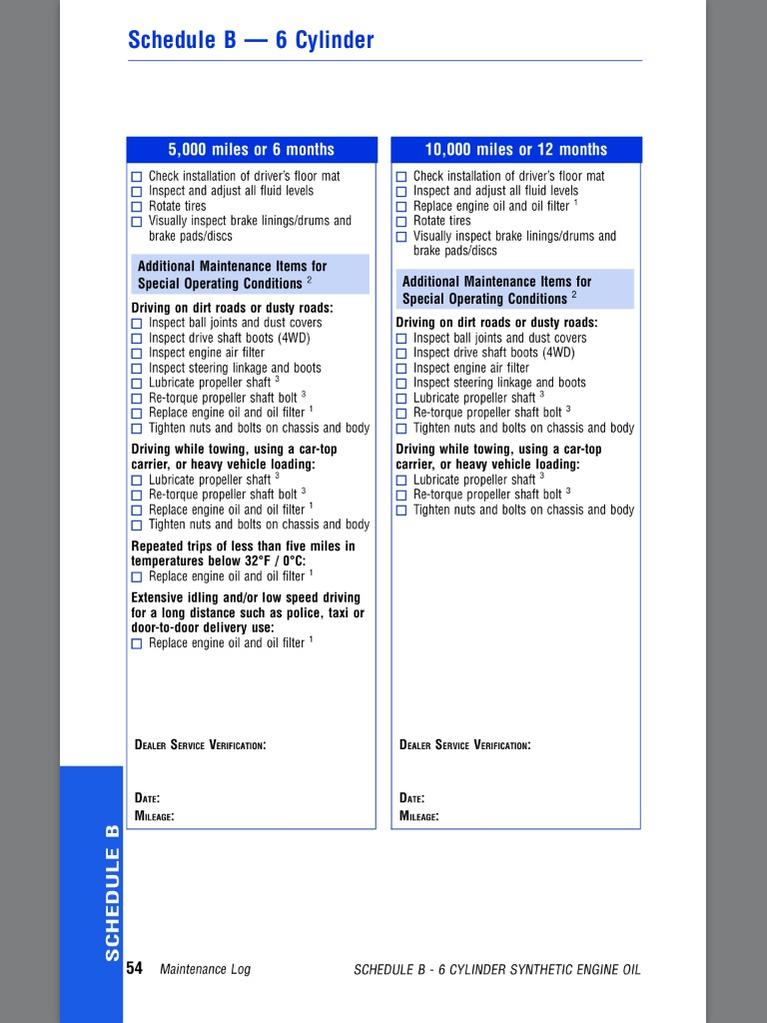

From the 2010 maintenance supplement.
Ok so your manual for a 2010 does not say change at 5k, it says change oil at 10k and it says that motor uses synthetic oil.
It only says change at 5k under "special operating conditions", which generally means frequent towing or other harder conditions.
But i'm sure if you go back far enough someone can find out what year they started using synthetic; that's when the 10k mile interval started.
