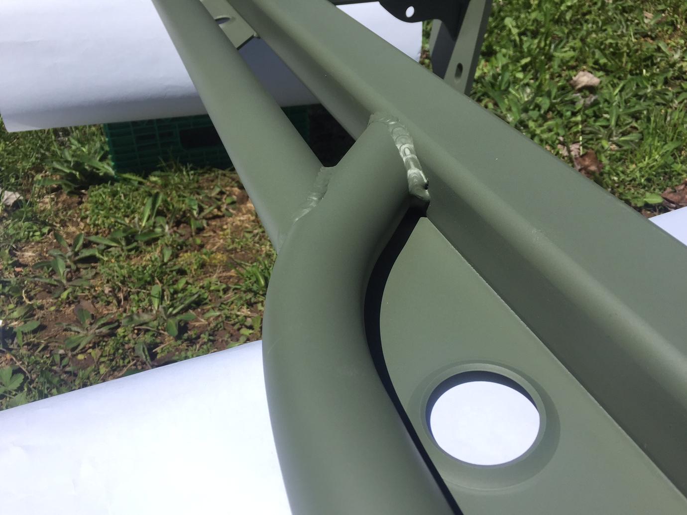

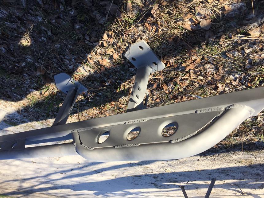

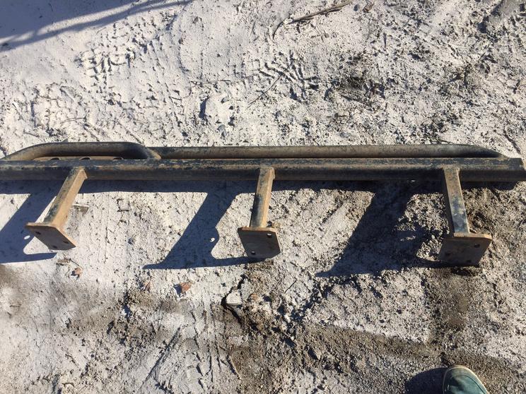

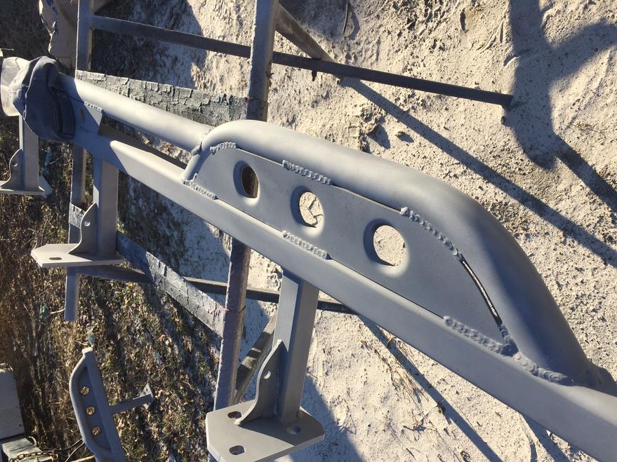

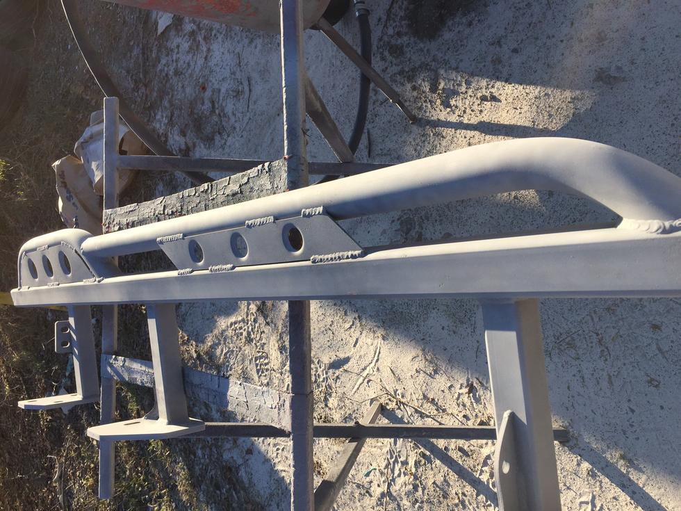

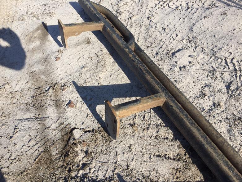

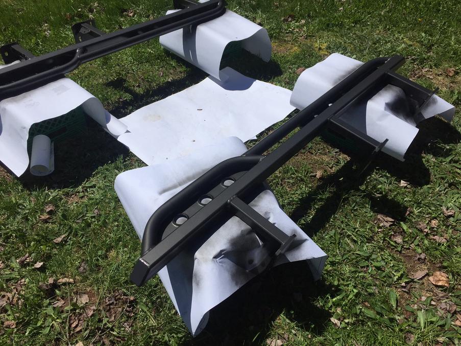

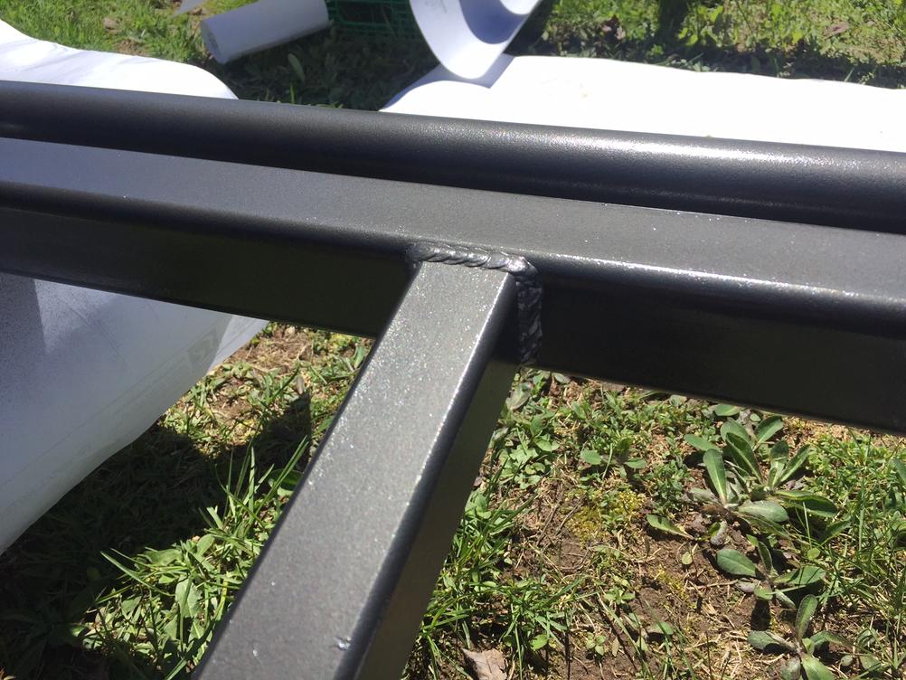

here's some sliders that some would consider badly rusted.
I took them off after 2 years and sandblasted them and repainted them.
This is a great example of surface rust.
