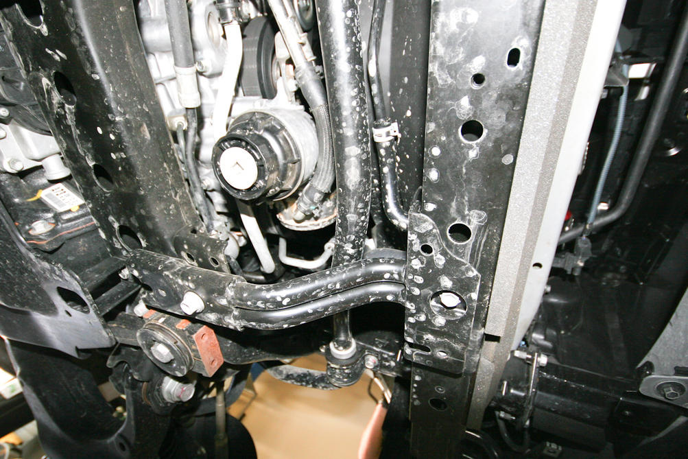

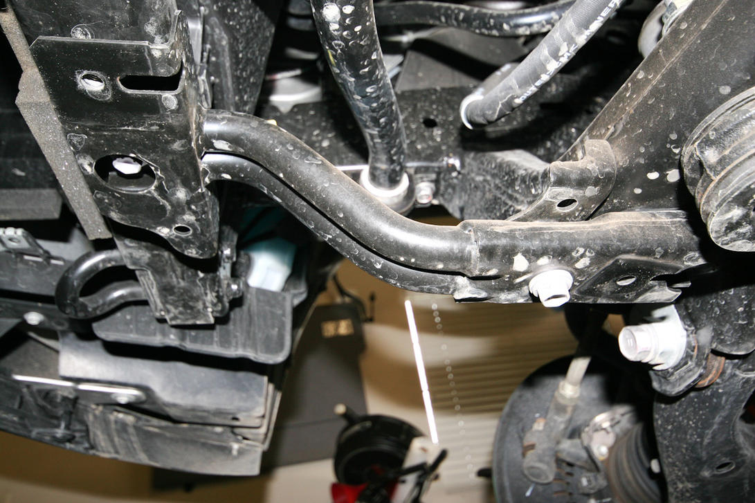

Seemingly, the 2010 models are "fixed" but only time will tell....
Here are pictures of the extra reinforcements on 5th gen 4runner and 2010-up FJ:
