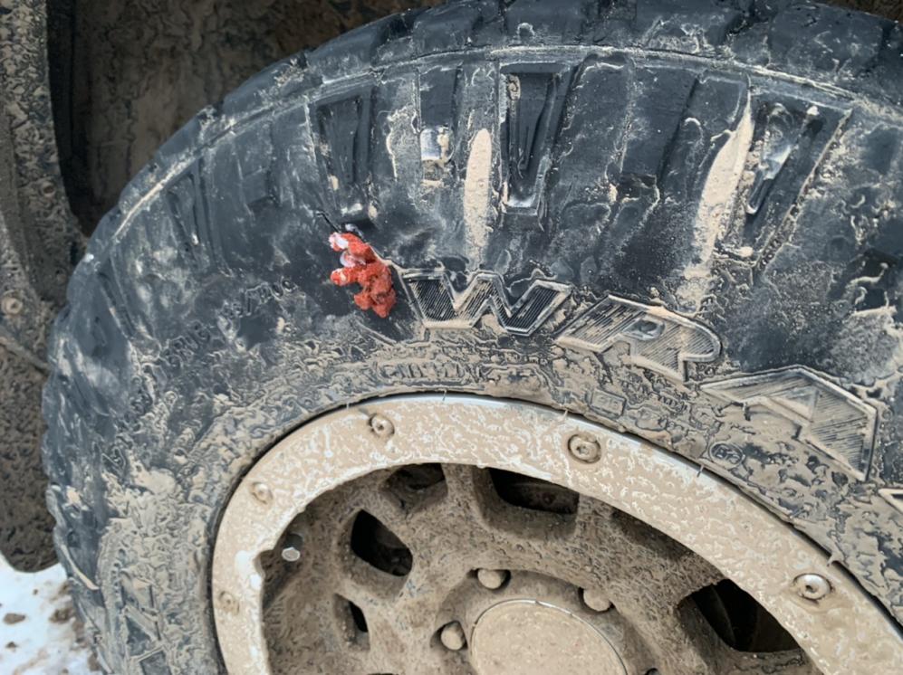

I got a $20 Amazon special with metal handles works greet. I run a spare just to be safe. I’ve plugged some big holes to get home!
Lol wow. Plugged the side wall eh? Impressive.
Sometimes you have to do what you have to do to get home... I do hope that you changed that thing out as soon as possible though; I have had some customers who run those types of repairs for years. It genuinely worries me when I see that, not because it will always blow out; but because my brain is already calculating the adjustment of risk and protentional of failure. lol
