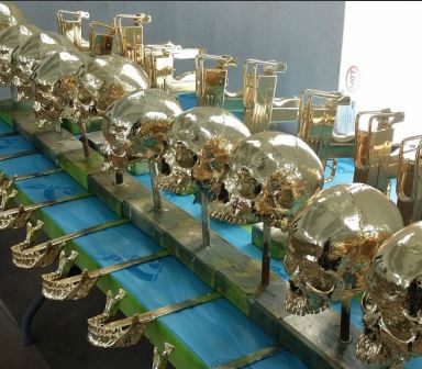

I wonder if Future Chrome can apply a black chrome finish to the “4Runner” on my tailgate. Nice looking stuff. And I have always thought about chroming my collection of skulls.
