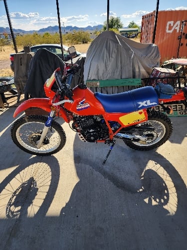

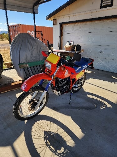

Picked up a 1985 Honda XL600R. It's in fantastic shape, and it's a beast.
I have 2 adult kids that want me to teach how to ride a motorcycle. I prefer "dual sports" for this and damage is less than a road bike when it is dropped.
And after moving back to AZ the MVD wants another skills test. That would entail a lot of work on my road bikes.
It's a bit larger than I'd like for teaching but the power is easily controllable.
It's kick-start only so a 600cc single cylinder is a challenge and demands respect. Kick-back can hurt you.

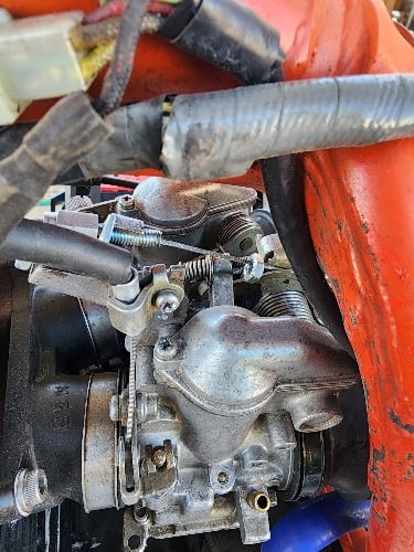

This one also has an issue I need to address before regular use. It will suddenly rev to redline for no reason that I can discern. Haven't delved into it yet.

Figured out what was causing the spontaneous revving, nut on the throttle cable came loose and would get stuck in the cam on the carburetor.
Now to learn to start it when I want, not when the bike feels like starting.
