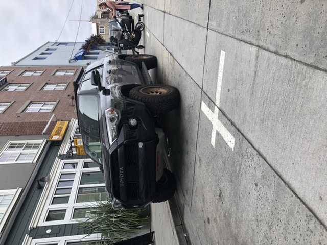

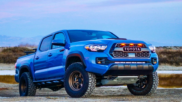

I have te37 on my tacoma and scs on my 4runner. Te37 added bonus is how much lighter they are, which offset the increased tire weight from going bigger and more aggressive. They scs ray10s on the 4runner weigh a full 10lbs more each, but i have evwry confidence they are plenty strong. A lot of the scs have fake beadlocks, bonus being the rings can be replaced very easily if you do mess them up off road.
