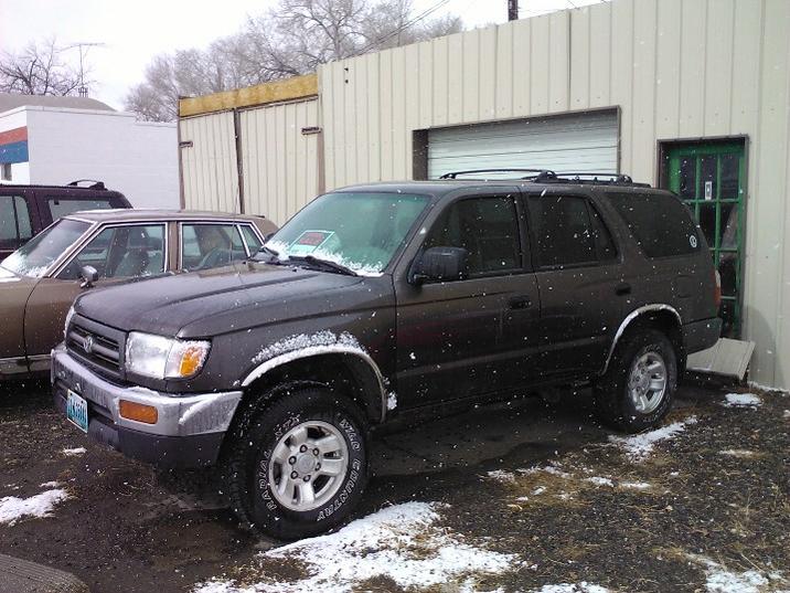

Today, I found an Anthracite Metallic 1997 Base for sale locally. I'd like to get this for my little brother - he might be my first convert :D
EDIT: I thought it was a base, but then COB reminded me that the 2.7L/V4 doesn't come in the SR5 trim.
Here's what I know about it:
  • 1997 Base
  • Anthracite Metallic
  • 5-speed manual
  • 2.7L & 4 cylinder
  • Almost no rust underneath (some VERY light surface rust on some parts, but almost the entire undercarriage seems to show original paint and no rust.
  • Body seems really good, no dents or anything obvious to a quick glance. I know there looks like a dent in the front corner in the picture, but that is the street and snow).
  • 195,600 miles
  • 4WD
  • Aftermarket stereo, though I forgot to look in the back for subs. None of that really matters though, to me anyhow.
The guy is asking $3,250. This seems high, even the KBB prices don't come up that high, unless it is in MINT condition. The interior seems clean and really nice. Tan interior.
Questions:
  • Any concerns with the 3RZ-FE 2.7L/ V4 engine? (as opposed to the 3.4L V6 5VZ-FE)
  • I know miles aren't a huge issue for these 4Runners - not really any concerns there
  • Timing belt doesn't need work, since the these engines use a chain, right?
  • Is it really worth this price? NADA lists for around $2.8K...
Still need to test drive, will probably do that on Tuesday when we're back in town.
Picture! (my picture, with my Quantum, it's snowing again here)

Its really hard to tell from pictures, but it looks to me as though it may have been in a front end collision.
The front fenders seem to be a slightly darker shade of Anthracite that together with the front bumper being chrome (I believe all the 4 bangers had grey bumpers) it also doesn't match the grey grill and rear bumper. I would give it a close look for hidden damage to the radiator support/bumper mounts.
As everyone else has said the 3rz's are very solid and that could be a great find. Although the price would be good here in california I would also recommend offering him something closer to 2700.

Thanks for the reply, Yoter! I can't quite tell in the pictures whether or not it matches, I will have to look really closely next time I see it in person. I can't remember (I had very little time to look at it at the time) if the rear bumper was chrome or grey, but the photo seems to reflect grey. I'll definitely be looking it over with a fine toothed comb. There are no leaks or anything like that underneath, its quite clean.

Some updates, called the guy today.
Turns out... it was a driver's side deer collision. So the bumper is from a junkyard, it has replacement fender, hood, radiator, as well as the aforementioned bumper. Explains why the corner lights and the headlight doesn't match up perfectly.
It also had it's tumbler replaced, so different keys for entry and starting.
Branded title... and gets 25 MPG.

4.56 gear ratio. This was the lowest gear ratio offered on 3rd gens and it only came on 4 cylinder 3rd gens( also extremely rare to find). Judging by the picture you posted, that looks like the premium base model and that's usually what they came in so I'd definitely check that out. If it still has the 265/70's on, when you test drive it, it should be revving at 3000 when going 70. I can honestly say though my favorite thing about this motor is that you can regear super low. 35's and 5.29's for this motor and you still get stock rpms on the freeway.

Not all 4 bangers had grey bumpers. Mine was chrome, I've seen a few chrome actually. Not modded either just stock. You see them more on Desert Dune Metallic 4 bangers
