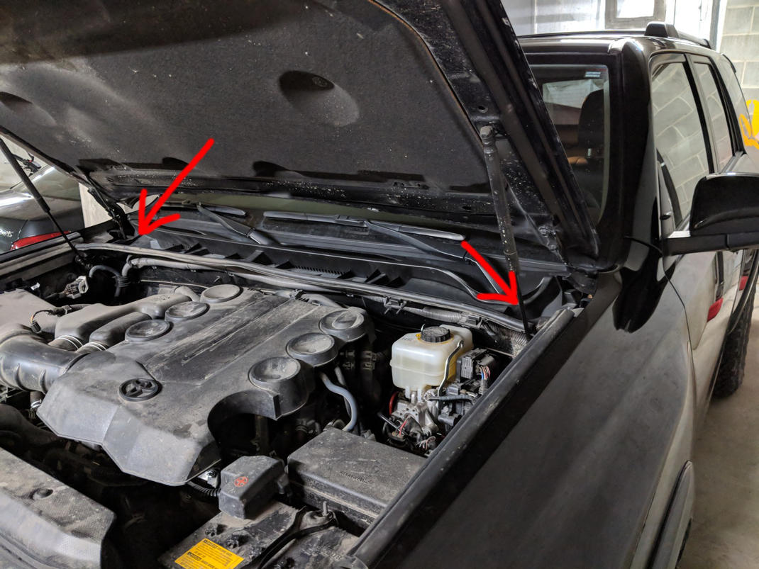

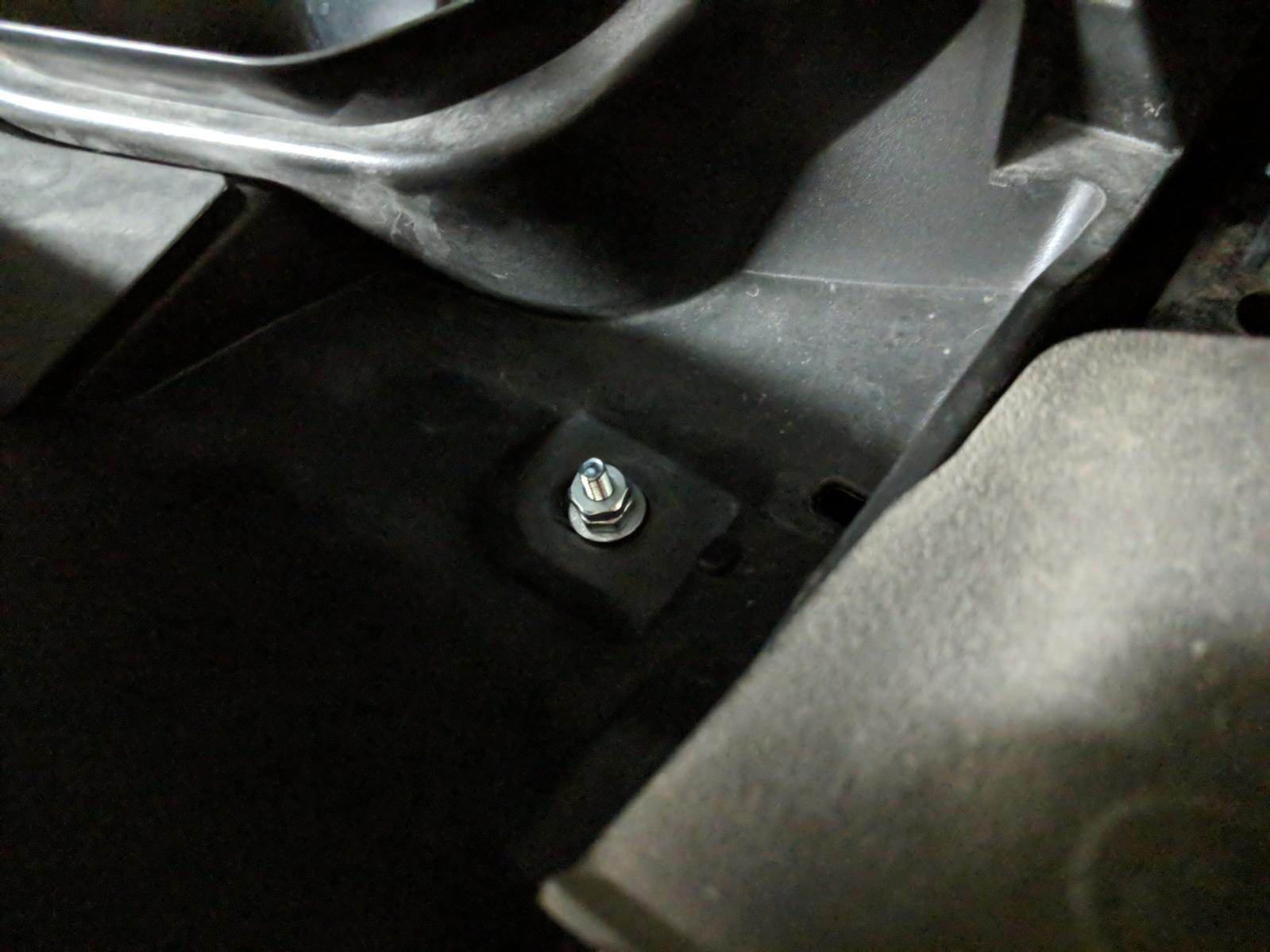

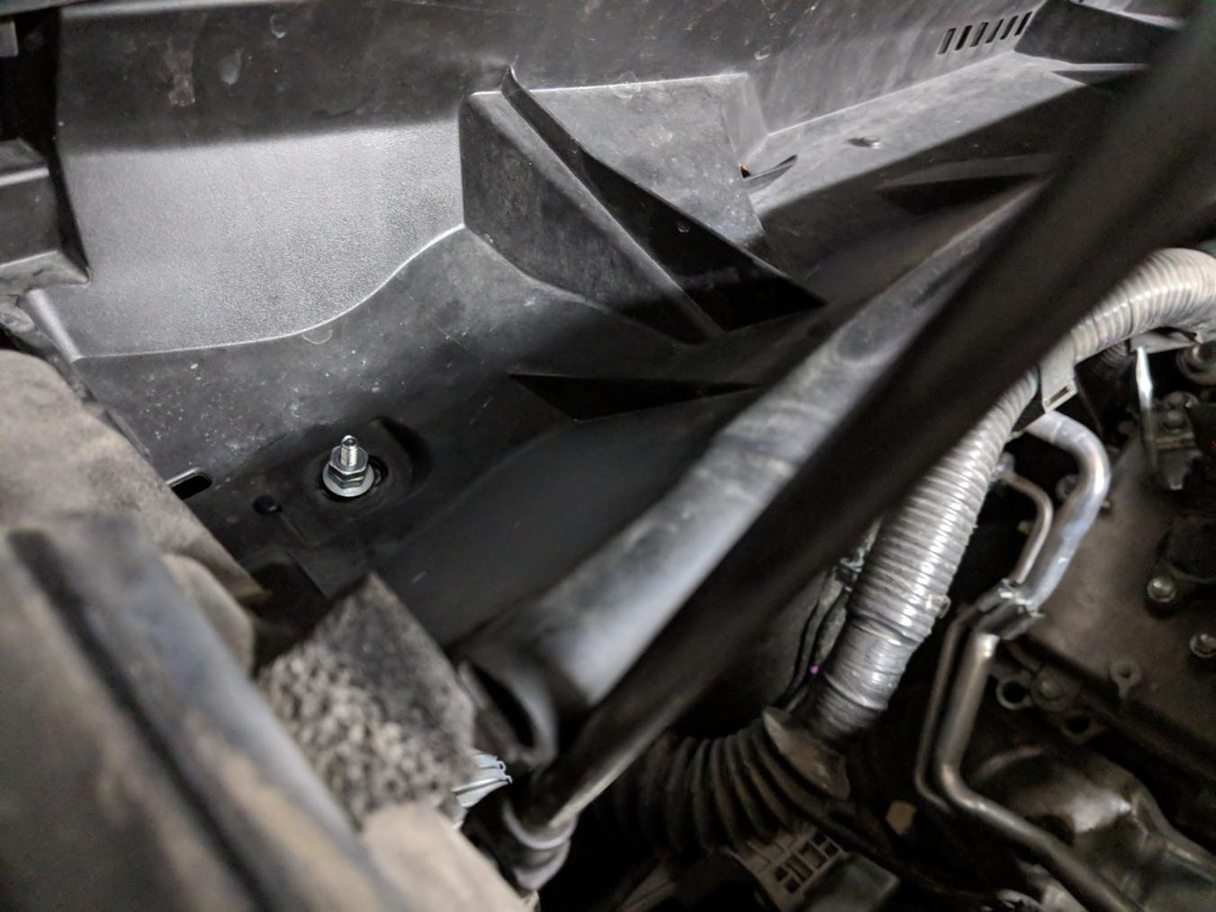

So I've been trying to find and fix this rattle that's been poisoning my life on and off for 2 years now. Loud intermittent plastic-y noise that sounds like it's coming from within the dash someplace. Had the dealership look into it, they took the dash apart twice, could never find it. Tried pretty much everything, except looking into the engine bay. This is it.
There are two stupid little plastic pins where the arrows are, of the cheapest kind possible, that hold the upper plastic thingy attached to the frame. They are extremely flimsy and make the whole thing vibrate and move about. I took them out and replaced with something a little more sturdy. Quiet as a mouse ever since.
Hope this helps someone avoid the anguish.
