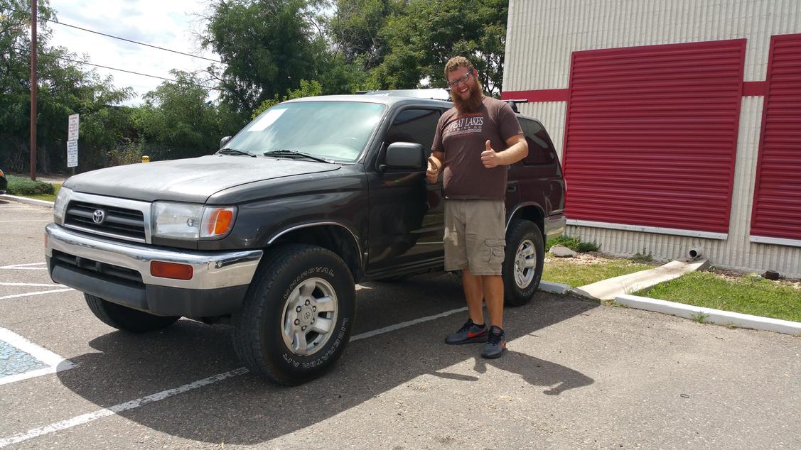

This is my first post on the forums, and I'd like to introduce everyone to my new (to me) 4Runner, Francesca (Franny for short). She's a 1997 4Runner SR5 with the 5 speed manual and the 3.4l V6. She has 205k miles but runs and drives like brand new.
This is my first Toyota, and after my last car was stolen 4 weeks ago, I've been researching and researching trying to find the best vehicle to buy. And that's when I stumbled onto this site and began my search for the elusive 5 speed 4Runner.
I only have 1 picture right now, but will be updating this thread with more, once she is out of the shop from her checkup.
Thanks everyone for reading, and thanks for such an informative forum for all my 4Runner needs!

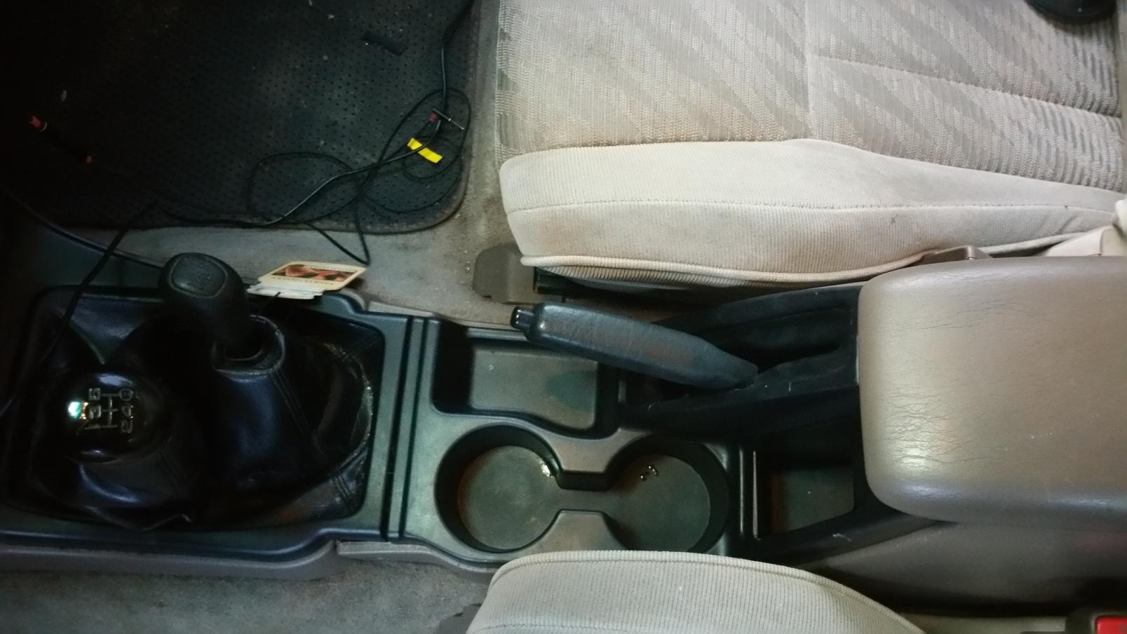

So I had to order a few parts for her such as a new back window switch, a passenger door control module panel, and I had to change the center console because the lid was broke, and all tore up. I decided to get a '99 console and do the upgrade for the better cupholders. Turned out awesome! And thanks to [MENTION=44831]JohnsD90[/MENTION] for the write up for it!

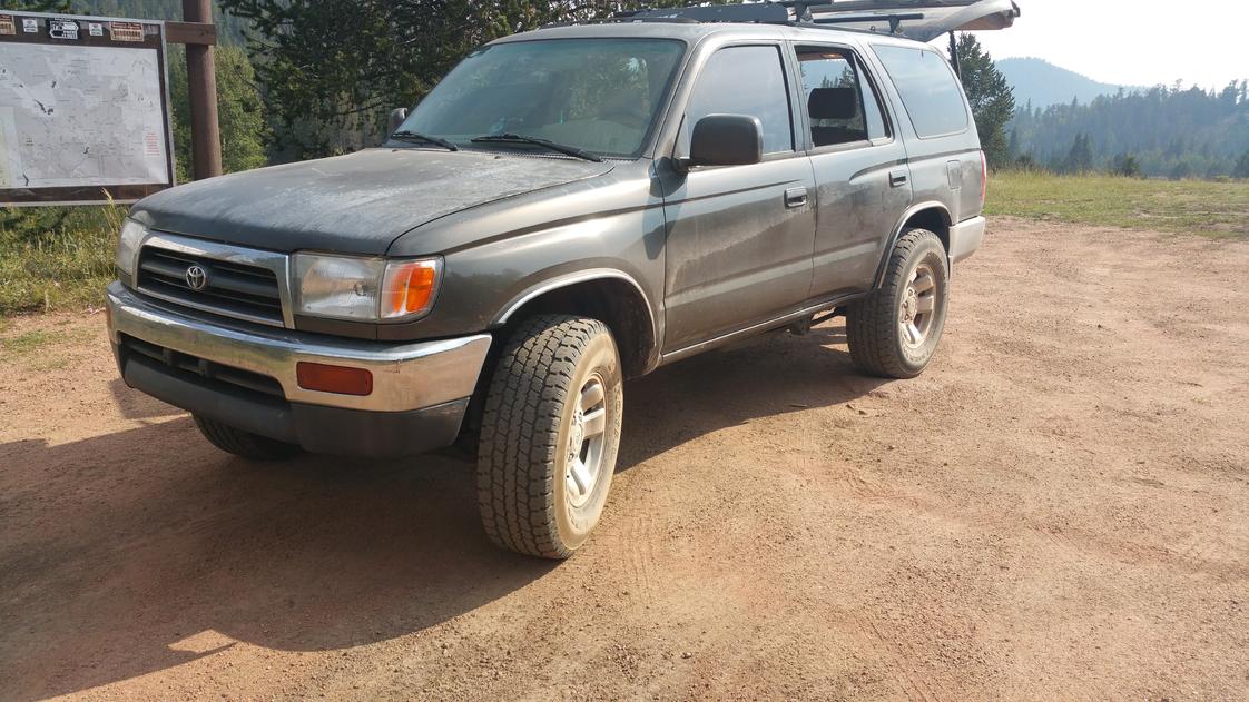

Also we went dirt roading up in the mountains today and she handled great. Handled anything we did.

Wow, someone did the center console mod for you!
Do you know whether it got a rear e-locker : RR Diff Lock switch by the tilt?
Nope I did the center console mod by myself. Unfortunately it doesn't have the locker. But I plan to get a winch, and that should be enough to pull me out of anything that I would be doing, if need be.
