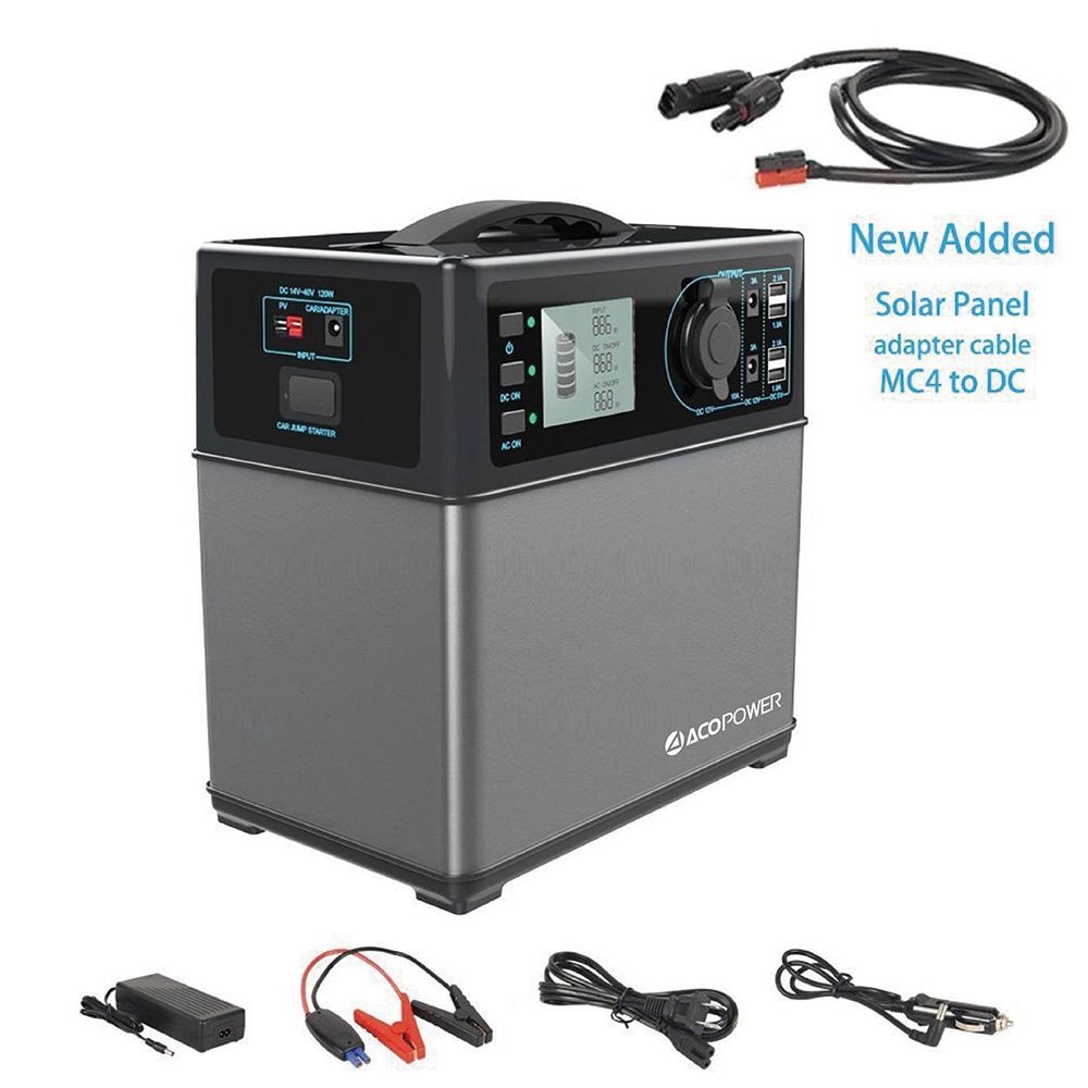

I didn't want to mess around with my truck electrical system and having everything portable seem to work ok for me. I used this setup for my CFX65, 3 3 days trips. The fridge and the 100W solar panel were plugged to the Generator all the time and no issue for 3 days. During the day, the solar panel charge the generator, the generator provide power to the fridge. At night, the generator provide power to the fridge. The flex solar panel is light and can stay on top of the awning. Quite simple, no drilling or mod or anything. I don't know how long I will keep the truck so this option fit my need.
